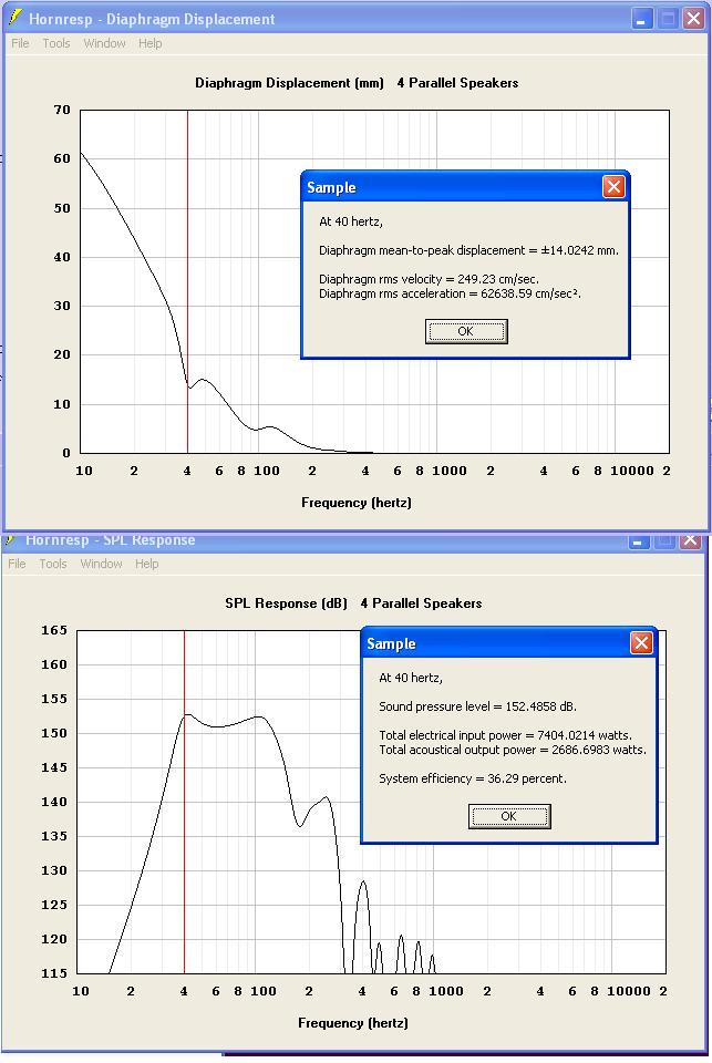

It actually models well in the SS15 cabinet (single sheet TH challenge thread)
http://www.diyaudio.com/forums/atta...challenge-2011_mar12_ss15_profile_revised.pdf
Here's 4 cabinets at 1000watts per driver, well within xmax, and achieves your spl goals.

I ran 0.5pi for 4 of these and 2.5kw and it's still within xmax at 40hz in an ss15.

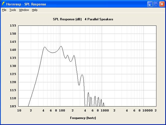

Ok guys sorry for all the post's. the MOJO's are the ones I ran in my van and have still. They are the ones with the spec's that I posted. And the ones I want to put in a Tapped Horn. and feed each one 1Kw. I'll try and find the Specs for the Holee **** 15 But to be honest they need more power then my MOJO's did.
OK here's the specs on the hole S 15
