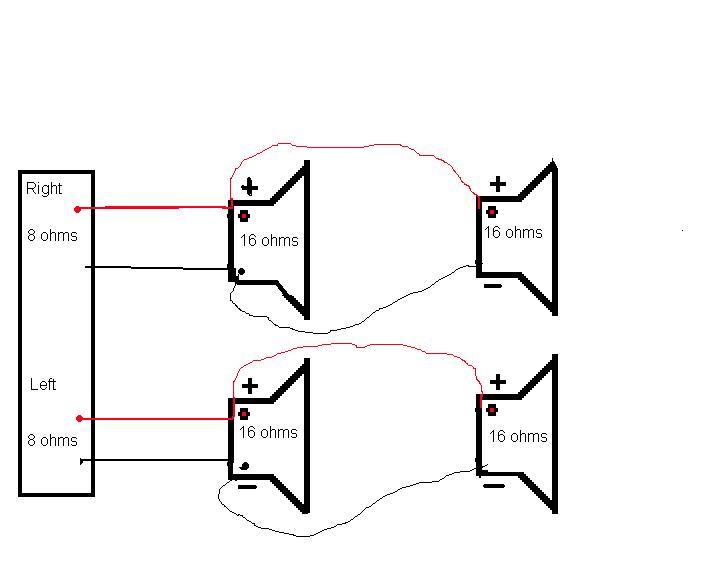

It would be better with two cabinets, but you can use one as you have planned. Do you understand how to wire it?
Bring back an old thread... That is pretty much how my cabinet is wired. Would that mean when you use all the speakers together, your getting 4 ohms?
If all the + terminals are wired together and the drivers are all 16 ohms, yes.
It's really quite straight forward, if you parallel, you divide the impedance. If you series, you add the impedances.
