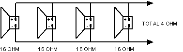

I have been to every forum on the net and this is my last resort. I have been building a 4x12 cabinet for about a week now and am about to wire in the speakers. Every other forum gives me some complicated diagram with squiggly lines and arrows on it and then gets mad when I ask them to explain it, or they go of on a tangent about impedence. I have four 12", 16 ohm speakers that I want to put in the box. First of all is there any way I can wire them to get 8 ohms of output? Second can someone please tell me (as if they were talking to the dumbest person on the planet) how to wire the darn things together step by step? You guys are my last resort. From what I have read this forum is very helpful. Work your magic. Thanks

Sorry there is no way to get 8 ohms from 4 x 16 ohm speakers and have all the speakers equally share the power.
You can wire them up for 4 ohms by connecting all the negative (black) terminals together and all the positive terminals together.
Any good amp should be able to drive into 4 ohms (check first though).

When you say "all terminals together", does that mean that two wire ends will be soldered to the same terminal throughout the case? Sorry, but I did say I was the dumbest person on the planet when it came to wiring. So if I have this right it would go like this. Connect a wire to the pos terminal on the output jack, send that wire to the pos on the first speaker, solder a second wire to the pos on the first speaker and send it to the second speaker in the parallel, and so on until all four speakers are connected (so there would be more than one wire soldered to the same terminal, right?) Then do the same thing with the neg side. Is that correct?
mytool4u said:When you say "all terminals together", does that mean that two wire ends will be soldered to the same terminal throughout the case? Sorry, but I did say I was the dumbest person on the planet when it came to wiring. So if I have this right it would go like this. Connect a wire to the pos terminal on the output jack, send that wire to the pos on the first speaker, solder a second wire to the pos on the first speaker and send it to the second speaker in the parallel, and so on until all four speakers are connected (so there would be more than one wire soldered to the same terminal, right?) Then do the same thing with the neg side. Is that correct?

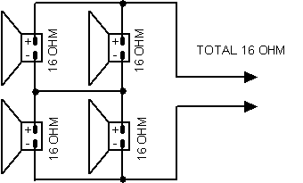

Brion55 said:This might help:

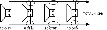

mytool4u said:That diagram shows the parallel connection, but how are the connections that I have circled in your diagram made? Are they just spliced together?
All correct. You can use the speaker terminals as the commoning point or you can wire back to a central connectin point. If I were you I would just wire directly to the speaker termnal point. This means that all speakers will have 2 wires per terminal except for one (the last one).

You could get 8ohms, but not by any combination of wiring all four together. You could wire two together in parallel (negatives tied together, positives tied together) and the other two in parallel, and then connect them to two separate amplifiers. But, it looks like you only want to use one amplifier, in which case, if you can find a way to wire them to get 8ohms, Georg Ohm would love to see it. So, you have these options:
1 amp:
16 ohms
4 ohms
6.4 ohms (amplifier sees that load, but subs will be unequally powered)
2 amps:
8 ohms each
Good luck.
1 amp:
16 ohms
4 ohms
2 amps:
8 ohms each
Good luck.
