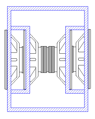

do you know how essential it is, for the drivers to be mounted aligned, on-axis?
It could be tempting to mount the drivers with an off-set, therby using the space between the front woofers' magnets to accomodate the magnets of the "hidden" woofers. Considering the depth of the structures, this could save 10cm in the depth.
I don't want the "hidden drivers" to be placed too near the rear wall of the "overall" cabinet.
As long as it's a sealed volume of air being moved my the drivers (in the isobaric chamber), alignment shouldn't be important in my imagination (?)...
Any comments?

Basically, the small the coupling chamber the better... with 4 woofers i'd mount them similar to my drawing above, which means 2 chambers.

I wasn't really clear. I intended something more like te attached. Still push-push, but as tight a space as possible (blocking the empty corners (or using PVC or an octagonal shaped coupling chamber wouldn't hurt)

Front to front will always be the best, better coupling between drivers, better thermal dissipation, closer to the simulated response...
But then, not everyone like to look at a steel basket and some might be afraid of easy damage done by people since the basket is exposed.

Yes, smaller is better. The smaller chamber has less compliance in the trapped air so that you have better coupling and the resonant structure of the coupling chamber is pushed up in frequency.

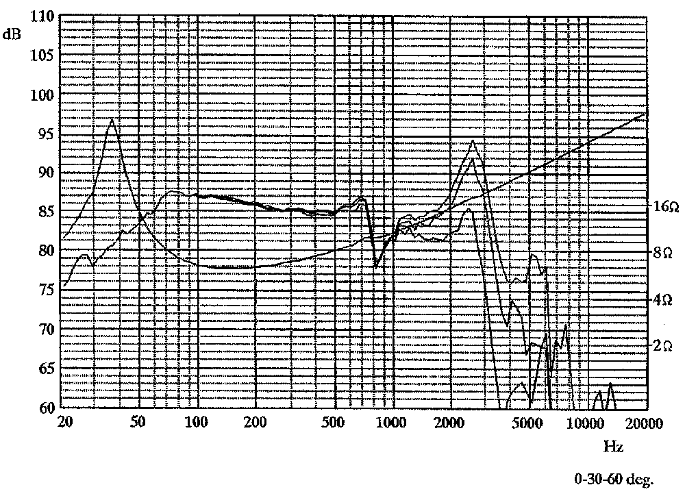

I was thinking of a 2nd order at around 250-300 Hz

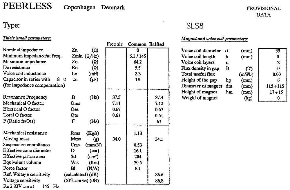

The driver is a version of thePeerless SLS213 (8") with vented magnet structure, which makes the driver 10cm from the back of the mounting ring to the bottom of the magnet structure.
I'll try to make a scan of the data sheet to attach
Jennice
EDIT:
I gave up trying to make it readable and still small enough for the DIY-audio forum server. It's on my own ftp server as a picture called SLS-8-custom-version
The FR gets pretty erratic starting about an octave & a half above that, 2nd order might not be quick enuff.
with an XO as low as you are, i don't think this would make a chamber too big.
