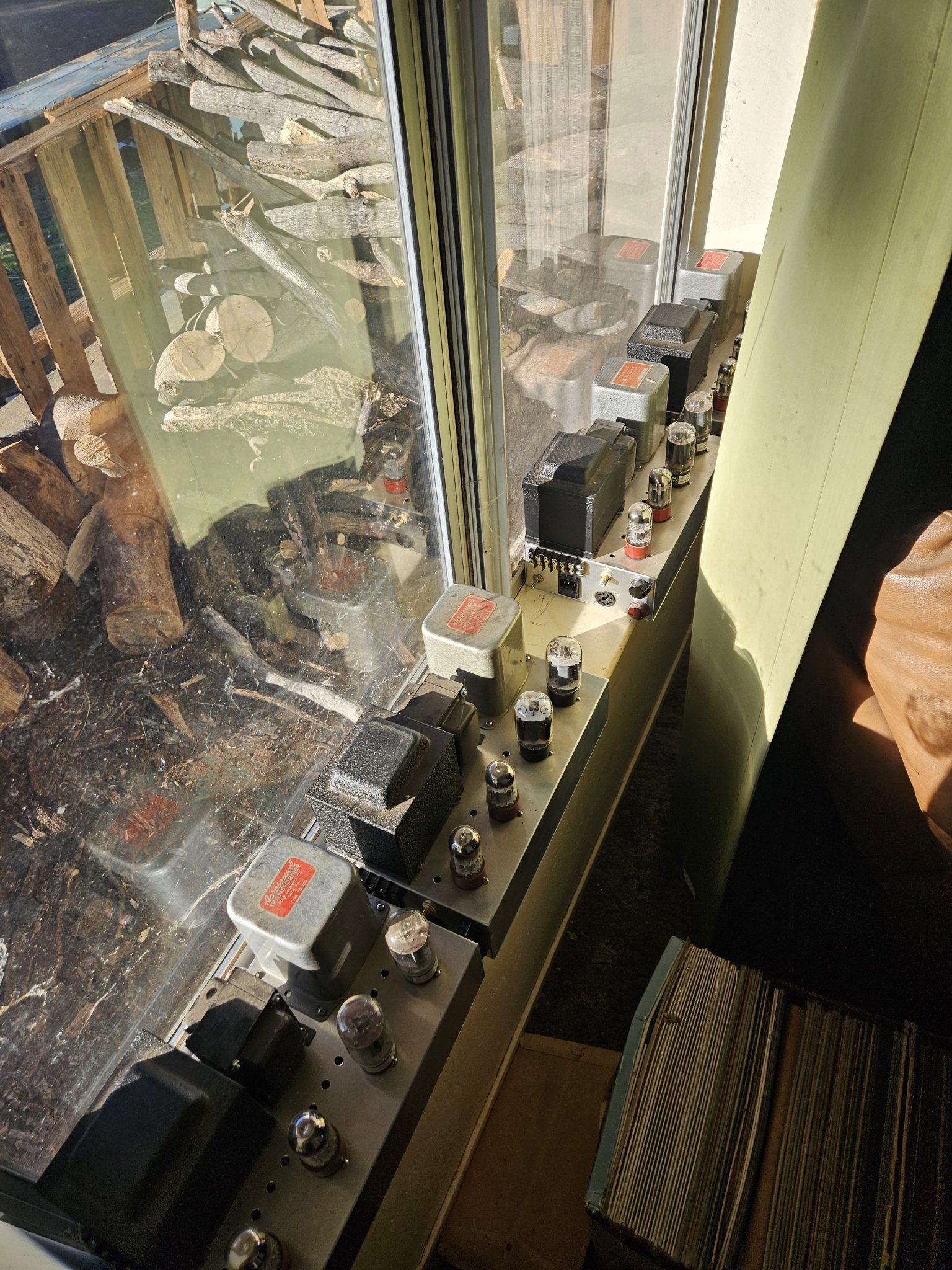

I ended up having something miswired on the gain stage and upon further work I determined that 2 of the acrosound transformers I used had open plate windings on one plate. I had to buy 2 more, but now I've got all 4 amplifiers working with 12db feedback and they sound really great. I swapped them into my home system in place of my fully restored mc30s and I didn't notice any drastic differences.
For new years eve, I took the whole rig down to the bar with 2 turntables, a mixer and a microphone and DJed into the new year using my home made 6l6 power amps.
It sounded great, and I barely had the volume cracked, we could have dumped a lot more power into that room...
