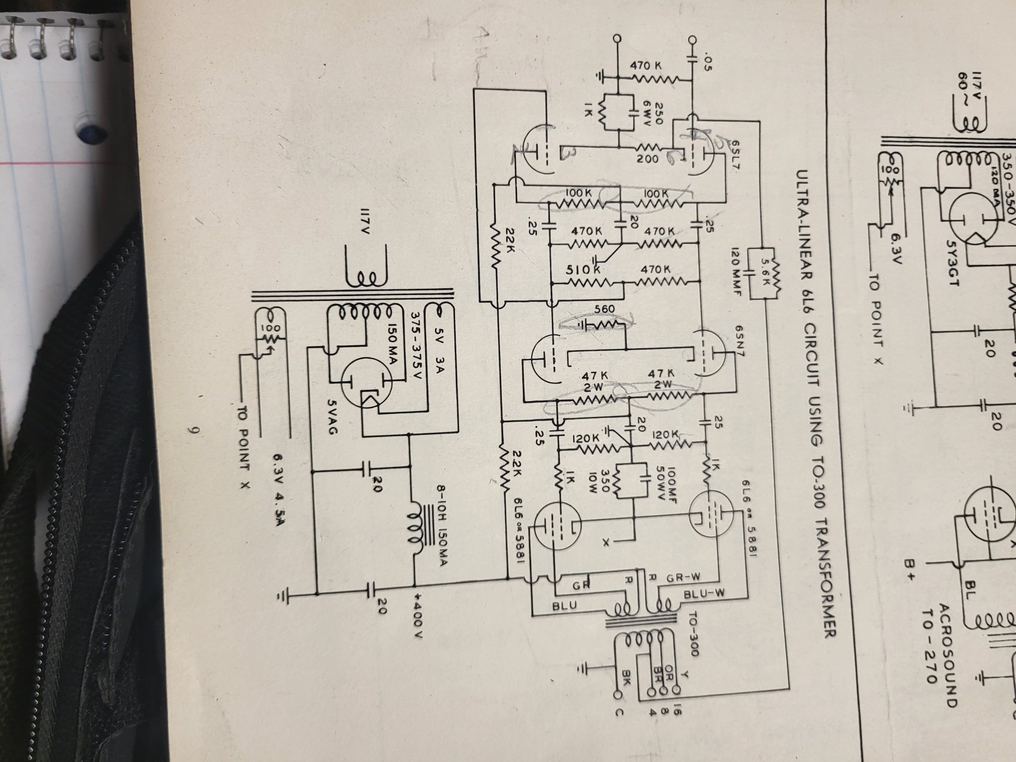

I didn't want to build another Williamson amplifier with these because that's already been done, alot... luckily, within the Acrosound transformer catalog there's another schematic for a 6L6 amp using the TO-300. Perfect, I'll build the one that nobody else has done.

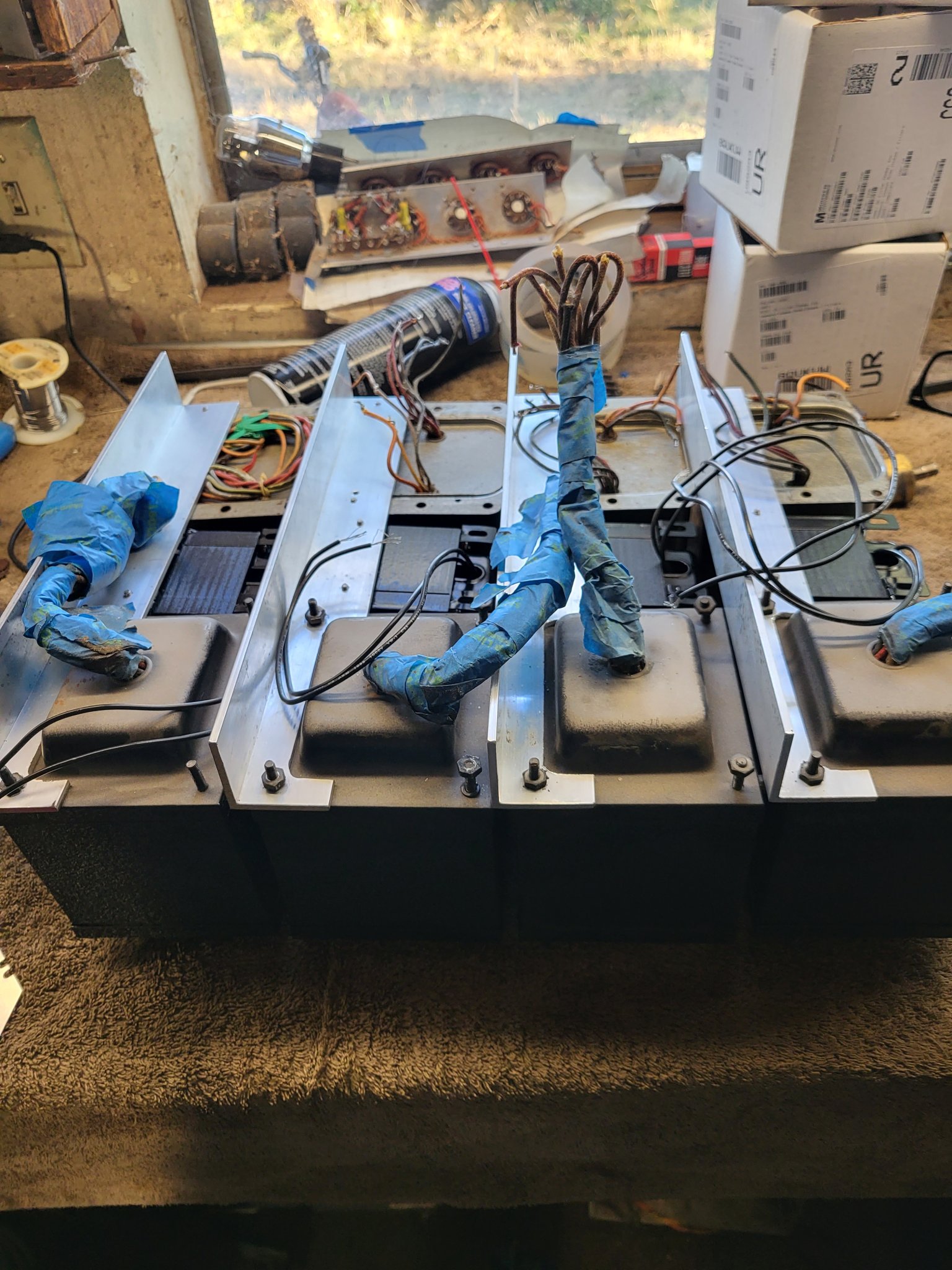

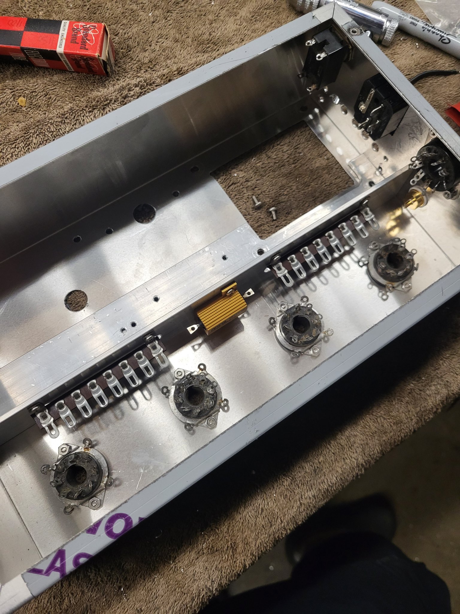

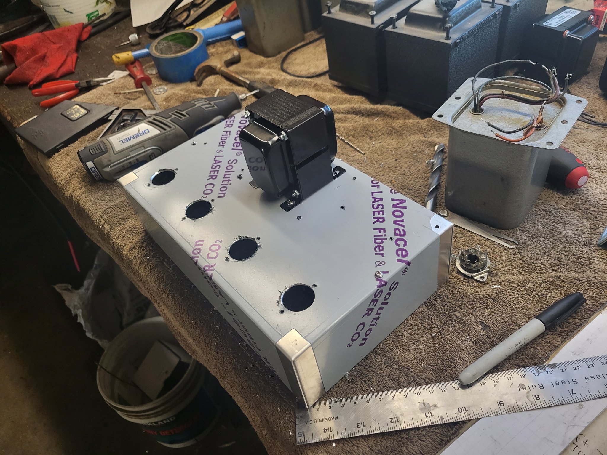

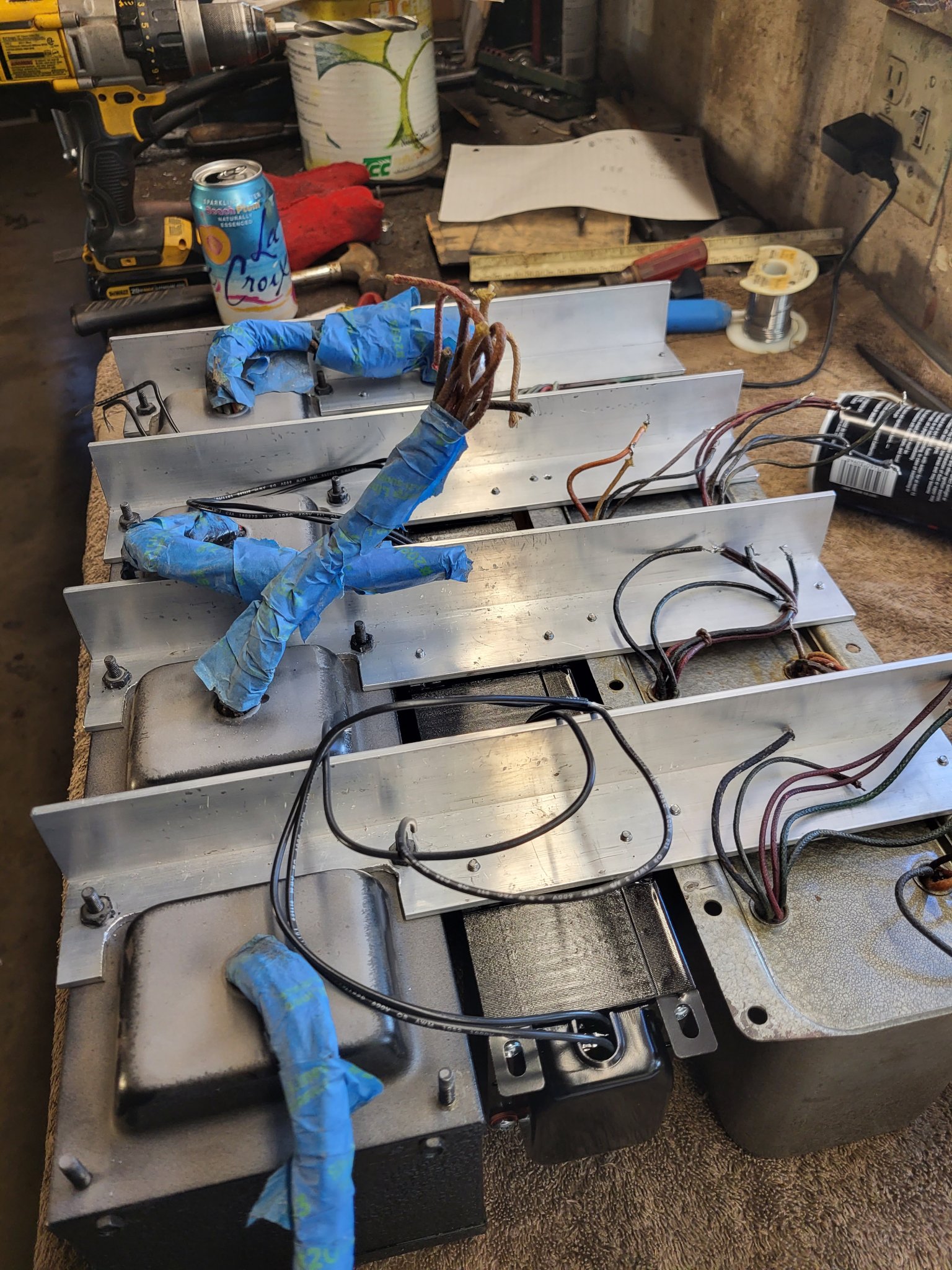

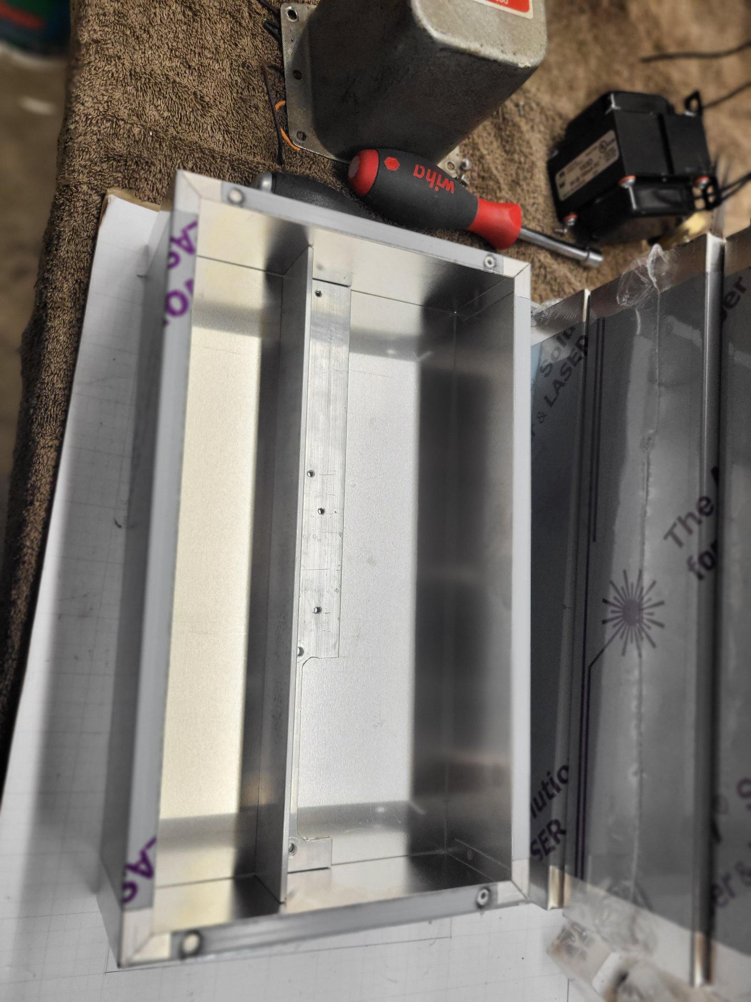

I ordered 4x 12x7x3 hammond boxes for chassis, I made 4 reinforcement struts out of 1.5" angle aluminum. I acquired 4 8 Henry, 150 miliamp chokes also from mouser. Drew it all out on graph paper and then transfered it to the chassis using a center punch. The chassis are all drilled out and finished now, the reinforcement struts are responsible for a lot in these amps, they keep the chassis rigid, but also provide a mounting point for terminal strips, and they act as a nut, meaning I tap holes in them so I don't need to use nuts on my hardware. The cathode resistor for the cathode biased output stage is attached directly to the strut with 4-40 stainless screws so the strut will act as a heat sink as well. There's also a row of convection holes which allow the heat to rise out of the chassis. Last night I began wiring up the first if 4. Yes there will be 4. Two are for me, and 2 are for my friend Izeck.

Overall very fun and relaxing experience and I'm not done yet. I'll try and get a photo of the schematic up today, it's a simple one, but I've never seen, much less heard one...

Hey Midnight that is looking real nice. I’m working on my first tube power amp and was thinking about how to stiffen things up around the iron. The angle iron idea looks like a good one. I’ll have to look into it
I draw it on graph paper first which may seem primitive and time consuming but it's not. You can use the same graph paper to transfer the drill points to the chassis box and the strut, then they'll line up perfectly once together, or that's the theory. Also the same drawing is used to mark all 4 amplifiers in the production run. We call this process CAD.

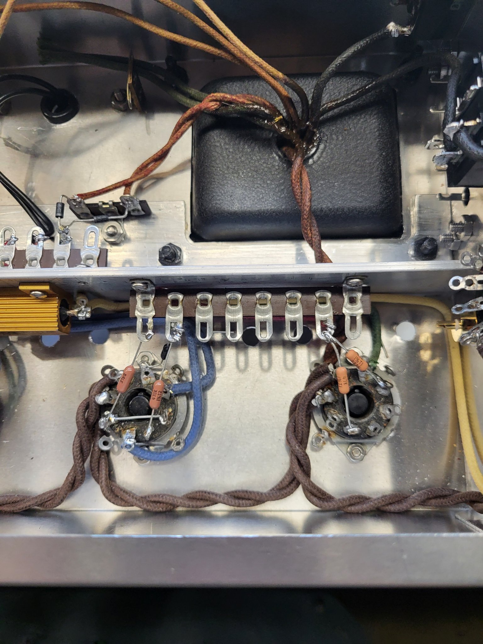

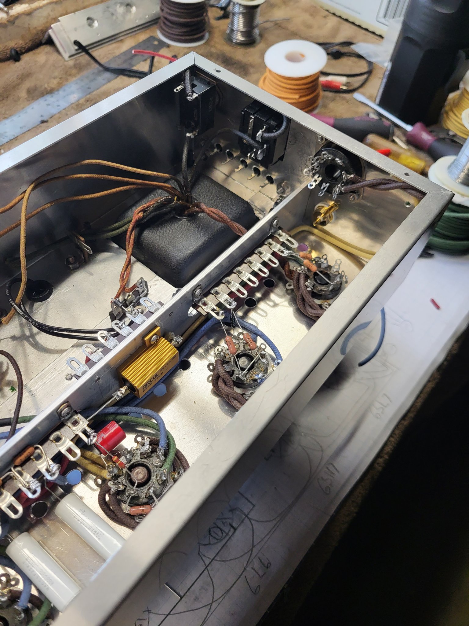

It's at 6.6v iirc. Anyway here's the schematic and I should be listening to #1 by the end of the day.

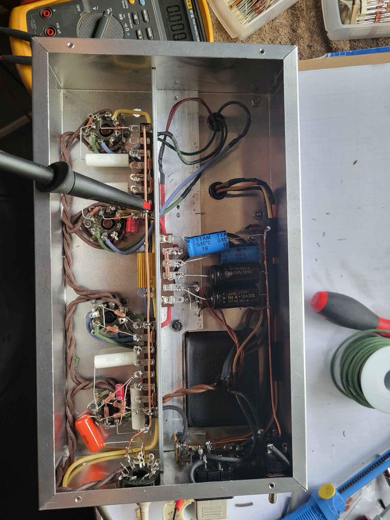

I've got to finish the power supply and then I'll fire it up...

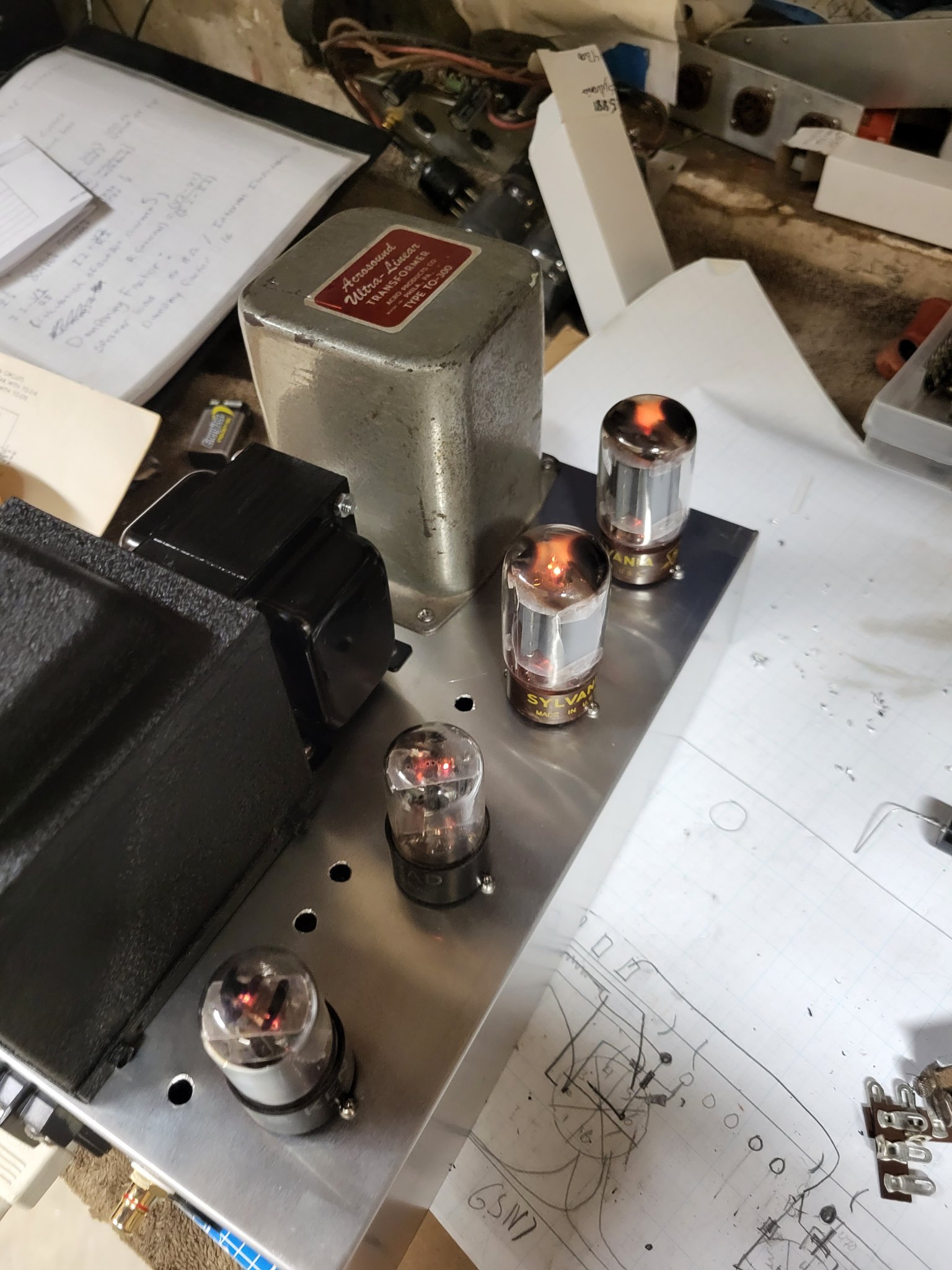

In other news I fired the amp up, haven't wired in the feedback yet but it plays the radio and that's an accomplishment...

Yes, I intend to look at the amplifier a little closer today, hook up the feedback and see what sort of baseline performance it will achieve.

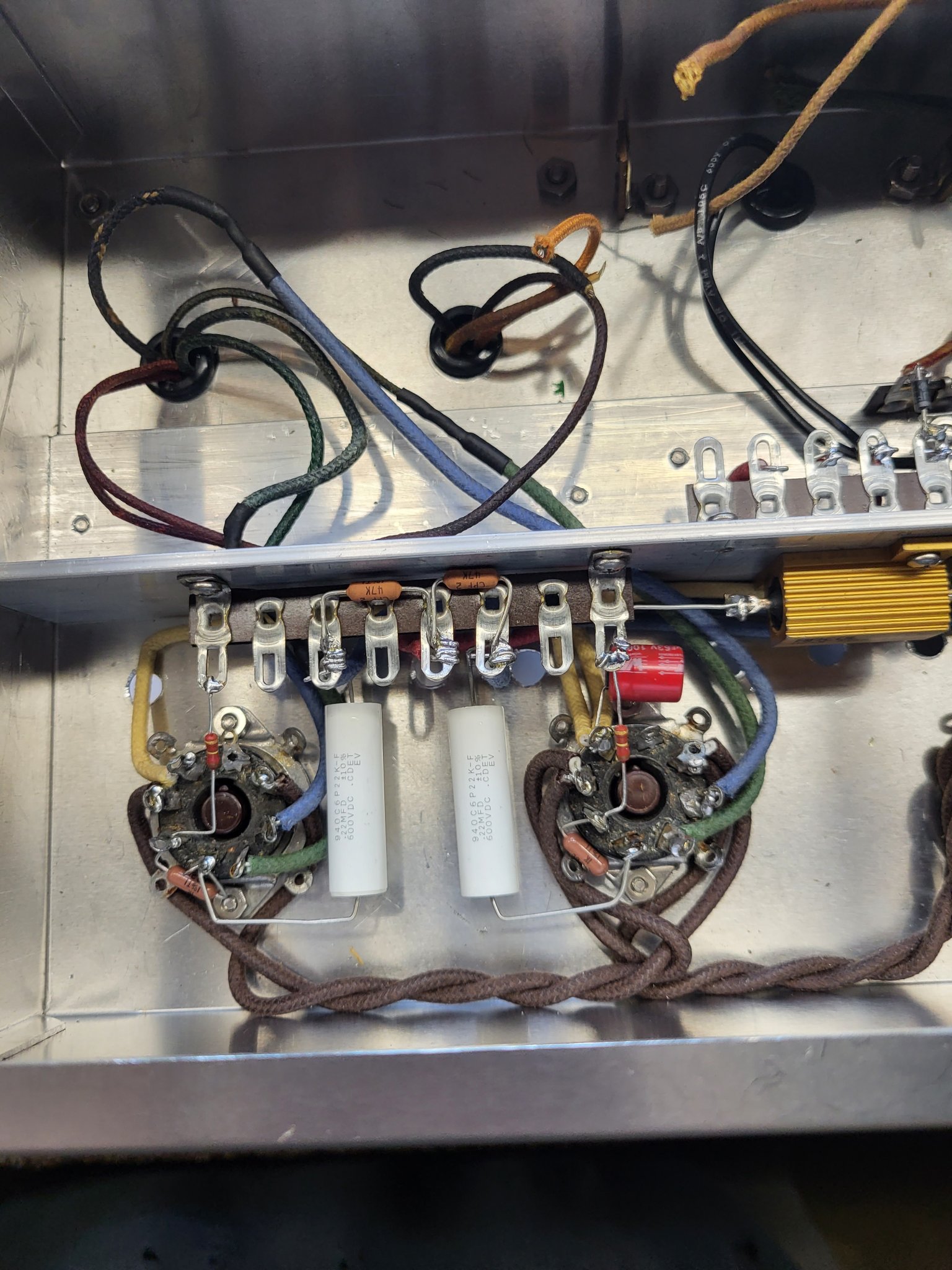

As I was thinking about it last night I've got a massive hum from leaving the heaters floating without ground reference. I'll need to button those up before measuring distortion.
