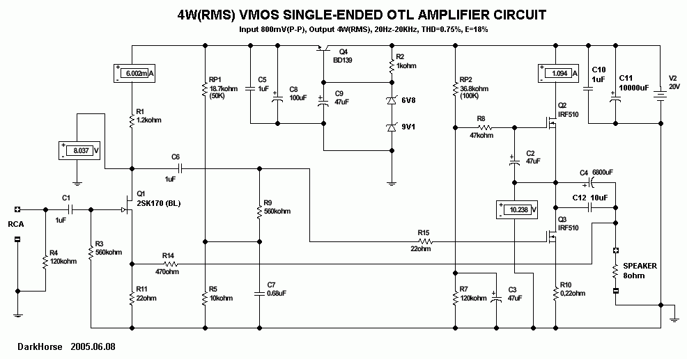

DarkHorse said:
as a class-A amp with 1.1A current bias,
let it's input end shunts to the ground,
put your ear to the speaker, nothing you can hear!
the filter cap just only 10000uF/50V and 10uF MKP cap...
it sounds so softly and sweet...I like it!
can such a simple class a mosfet amplifier really perform
would be interesting to know, really 😉
Is my attachment a correct schematic ??
of The Final Version of this All FET Class A amplifier
