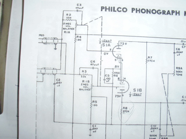

Snip out the portion of the schematic containing the volume control circuitry and post it. If, as I suspect, the VC setup is "routine", the 2 MOhm value is non-critical. OTOH, the 2.25 inch shaft is something to deal with.

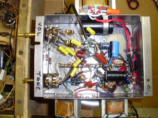

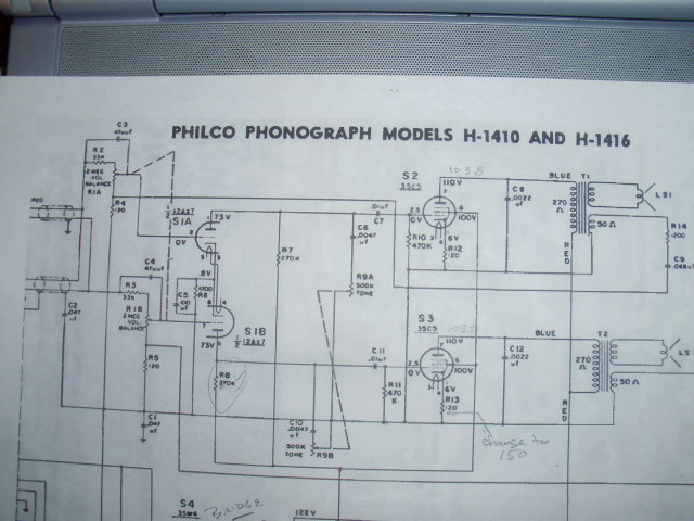

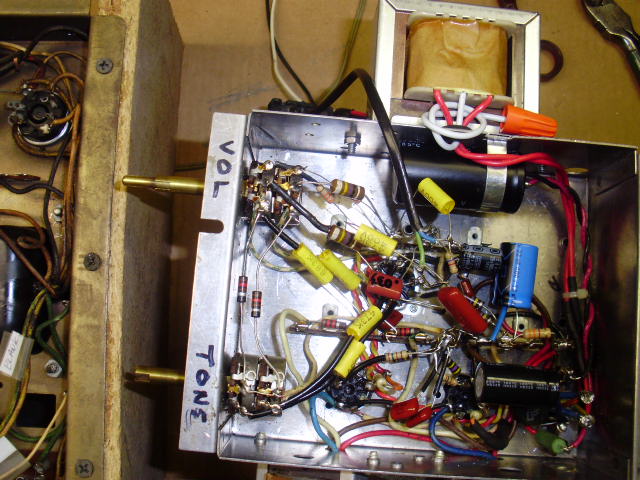

Heres a pic of teh schematic, w/ VC showing,,, I also am including a pic of teh chassis, in progress, so teh mods can see I did replace teh hot chassis , with a PT...
If these pics aren't clear enough, just let me know....

OUCH!! 😡 The "Bean Counters" were working overtime. They used a shared RC bias network in the voltage amplifier setup. YUCK! The NFB is applied to the 'X7 grids. Just to avoid "accidents", use a 1 MOhm value for the volume controls and wire 1 MOhm fixed resistors in series with the pots.' "tops".
The tone controls are GHASTLY. 🙁 IMO, the thing to do is eliminate the NASTY tone controls and install separate, L/R mono, volume controls. Devil take the ganged, stereo, parts.
Everything I see, except the tertiary NFB windings, in that amps' setup SCREAMS cheap. The presence of tertiary windings is incongruous. My guess is that fear of killing customers (bad publicity) accounts for the tertiary O/P trafo windings presence.

There are 2 openings for controls in the chassis. Put a mono volume control in each opening. C6, C10, and R9 (A/B) constitute what passes for a stereo tone control. All those parts are capable of doing is rolling HF info. off. In short, they are GUANO. Remove means exactly that; excise those parts, for being the "cancer" that they are. C3/R2 and C4/R3 are frequency shaping networks that boost HF info. Those parts are "cancer" too and need to be removed. The less the I/P signal is "massaged", the better. That's HIFI. 😉
Forget what I said about additional fixed resistance in series with the controls. Just use a pair of 1 MOhm mono pots. and connect them directly to the I/P signal wires.

Thanks for the info,,, seems there is a lot more parts in here then need be,,,I think I got it now,,, remove the original tone pots and VC pots, and replace w/2 one meg audio pots, which will act as VC/Balance.... also remove the C & R associated with them...
