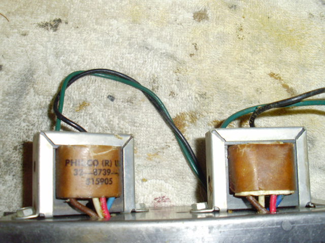

Hi guys,,,
I found another little, hot chassis amp (Philco H1410), to modify and rebuild,,, It has a 35W4 rec, 12AX7, and 2x 35C5 power tubes,,,
I have a SS power supply schematic, that was sent to me after I finished the 3tube Zenith amp, and I wanted to try it out...
The plan for this amp, is to replace the 35W4 1/2 wave, with a SS PS, and an isolation transformer and replace teh 35C5 tubes with 50C5's, which should up the power output about .8 Watt...
This amp has a separate OPT feedback winding,,,,
I'll post a schematic, and a couple pics of teh filter caps clipped in, if its allowed.. Its connected to an Isolation Transformer and DBT,,, and I got it working well enough to check voltages...
So, thats my new project, appreciate any help and advice....

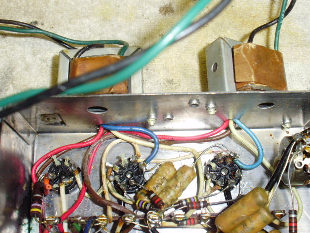

I noticed that the OPT's were floating when I couldn't read tube voltages with teh meter grounded to teh chassis...
I did a search for teh OPT's get specs on them, but couldn't find any info,, I have the Philco part numbers..I can't imagine they will have trouble handling a couple watts, tho???
John
Pictures, please! We need to see the O/P trafos in relation to the "fire bottles".
The series heater string is easy enough to execute; from the power trafo winding: a 39 Ω/3 W. resistor, a 50C5, the 12AX7, a 50C5, a 39 Ω/3 W. resistor, and back to the power trafo winding. If you spend some money and place the heater string and the B+ PSU on separate windings, the CT of the 12AX7's heater can be biased off B+ at about 80 V. Doing so will reduce hum.
It's safe enough to exceed the 50C5 data sheet max. anode voltage by a fair amount, IF you are "religious" about observing the max. anode dissipation limit. Bridge rectifying "120" VAC yields an approx. 165 VDC rail.
An 0B2 gas discharge regulator would be "ideal" handling the 50C5 g2 B+.

Good morning Eli,,,
I'd be glad to add more pics, the schematic I'm modifying, and teh slick PS supply that was sent to me right after I finished teh Zenith amp...
However, I got an email from teh moderators about this kind of (hot chassis) amps being discussed on this forum... I believe I complied with their concerns, but don't want to break teh rules,,,,
That being said, I am trying to make these plentiful, little, cheap, dangerous amps safe to use with the modifications I am learning, and passing on the info....
The SS PS I have places teh AX7 between teh 50C5's with a 33Ohm resister at each end...The AX7 heater CT will be tapped, thru a cap, and connected to Neg Grd...
A 1 to 1 Isolation transformer will be used to power teh amp...thru a bridge rectifier, thus raising the B+, and getting rid of teh "hot chassis" concerns,,,
This layout seems pretty similar to what you just described...
Also, as I did with the Zenith, the heater leads will be twisted and dressed away from teh inputs, and bigger filter caps will be used to further help quiet teh amp...
Do you have a schematic of teh 0B2 circuit, I can't find info in my RCA manual, but, if I make teh mods as I described, I will end up with a spare tube socket....
