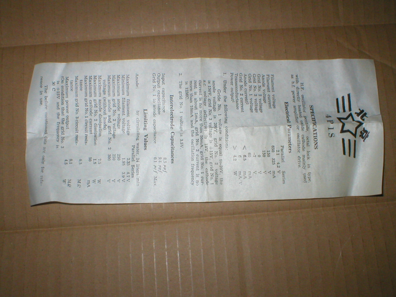

Just opened a few from another batch and found a datasheet inside a box 🙂 Oddly although appear to have been supplied to the Czech military by the Chinese , the datasheet is in English . Ties up with the operating point tables for the 4P1L

Realise this is old. Thanks for sharing the English translated data sheet.
So this is a directly heated pentode.
Is it not interchangeable with the 4p1L /4n1n then? Have you tried this is something?
Interchangeable . The Chinese 4P1S hits the specs , whereas the Russian 4P1L tends to fall short . Russian 4P1L much more consistent electrically
I am still yet to try 4P1S in place of 4P1L
Strangely the Chinese valves seem to sell for a lot more money than the Russian 4P1L
