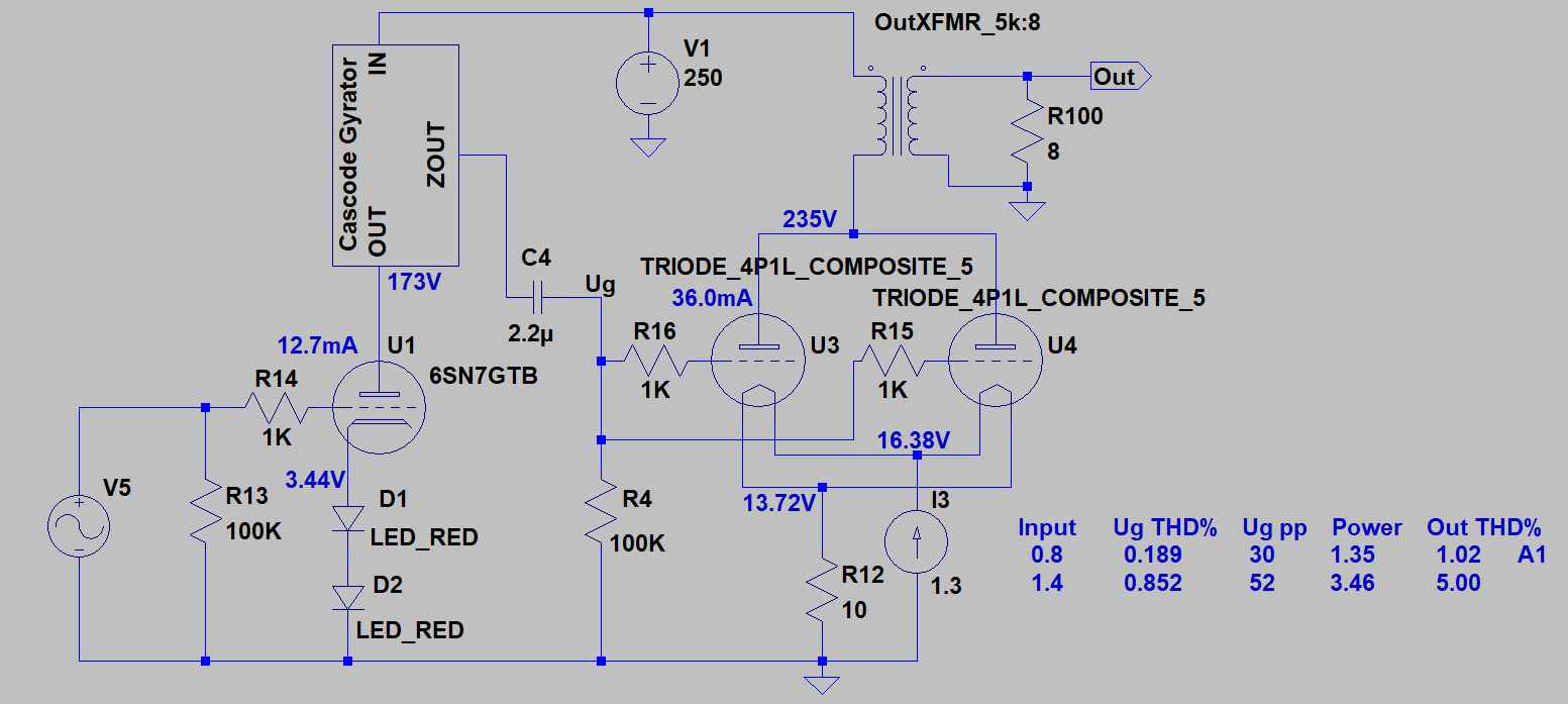

Bias for 4P1L will be ~18-20v. And since I am going A2 then the grids need to go positive. By how much? I have no idea. I am guessing I want a gain of around 30.
There will be a follower between the VAS and the 4P1L's.
The VAS will be actively loaded by a gyrator.
B+ is roughly 250. So if I set the VAS anode to 150 there should be plenty of headroom.

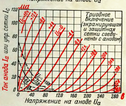

As you can see in datasheet even +12..16V is in the "working" area (with grooving distortion).
Attached an example:
15V peek grid voltage is the A1 border, 26V (deep in A2) is below clipping.

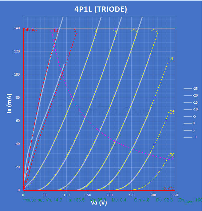

Here are the curves I traced with A2:
And here is the grid current:
With a 3K2 loadline you wouldn't need higher than 20-25V. A source follower or cathode follower would be required to provide the grid current without distortion with DC coupling to the grid.

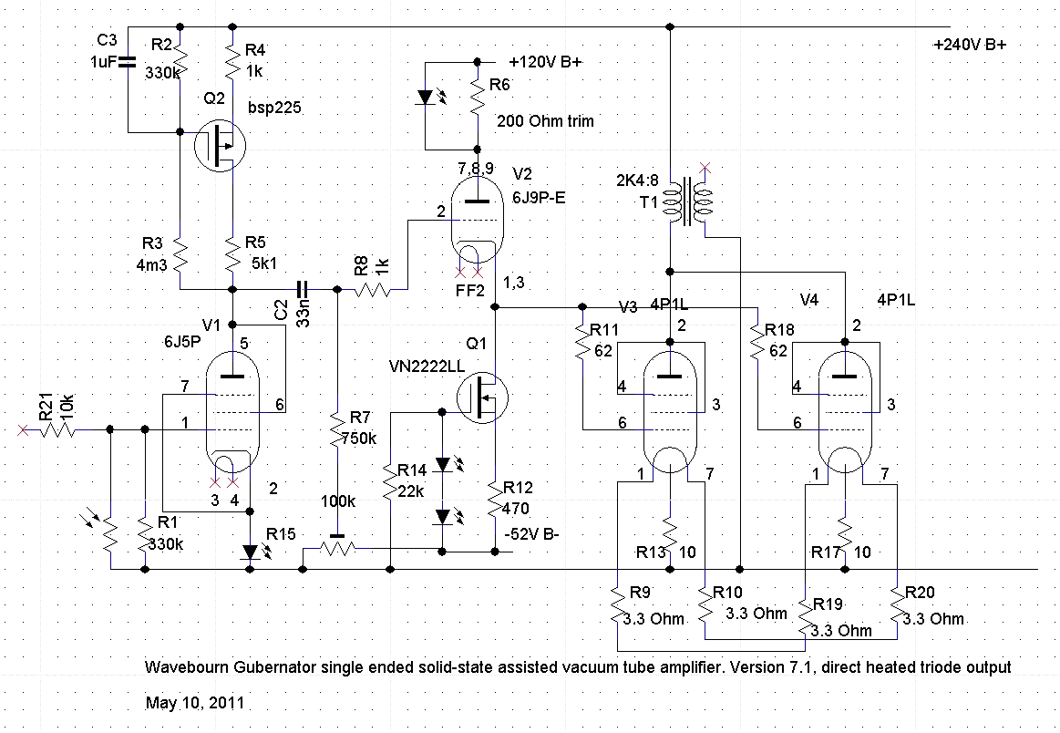

I posted earlier a design or you could look at Anatoliy's A2 design with cathode follower.
A simple SF with a bipolar 50V will do the job very well.
If I get the time I will retrace the 4P1L in A2 with the eTracer which is better fit for this job than the uTracer I believe.
The spice model is in my blog somewhere if you want to play with the circuit and simulate the response.
