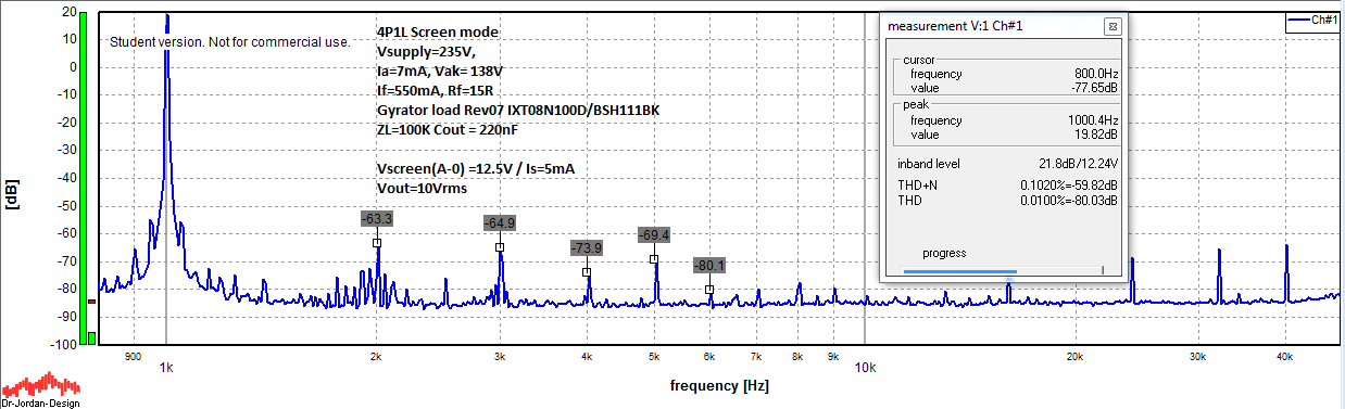

I did some initial tests to apply a positive voltage to the Anode when running the 4P1L in "screen mode" or using the screen as anode with FFT. It seems like applying 12-12.5V to the anode can reduce the H2 significantly. The actual response is really good. At 10Vrms output you only get 0.01% with H2 at -63dB and H3 and -65dB against 0.03% (H2 @ -53dB and H3 @ -51dB).
Need to apply the changes to the Mule preamp board and listen to it.
It’s quite sensitive to the voltage I found and I suspect there will be a variance between valves so the average impact may be not that optimistic
Ale

Hi Indra,
Quite interesting, but haven't measured any change in phase. In fact, I can't see how the phase of H2 will change with the given circuit. The harmonics are below 80dB and frankly, I'd probably personally struggle to notice such a minor difference.
See attached.
thanks
Ale
