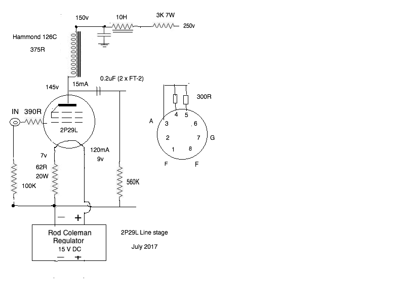

Slightly OT but since I mentioned it.... I got curious and made a "simple" 2P29L preamp using some Hammond 126C interstages I wasn't using. These are used as plate chokes with a couple of 0.1uF Russian teflon FT-2 output caps in parallel. Usual stuff for me.
Well, guys, this is a serious alternative to a 4P1L line stage. It's lovely - lots of detail, loads of treble and bass. In short, exactly what you would expect from a top DHT. And useful gain as well - should be a mu of around 9. It sounds surprisingly good in this simple implementation. Food for thought - another cheap Russian military tube that sounds great. No microphonic for me either.
Early days - I've only been listening for 15 minutes, but I like what I hear so far.

i have bought the 2P29L but i can see it is a bit difficult to mount on my K&K 4P1L socket print

Hi Bjarne
I just had the 4P1L into 126B and 2P29L into 126C in my system. The 4P1L was more solid, but the 2P29L had a bit more life and detail, so right now I have the 2P29L in my system. I'll have to A-B it with my 01A/Gyrator line stage and see which I prefer of those. In any case, the 01A replaced the 4P1L and the 26 into 126C so I know that's a preference. Haven't tried 4P1L or 26 into a gyrator yet, or the 2P29L.
