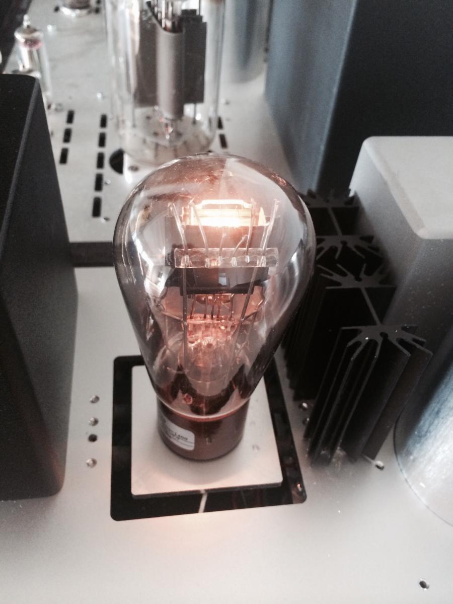

Has anybody had any luck with building DHT preamps in one chassis :
vbenonisen:
Attached pics of a 10 dht pre/linestage. Made with Irons from Tribute (Bless him, Opt's and the hv power and chokes)
Gain is 2x volume set at max open.
Noise at outputs max volume is 110 microvolt
Vibration damping ala Th Mayer ( guessed based on pics from his website)
and of course: Rod's excellent filamentregulators

Very nice Vegard. Veeery nice. I wasn't aware of that your amp was a one chassis affair. 10 is a bit to rich for my income, but I will definitely try to make a DHT preamp in one box. My old 26 preamp was in 3 boxes, but I've decided to downscale. What is the main problems I will be facing? Is it the magnetic fields from the filament supplies?

Yes Ale's site is indeed excellent. But my impression is that he always uses separate power supplies. What I need is probably some kind of theory on best component placement in "restricted areas" (read: crammed boxes).
Layout the preamp to keep the input wiring (grid and ground) very short, and similarly with the output. Locate the tube and the input & output connectors at the opposite end of the chassis to the transformers. Don't run any signal wiring right across the chassis. Route grid-wire twisted with the ground wire, and same for output.
Ale's gyrator board should be good for low-EM-coupling.
In a crammed chassis. keep the trafo->rectifier->cap wiring as short as can be: every 10mm you can reduce it will help. In a single chassis, I would probably use Cree SiC rectifier diodes for B+ ... valve-rectifiers may add to the problems. Use choke-input for the B+, and maybe even for the Filament (Hammond 159ZC, for example). I prefer chokes/trafos under the chassis top-plate, to reduce coupling to the tube.
The Power transformers & chokes should be at least 150-200mm from the tube & wiring, or I suspect there will be some coupling.

Absolutely agree with Rod, which is hardly surprising since he has the right answers here. I'm familiar with Ale's builds - he comes over at times and we listen to a bunch of DHT gear. His Gen 2 01A preamp is really special. He and I like to use outboard PSU and filament supplies. For all the reasons Rod mentions - keep the magnetic components away from the tubes. But also for ease of experimenting.
I now use a lot of small chassis. Light and easy to move around, which you do a lot to change components. No boat anchors. So I have separate boxes for the output stage, line stage, PSU, each filament supply. I have some average PSUs, and some ridiculous overkill PSUs with AZ1 mesh rectifiers, two enormous chokes and so on. Yes, overkill sounds slightly but audibly better and whether it's cost-effective is a personal decision.
When it comes to filament supply I think overkill is the only way for filament bias. Choke input sounds better, and audibly better. I use the 159ZC chokes Rod mentions, and also a bunch of huge 280mH chokes rated 2.5 amps, 3.5 RDC. They sound even better. Magz goes LCLC even. Thomas Mayer uses chokes. So I would say take the filament supply outboard and don't be happy with anything less than choke input - bigger the choke the better.
