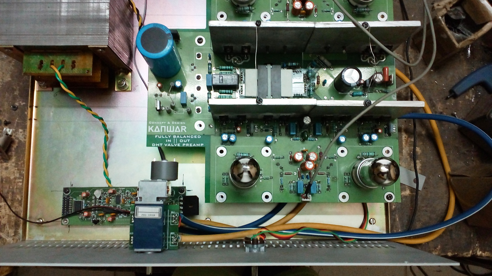

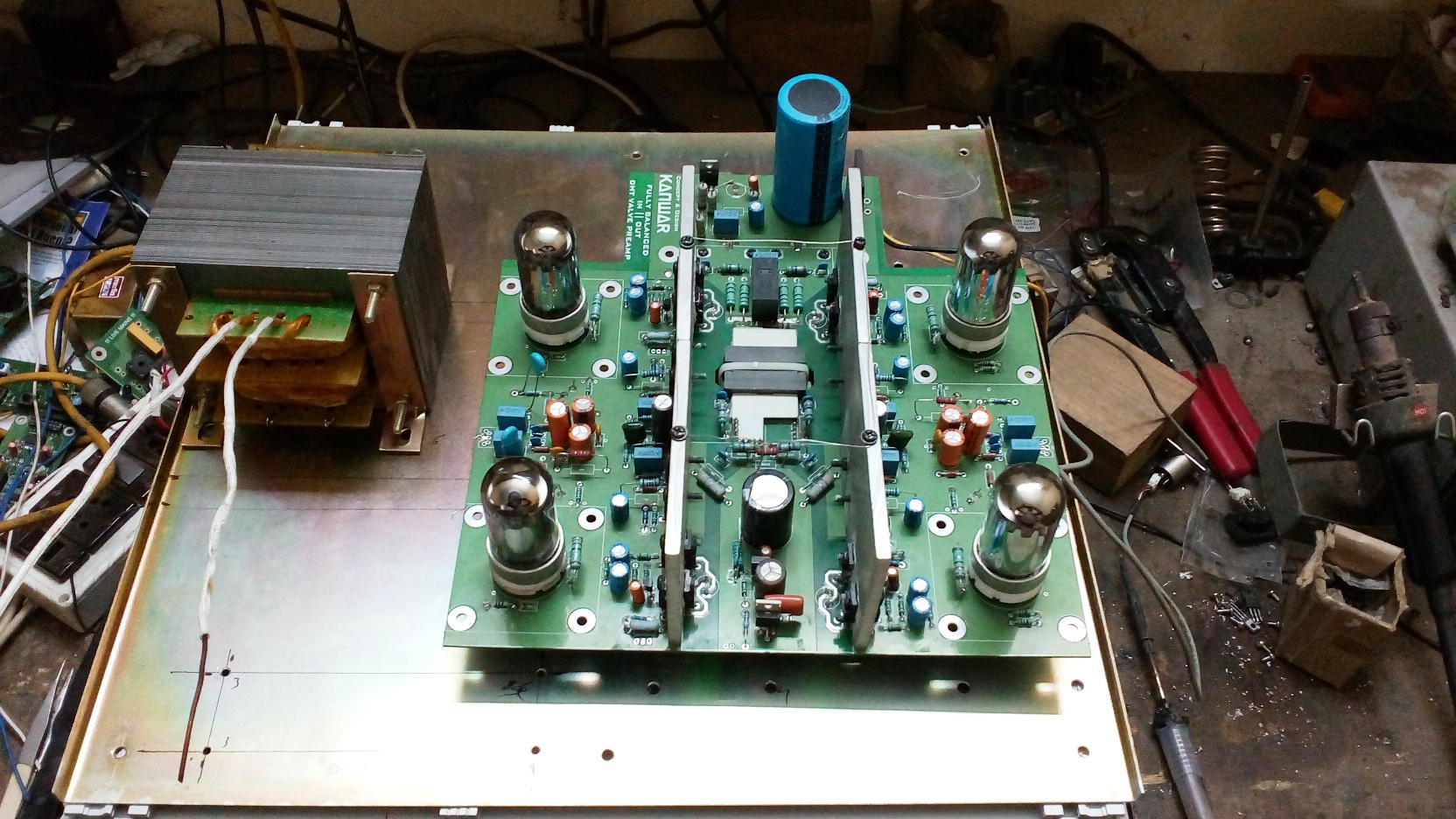

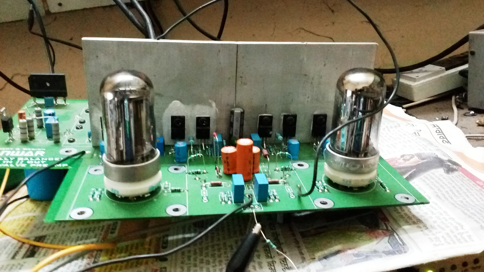

Here is my version of fully balanced differential LTP version of 4P1L preamp. Heaters are isolately powered from 250khz resonant drive along with CCS+Gyrator combination and the tubes are loaded with gyrators. +B supply turns on after 60s of heater voltage activation.🙂
Very nice. I plan to give this a try with transformer loading. How do you like the sound?
Very well balanced, detailed and transparent 🙂

Hi Tim
Yes its my design but cannot divulge its design at this moment.🙂
Though I can share some of its detailed aspect:
1 Planar transformer is used to generate 180V B+ and 4 isolated 7V heater windings.
2 All diodes in rectification are schottkys.
3 Heaters are current regulated.
4 Plate is loaded with mosfet based gyrator.
5 Cathode current is also current regulated and is fixed at 40mA
6 Planar transformer is being driven in resonant topology @ 250khz with softstart sequence
7 Differential gain setting is AC coupled.
8 The operating point being current regulated will allow the use of unmatched tubes, thanks to automatic CCS bias correction
9 Its a fully differential input and output design, even if your source is single ended, this preamp will give you differential signal output

Who told you that I am using a Gyrator to fix current related operating point ??😕 Or had I written anywhere like that ?
Gyrator is used at plate side which fixes voltage operating point not current, Whereas CCS is used at cathode/filament side and is biased at 40mA.🙂 🙄
And each tube has its own separate CCS for biasing the operating current.
^CCS is also used as a plate load, where its high impedance, maximized gain of the tbe....
whereas using a resistor plate load, you can not make it very high(for large gains)
without correspondingly high plate supply B+. not so with a CCS.....
anyway, glad to see you working tubes....a different ballgame.....😀
