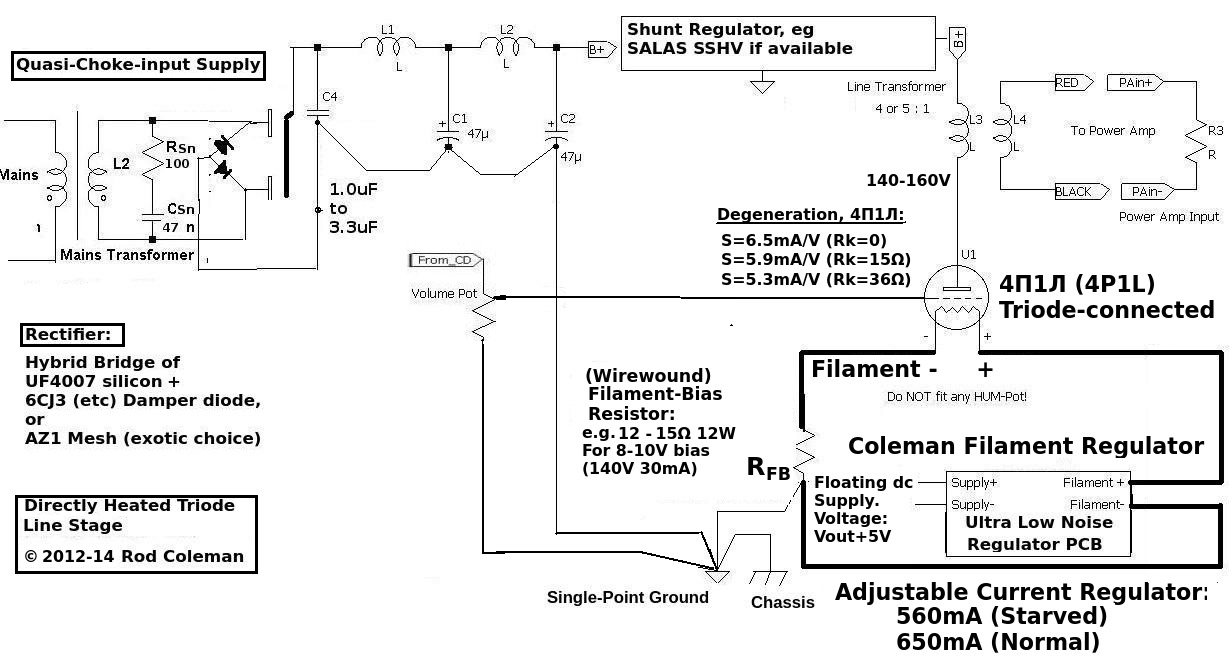

Do your grounding correctly, I think that's your problem. It amazes me though, you're running in circles, but still haven't posted one drawing of your ground connections. All it takes is a pencil and paper.
I will see if can make a drawing....but i have try 6 different grounding,,,and none have give better result

So ,can anyone draw a grounding schema for me..???

The most important part of the build work is grounding and avoiding ground loops. A combination of star grounding is recommended. I do the following star ground combination:
Input stage
Filament bias return
Output stage
You definitely want to avoid the filament current ground introducing hum in the output stage so you want to keep the three star ground points separate.

Bjarne,
Use my 4P1L Line Amp basic schematic. Wire the internal grounds like this.
Connect the Ground "Star point" to chassis near the input terminals.
Don't use chassis as a "wire" to connect things together!
Try to make the input wiring very short (input socket near the volume control, and near the 4P1L socket) or used shielded internal wiring.
You must find the reason why the output trafo caused such buzzing - maybe the high voltage supply has noise......
Please make the heavy black lines in the drawing (filament wiring) short, and use 1mm cable.
Please check that the Raw dc voltage to the regulators is 5V (4,5 - 7V) above the output voltage.
Typical: 15,5V in... 10V out.

These points return to starground:
... and of course the filament resistors go to star ground.
I guess your potmeter is at the bottom of the picture, that's a very busy position wrt radiation of rectification pulses. You could place your pot inbetween the output transformers.

If you replace your pot inbetween the inputs and the tube sockets the noise will probably be gone. Try without the pot if you have an adjustable output on your source.
