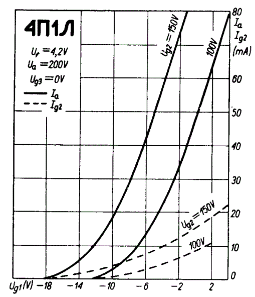

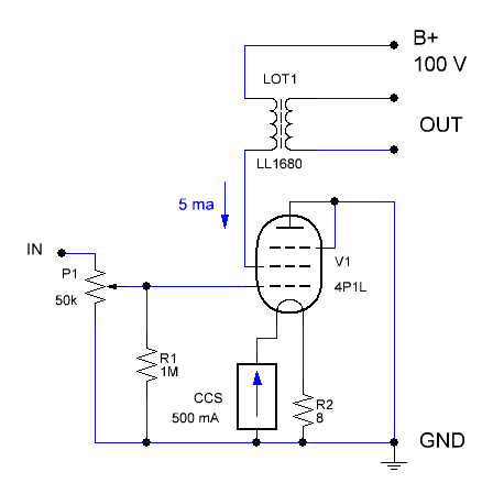

4P1L Screen Mode
I'm waiting for my shipment. While collecting info, I stumbled upon Weird pentode connections thread that got me thinking, since the 4P1L max screen current is rated at 10mA, there is a viable option to operate it as a true triode by taking output from G2. Both G3 and Anode are grounded and act as a shield. By selecting Ig2 bias at ~5mA, we can readily use the chokes and other loads suitable for the #26. The prospect to be able to listen to a wire anode really picked my curiosity, it may share some sonic signature to the mesh plates, or even a uniquely different signature altogether. Any experience, comments or pitfalls to avoid?

That is normally done by connecting together G2 and G3 as the plate.

Hi Indra, To reduce the Anode (now - was the screen) current to 5mA, the bias probably needs to be much greater than filament bias into 8 ohm..
If you use ordinary cathode bias to see if it works properly, the job will be quick to perform, and you can re-calculate for filament bias later. If you have the trafo, why not give it a try?

Hi Rod, thanks for the suggestion, you could be right. I was using this curve as a guide, but there is quite a bit of variation on Ig2 curves on several datasheets. Unfortunately I still need to wait for the shipment of the tubes to confirm.
