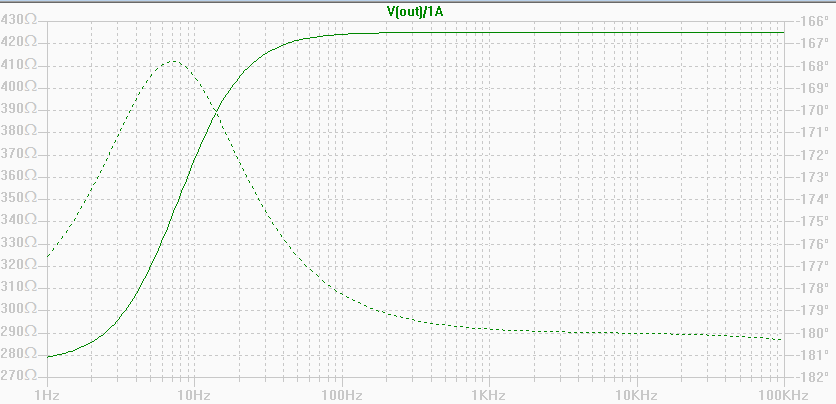

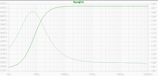

Are you sure the output impedance is 425 ohm? It should be around 80 or so...

Why? At very low frequency you see Ra||Rp reflected in the secondary. That is Ra=(1k6 || 1K2)/(4.5)^2. This is lower than 80 and you still need to add the RS=277ohms, however at higher frequencies, the Lp=2*pi*f*L. L=50H approximately and this impedance is complex. Lp is now in series with the Rp. If you want to avoid the complex algebra involved, you can simulate this in LtSpice and you will see that is higher than 420 ohms
cheers
