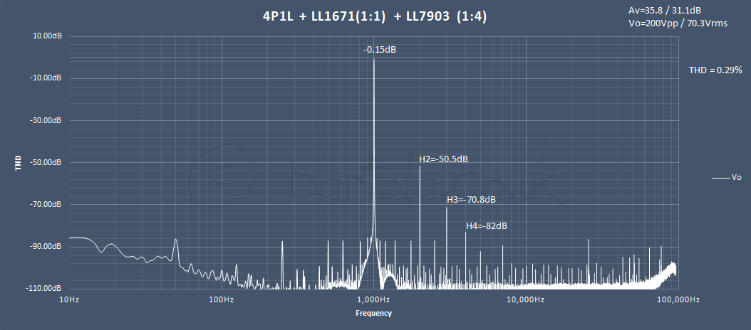

You can swing the 4P1L to 200Vpp easily with less than 0.3% THD. Nice harmonic distribution as well.

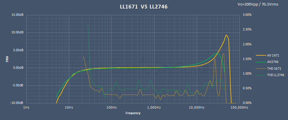

I tried the LL1671 in 1:1 and the LL2746 in 1:2 step-up. The latter can perform much better if wired in 1:1 (recommended by Thomas Mayer from his own designs):
Obviously you can see I didn't bother to add Zobel compensation for the HF peaks above. Practical experience shows that you may even not hear the difference 🙂

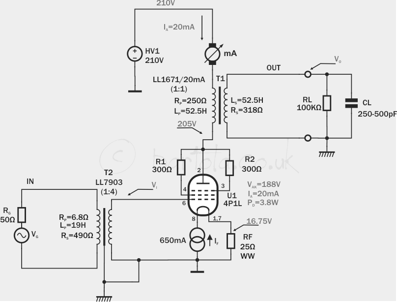

Hi Andy,
you can get 36 with a 4P1L with input step-up:
However you pay the price of having Miller impacting heavily. I measured the input capacitance @ mu=9 to be around 176pF for a 4P1L. This will be reflected as 176pf*16 for a 1:4 step up transformer. This is nearly 2,816pF of input load! If you don't have a line-stage, then I don't think it would be any manageable load for your DAC at all.
In my current 46 driver, the 46 has a mu-follower gyrator load and the anode voltage is fixed, therefore is not suffering from Miller in the same way.

Hi Ale,Hi Andy,
Ale
I measured 4P1L's input capacitance using Morgan's idea: sin wave with series resistor and determine f-3dB. Cinput =1/2pi*f-3dB*R. From my measurements Cinput was about 75pF. If this is correct, we might have a better input load for 1:4 SUT of 1200pF. The question is does this value makes thinks much better?
