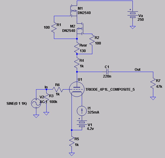

I´ve been following the 26 DHT pre-amp thread with a lot of interest for some time. Hence, I ended up playing with LTSpice on a 4P1L line stage circuit as this valve is more than attractive due to its superb linearity. I´m sure that there are multiple and varied opinions around which DHT valve is best for a pre-amp, but the 4P1L seems a great candidate bearing in mind its cost.
As I don´t have any choke or transformer at hand, I´m looking at a DN2540 cascoded CCS as anode load. Target quiescent operating point is Ia=10mA and Va=150V/Vg=-10V. Not sure if this point is the best for this valve, I will try its sound unless anyone has any suggestions...
I was looking at fixed bias, but as there are multiple opinions around which bias setup is best, I just simulated cathode bias with 1K resistor (see diagram).
I guess that I could use Rod´s DHT filament board or a simple LM317 as a current regulator?
This line stage is intended for my 45 SET amplifier which has 47K as input impedance. Hence the 47K load resistor.
The stage gain si around 7.7 as expected. I have 220nf teflon capacitors so frequency response will be limited to this, which is not bad at all.
Based on the 26 pre-amp thread, many have tried LED bias, cathode resistors, filament bias and fixed bias with batteries. What will you recommend for this setup?
I´m throwing this out as an idea, so hopefully haven´t made too many mistakes .-)

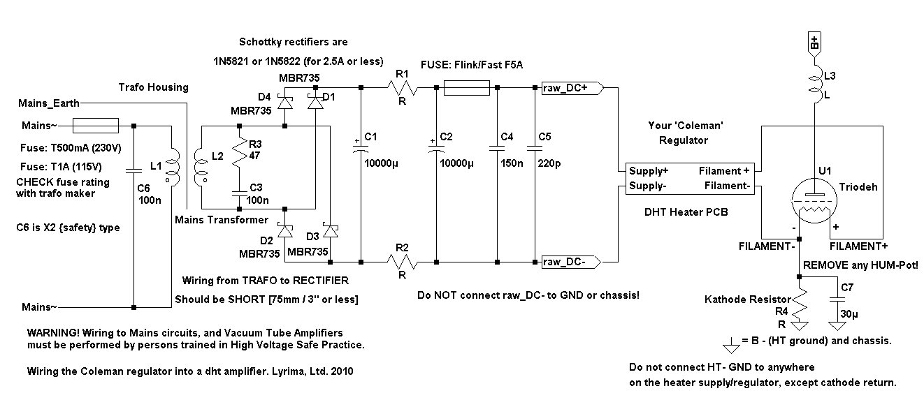

Quote: Originally Posted by Rod Coleman
Building with the mains transformers in a separate enclosure is surely needed.
I question that, honestly. The leakage field from even a cheapie toroid - like the ones from Antek - is minuscule. For an EI core this is different. I actually measured the output of an amplifier versus orientation of the (toroidal) transformer. I wasn't able to change any of the 60 Hz harmonics' amplitude by moving the transformer or rotating it. Granted, this was in a smaller circuit (SMD components, small inductive loop areas), but still... I was quite surprised by this result. I had expected the transformer orientation or proximity to have some impact. I was planning to use an external supply for the amp, but could place the toroid right up against the amp board without seeing any increase in 60 Hz (or harmonics) on the spectrum analyzer. Instruments like spectrum analyzers (HP 3562A, quality sound cards, etc) or wave analyzers (HP 3581A) are your friends for these tasks.
Separating the amplifier from the power supply opens up a giant can of worms (or whoop-a$$ if you're not careful). You have to really plan out the grounding scheme (both from an electrostatic shielding perspective and a safety perspective). Then add that you'll have 250 V DC running through a fair amount of cable. Of course, like any other engineering challenge, this can be solved at some expense (both money and time). I would build the amp on a prototype setup in the lab first. Get it to work on an old sheet of FR-4 first. See if a separate supply really is needed. Then decide if that's the route you want to take. It's one of those things that look great on paper, but can come back and bite you if you're not careful.
Tom, please read the thread "26 Preamp" to see how this is done correctly.
You are right inasmuch as the Toroidal trafo does not radiate magnetic stray fields, but this trafo style is only a good choice for linestage duty when you have no HF/RF conducted noise on the mains supply. Not many locations can apply! This is due to the toroidal's winding style, with all the secondary windings scatter-wound directly on top of the primary. High capacitance in other words, ideal for coupling all that HF straight into your circuit. Sure you can try to filter it, but I believe that most designers would rather just eliminate the coupling and not have the noise.
In addition, the core material of a cheapo Toroidal is usually unconnectable, and floating, it can do nothing to help suppress common-mode HF mains noise being radiated from the windings, and coupled into the signal wiring, signal interconnects, etc. And since mains feeds are long tightly-coupled cables, the majority of the noise will be common-mode.
Split bobbin EI trafos, with grounded core, offer hugely better insertion loss to high frequencies, and the connecting the core to chassis is very effective in smothering emissions. That's the budget choice. For higher cost, properly constructed EIs with interwinding screens improve the noise rejection further.
The 26 line-stage builders will vouch for the lack of difficulty in making 2-enclosure amps work. The chief concern is to keep the trafo/rectifier/choke/first cap closely coupled (in the mains enclosure) - which puts an end to any recharge-pulses in the ground wiring. After that, one ground wire to the signal stages, and a cap to decouple the B+ wiring. With CCS loading, the valve stage do not impose current pulses on the supply - so sharing between the two channels is fine. And even if it was not fine, using 2 shunt regulators would completely suppress that problem.
I am not suggesting we run 10-metre cables between the mains enclosure and the valve box. 300mm will suffice, a little more will be plenty. If you have safety concerns, just use steel-wire armour cable (= outdoor duty mains cable). In the UK this is rated safe to carry our 240V mains across the outside of walls, no further protection required. It's used in large quantities, and available cheap.

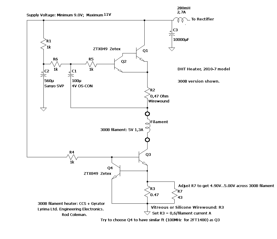

With a LM317, you can measure the noise (voltage) with a scope, and compare with a line-level grid signal.
As you can with any other regulator. A multimeter with relatively wide bandwidth (HP 34401A or the older 3478A for example) are real handy for this. Scopes work too.
No doubt meters exist to evaluate the noise on my CCS/Gyrator based filament supplies, but no instrument in my possession registers anything at all. The TEK 465 shows ZERO perturbation on any scale, and the DSOs don't match the resolution of the 465.
This is no surprise, since the regulator does not contain any references, zeners, bandgaps or anything else, and the noise can be narrowed down to the contributions of a couple of transistors and a sub 1-ohm resistor: down in the nV/(Hz^0.5) in other words. The transistors are run at high current, and have low Rbb, too - so the figure is low even for the circuit structure.
Nice!
Well... There has to be a reference somewhere. Even if it's a Vbe or a Vgs. But I get your point. Would you point to the most recent schematic? I'm getting curious now.
It's a nice-looking tube. I've been mulling over building a low-power DHT headphone amp with those. Incredibly linear and good pricing. What's not to like... ? 🙂
You may not need the cascode. The semiconductor CCS'es have quite high output impedance as-is and don't suffer that much from channel length modulation (MOS analog of early effect). Of course, the cascode, generally, improve the CCS'es but there may not be much difference without it.
Those are options. Constant voltage is another option. I have never been able to measure or hear any difference between constant voltage and constant current, so I go with constant voltage for cost and complexity reasons. I actually use switching regulators for this on my 300B amp. You can see schematics and measured data here: http://www.diyaudio.com/forums/tubes-valves/175695-300b-switchmode-filament-supply.html with a follow-up in post #17. You'd, obviously, have to tweak the feedback resistors to get 4.2 V rather than the 5.0 V I use for the 300B.
With 1 Mohm, 220 nF should yield 0.7 Hz lower cut-off frequency. Whether 1 Mohm is enough to prevent the grid leakage of the tube from causing issues is another story. I don't have any experience with the tube, so I can't really tell. But 1 Hz is plenty low.
I like LED bias. The dynamic impedance of a RED LED (HLMP-4700 for example) is on the order of 10~20 ohm so it behaves reasonably close to a 1.7 V battery (at 10 mA forward current that is). That tends to result in very low distortion (I'm measuring below 0.01 % THD+N on a 6J5 (one half of a 6SN7) running at 1 Vrms). A simple LED beats the other types of biasing schemes on performance and/or complexity 99.9 % of the time.
One thing, though... The power supply (B+) needs to be really clean. I recommend using a voltage regulator. You can also use heavy RLC filtering or other regulator types.

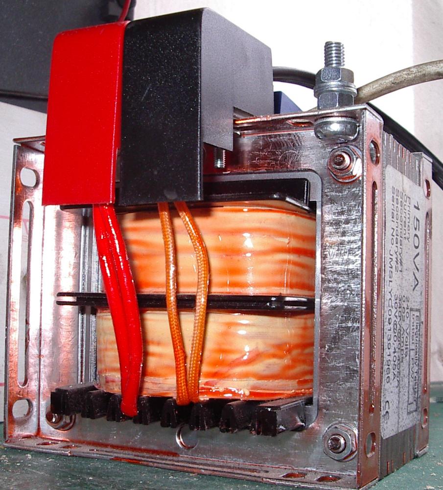

Tom, we can put some numbers on the difference in HF insertion loss.
For some trafos loafing around on my bench, the capacitance measurements were:
split bobbin:
- 240V pri;
- 370V sec; 150VA: split bobbin. C(pri-sec): 70pF. C(pri-core): 85pF
Toroidal:
- 12V 150VA C(pri-sec): 300pF
- 54V 100VA C(pri-sec): 720pF
We might expect from this that the interwinding capacitance of a Toroidal B+ trafo might be 1.5nF or more. If that's anywhere near correct [don't see why not] - we will get 20x better insertion loss using the split bobbin EI.
The split-bobbin type I measured was an industrial type available new at a very low price:
150 VA
Builders in the UK need not hesitate with these - you can specify winding voltages for secondary AND primary as any voltage you like. The quality and service from this company is first rate.
As for connexion to the core: Consider the toroidal trafo usually has [for safety] the primary wound next to the core. Judging from the interwinding capacitances, we will get > 1nF of capacitance to use as a filter, which would reduce the noise out to much higher frequencies than ordinary capacitors can. But not if the core can't be connected to chassis.
Personally, I regard split-bobbin trafos as a minimum standard for DIY audio. Not to mention that the JMS types are lower cost than any other solution! Here in the UK, anyway.
Mileage may vary in different locations, and not everyone likes the look of industrial trafos, but then if you have more spend available, there are many high quality options, including screened secondaries, ornamental end bells, even fancy core materials.

I hope you're willing to share the schematic for your DHT heater regulator (or at least link to it). I saw some of the earlier revisions (I assume) in the DHT heating thread. But something tells me you have the thread and post number memorized... (Or maybe that's just a projection 🙂).

Here's a wide-open split-bobbin shot of the JMS 150VA. [Let's see what the smut filter makes of that 😀]
Secondary is 340V and 30V. 70pF C-winding as above.
Pros of JMS:
- Proper tough industrial quality split bobbin.
- Insulation standard, terminals and earth stud are rugged enough to satisfy a Victorian.
- Lowest cost I know of.
- Order on the web, specify the windings any voltage you like.
- email to Sean and he'll tell you what can be done, including accurate predictions of Rdc [if you are into critical damping, or just want to model it accurately before specifying the turns].
Cons of JMS:
- Only do courier shipping [£10], so it's best to buy a stash for a few projects.
- Varnish finish is strikingly similar colour to the sauce around Heinz baked beans.
- 150VA is the smallest type that is definitely split-bobbin. ask Sean if you need something smaller, and check.
- No end covers for chassis-top showing off. Steampunks beware - These are best exiled to the hinterlands of the chassis set.
I have used them 3 or 4 times and rate the service highly - only a few days to deliver, even on full custom windings. I haven't used 6V heater secondaries, since I have a stash of heater/filament trafos, and don't like overwinding heater/filament supplies anyway, due to risk of coupling recharge pulses. Ask Sean if you need these, and see.

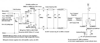

Tom, here's the schematic for the regulator and the raw dc supply.
The production version is refined a little, to improve LF ripple rejection and render it adjustable. I don't want to post the as-manufactured schematic while they are still available, as there have already been a couple of clones seen out there [which are unsupported, BTW!]
The operation is unchanged though -
the top portion is a passive gyrator:
- reduces incoming ripple;
- provides high insertion loss (HF transmission path is <100pF only)
- bottom section is a Vbe-referred current limiter, using NPNs with low-noise capability, and low Cob. Again the insertion loss is good up to very high frequency, and permits operation of DHT amplifiers even in systems with noisy CD players nearby. [Try waving a scope probe in front of a CDP display, to see why this is important!]
Overall, the filament is treated to wideband isolation from outside noise, and includes no significant noise sources of its own.
I originally wanted to make the manufactured units with a voltage-servo, so that the regulator was a dc-servoed CCS. I tried adding an opamp voltage loop, with <1Hz LF rolloff - but this destroyed the 3D imaging and subtle resolution of orchestral music. Out with it!
There has been lots of good feedback for the outcome:

Rod, what about your filament regulator, do you have one suitable for this filament voltage/current?
Ale
All models of the regulator are still available! please send me some PM. Maybe you have my email address from the 45 filament reg buy, or click on my name to send some email.
The standard 4P1L model can adjust from 260mA to 380mA [4P1L spec is 300 to 350mA]. It runs best from 8.5V to 12V of raw dc, so a 9Vrms 30VA split-bobbin trafo works best.
Use one trafo for each 4P1L for best results.
