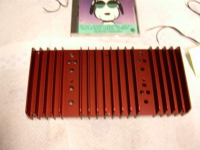

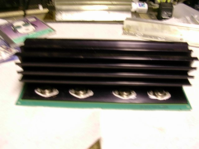

Alright, I will take some pics of some of the goodies and post them. I had a storage area full of heatsinks removed from all sorts of things. Had some that were 4ft long and 14 inches wide. It is a long story, I was forced to have an auction and somebody bought the whole lot for scrap!
There was over 500 pounds of heatsinks in all shapes and sizes. I was able to save a few and have aquired a lot since. I still have a four foot length of 11 inch diameter "starburst" that was used in a custom project. Cut in half this thing looks KILLER on the outside of a chassis. If you want machine work done on them, email me the design and I can quote you a cost.
I have my own cnc mill and am building a lathe with live tooling to do some real trick car/motorcycle parts. I do not have the overhead of a shop so I will be reasonable on cost.
I am going to dig out the digital camera and I will post pictures later today. Cheers, Steve
