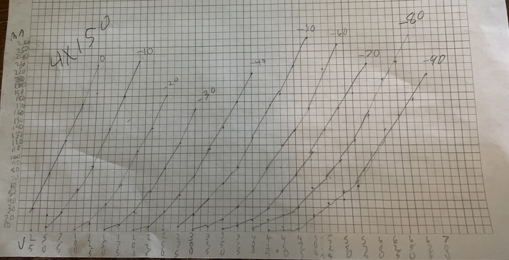

I have kicked around the idea of using some 4x150s that I have. Triode curves look pretty good. You may be able to use them with a little less airflow if you really do not need to run up to 250Watts of plate dissipation. Considering there is no supressor grid, you can expect to run them as a triode to a fairly high voltage without worrying about the screen voltage limits. That limit is really for the case where the plate swings below the screen voltage and causes high screen current.
Also you would need to obey the 30 second heater warmup time.

My fault, of course, it's a screen dissipation rating of some mere 12 watts. I won't use them in the way Gerrit suggested, because it would mean triode operation with restricted output power in comparison with a 6BQ5 operated as a pentode. Not too economical.
A pair of LS50's can give an output power of 120 watts when operated in class AB2.
Best regards!
