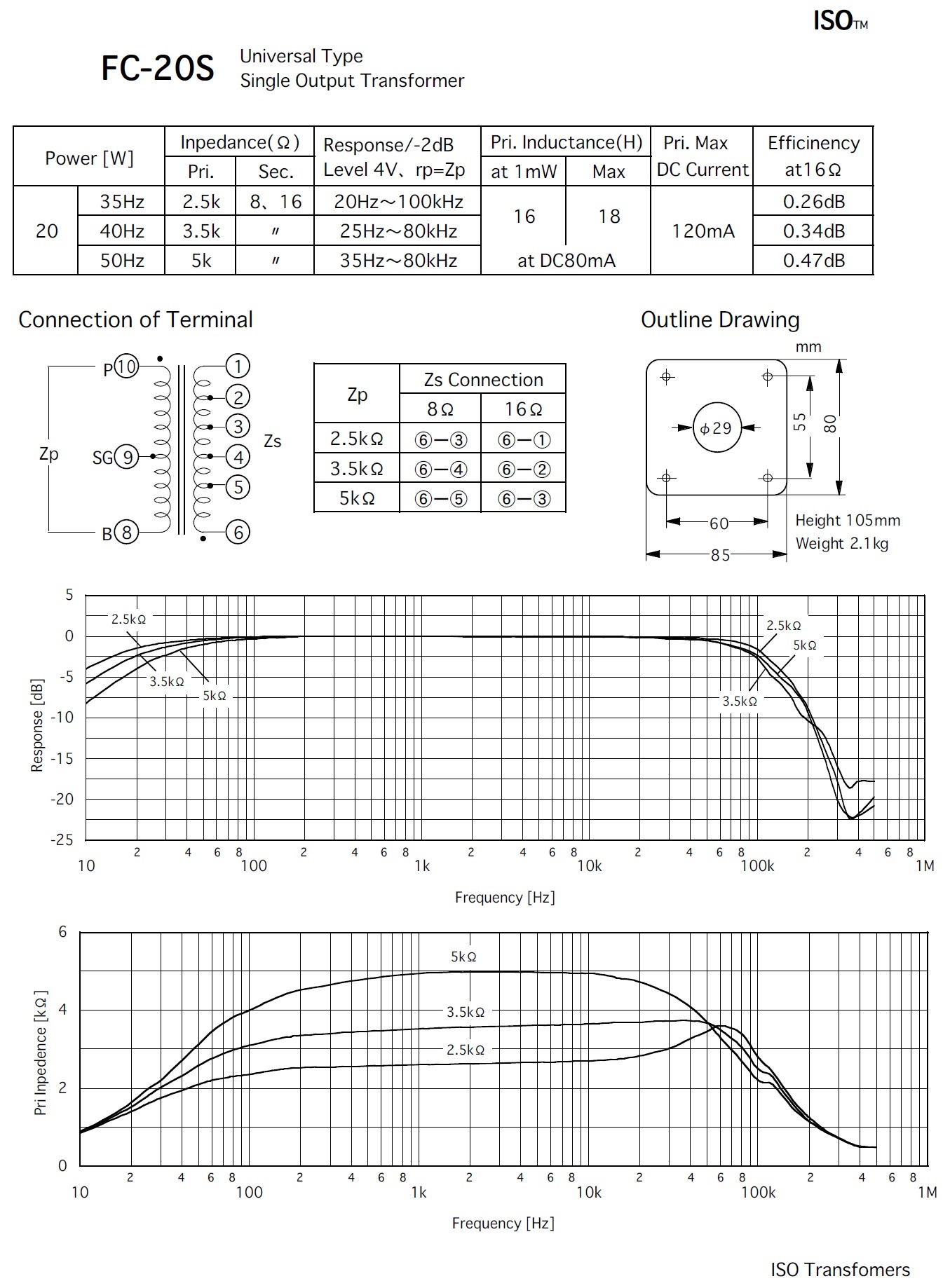

ISO FC-20S is a 5k 80mA transformer. 80mA is relatively high current for this small core, at 5k load. Inductance is 17H only, which is fine for 2A3, but not for 45. This makes the low frequency behavior not so exciting at 5k. You can see the impedance of 5k, becomes 4k already at 100Hz. At the Ri of 1400…1800 Ohms of the tube, the output voltage will not drop so drastically, but it will. And from there it starts to drop.
This transformer fits better to 2A3 than to 45. With 2A3 you need less inductance, because we talk 2k5 only, and moreover the tube is only 700 Ohms Ri.
Lundahl LL1663-50mA is 5k as well, but it has 34H, so it will work better. It will give the same drop at 50Hz, as ISO FC-20S has at 100Hz. ISO has also transformers with more inductance, like the FC-40-5S, but this is a 40Watt type, and it’s much too oversized.
A solution would be, ISO builds an FC-20S with 50mA instead of 80mA. That will bring up the inductance up to 27H, and impedance curve improves a lot. All this needs is another air gap.
it is not a easy job to work on this project..
It requires your help.. to make it prefect and afforable
You know there is no prefect solution...It also involes a lot of trade off (price and sound quality)
At this time, Hashimoto H-20-7U and Lundah LL1663 will work ok with this project

Here is the update for the OUTput Transfomer
ISO FC-20S -> WE need IOS to lower the current
H-20-7U -> will not modfy the opt
Either ISO or H-20-7U is imprefect for 45 tube application unless they can modfy the opt.
I taked to Lundahl Last night
it seems that LL3720 is a good match. Mr Lundahl will make a 5K version for this project.
https://www.lundahltransformers.com/wp-content/uploads/datasheets/3720.pdf
From Lundahl
We are developing a new output transformer, LL3720 (6k : 8 ohms) specifically for single end application.By applying some tricks when winding the coils, the capacitive coupling between primary and secondary sections are minimized, which results in a better high frequency response. The transformer is suitable for triodes with plate resistance between 1 and 2 k, and thus matching DC currents from 30 – 40 mA up to 70 – 80mA. A data sheet for the LL3720 will follow shortly
