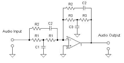

Dont suppose you have a photo of what a LT looks like assembled?
i just had a look at the LT calculator online as it was readily available. the Caps and resistors is there any recommendation behind picking them? ie 250v or 400v and 10w and 5w etc.
THe triangle configuration confuses me a little as well, as it goes from positive from the amp, to negative, then splits?

The triangle is a circuit symbol for an opamp. The zigzag lines are resistors and the two lines capacitors. The other lines are the connecting wires, or traces on a PCB that link everything together.
Google opa2134 and look at the datasheet for an opamp. These aren't passive devices. They need a power supply. Or NE5532.
LTs only work with sealed enclosures. When designing the component values make sure to keep the resistor values low to minimise noise. Say aim to keep them between 500 and 10,000 ohms and size the capacitors to fit.
Right, I would never have guessed the opamp. Might be best I Photoshop up the parts and how I think they sit and get power and post it to see if I understand correctly.
