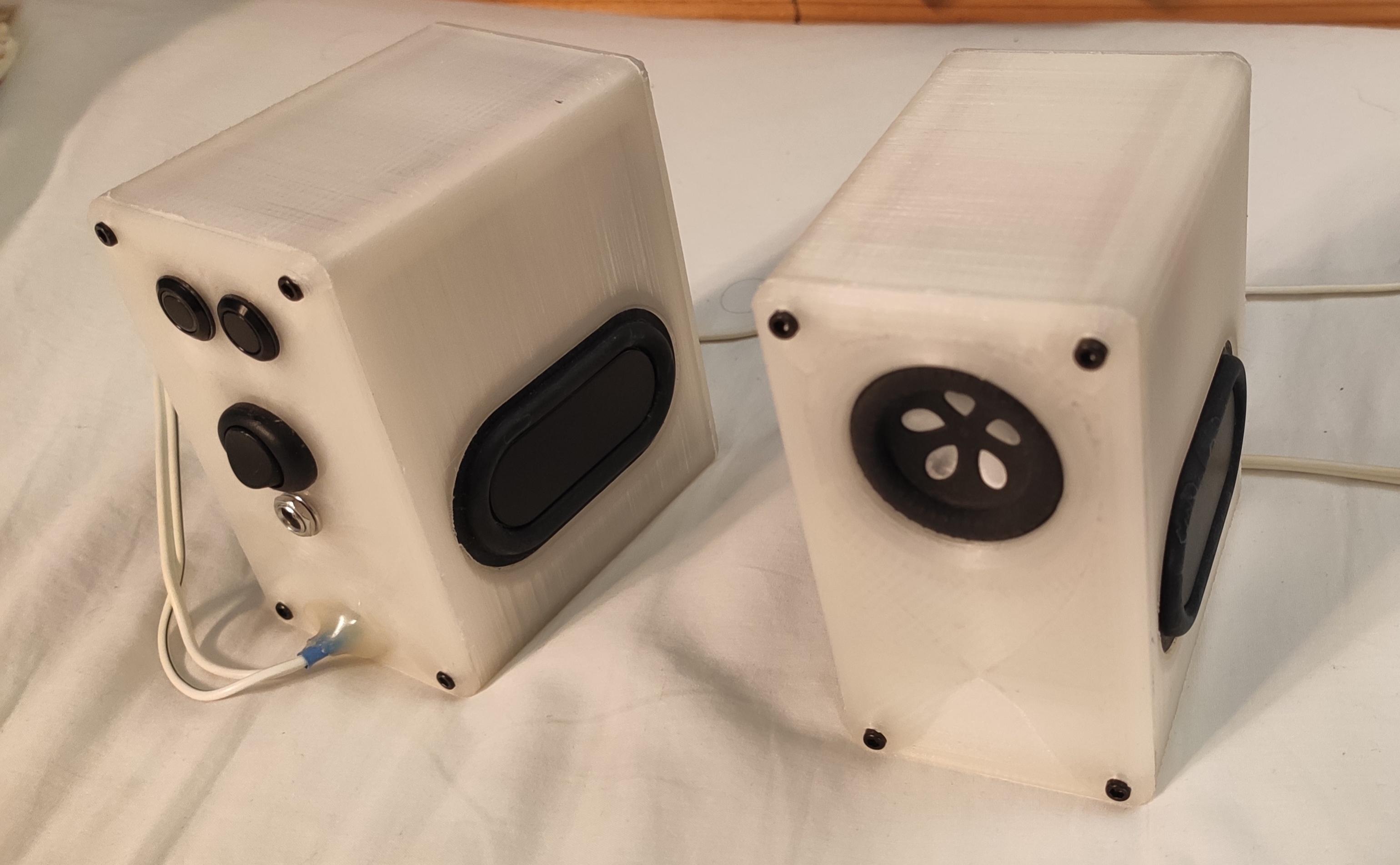

Attached is a picture of my Bluetooth W1-2121S speaker. As it happens I'm using them right now with my tablet to watch Netflix.
Hey mate, in your W1-2121s build did you use the PUI PR? Trying to model them in WiniSD at the moment but its missing the XMAX and VAS parameters for me to do it properly.
