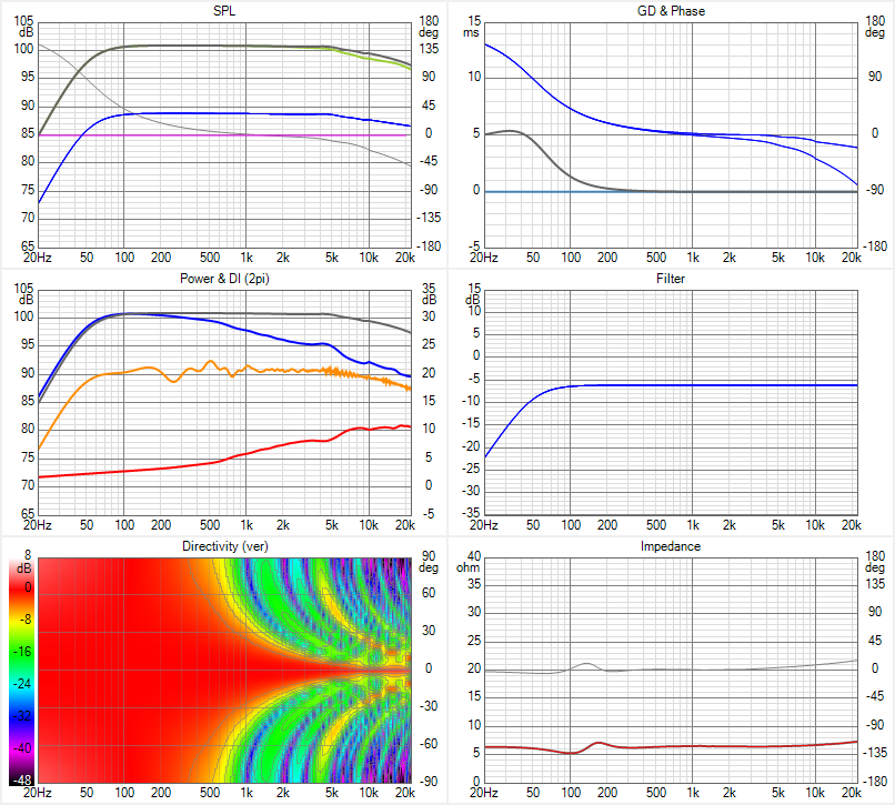

Starting baffle step compensation
1.7mH (drivers wired series/parallel approx 5ohm, pretty flat), that was a big help (with resistance around it).
Resistive pot (l-pad) varies from 2ohms (not enough) to 8ohms (way too much) between 2 of the leads.
Somewhere near middle, I'll repost when dialed in (to my subjective ears anyway lol).
I'm hoping 4.5ohms as i have 2 mills resistors that are that value.....

Simmed with an EQ-ed flat TC9 series/parallel with conjugation network but that won't be much different...
At the center height it will counter a rising frequency response but it will drop fast once you move up or down...
Sweet spot is about a foot vertically at 10' away.
But not bad at all 2-3' above that (sit/stand test), you lose some highs, not as much as turning off a tweeter.
Better vertical dispersion than an 8" full range and much wider dispersion also.
15' away, not a huge difference sit/stand.

Typically I use 1mH for 8ohm and 0.5mH for 4ohm drivers. Typical 4.7 to 6.8ohm resistors seem to do the trick. 3.3ohms Will give a little more presence.
