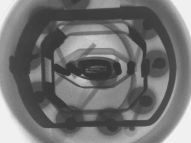

I have XRays of several 6BQ5/EL84/7189 types.
All but one have proved to be true Pentodes.
My Mullard 7189s are Pentodes for sure.
The exception: RCA 6BQ5 was a tetrode.
Looks maybe like 6AQ5 guts inside...
I've never seen an RCA branded 7189, can't
confirm or deny any rumors about that one.
http://www.diyaudio.com/forums/tubes-valves/130597-grid-screen-alignment-x-rays.html
There is no alignment of screen and grid,
yet it has a beam former. So is RCA 6BQ5
a true "beam tetrode" or not?

Great picture!!

RCA beam 6BQ5 for whatever reason, G1 and G2 are neither the same pitch,
nor shadow aligned in any way... Visit the XRay thread, got pictures proving.

Papers are papers. I own this tube and prove w. XRay photos.
Regardless RCA theory of operations may teach us otherwise:
Grids in that particular RCA weirdo were NOT wound of similar
pitch. Not even related by an integer multiple...
I suspect to have curves more similar to real 6BQ5 pentode
there may have been no choice but the pitch RCA abused?
This was RCA attempt to clone a popular valve and evade a
patent, not to design a new theoretically ideal beam tetrode
from scratch...
Say one thing, but do another. Some "rules" got bent...
