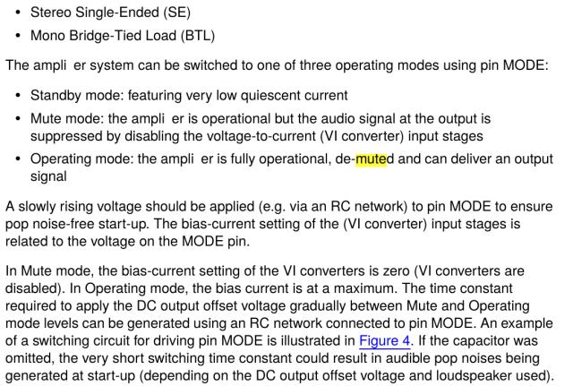

Don't work. I can mute by connect mode to gnd and then no noise. I now have mode pin to 800 kohm to 47uF to gnd. This should give me 30 seconds, but i doesn't and still noise
Are you using TDA8924?
You mean you can hear permanent noise if running in mode "ON"?
Measure the Voltage on pin "MODE" to signal ground. In mode "ON" it should be > 4V but not more as 5.5V

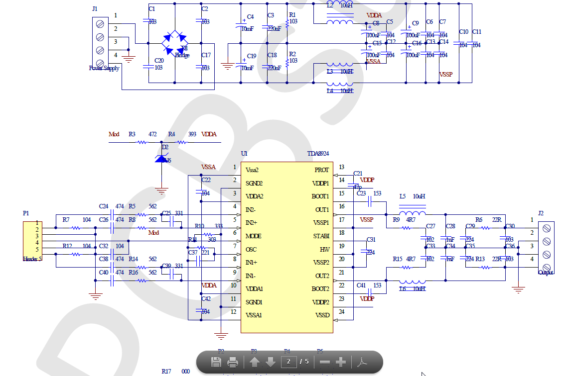

TDA8950th - the schematics from connexelectronic is the same for all TDA89xx - at least when I bought it.

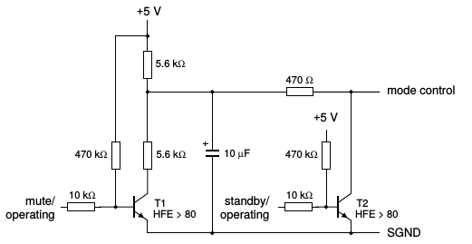

Attached the original mute circuit from datasheet. I have omitted the "standby/operating" switch. If I turn on the power, my TDA8950j circuit goes directly into mute mode. No noise, no click.
Try to use the attached circuit to control mute/operating if it makes any difference.

I can mute, If I mute no noise no click no hum. As soon as I go into operating mode (just a wire to gnd = mute and lift the wire = operating mode) the noise is there for few seconds and then everything is normal.
If I need the curcuit I would say the connex module is defect. In newer revisions he states that a RC timedelay is needed on the mode pin, so I really hope I can do with just a resistor and capacitor. I have send a mail to Cristi yesterday - so hope for an answer soon.

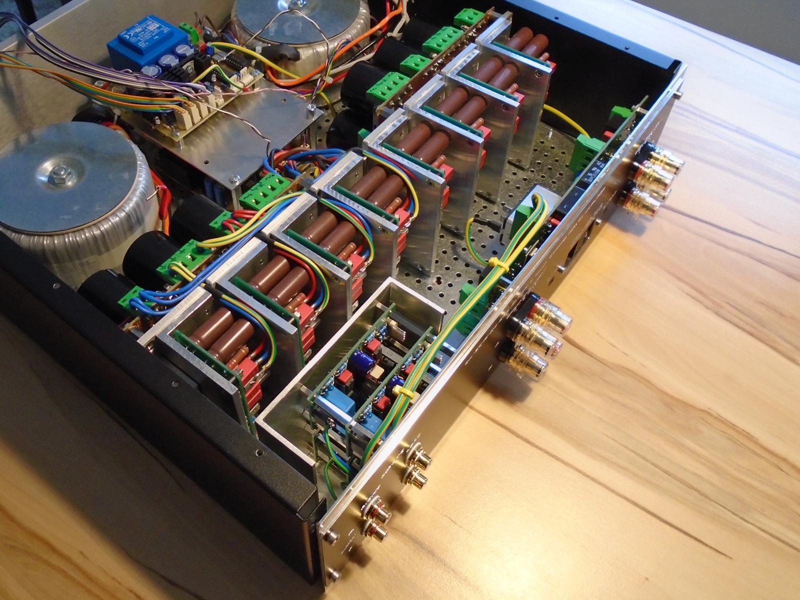

Rebuilding 4 channel class D amplfifier using IRS2092 modules:
... slow progress, but progress ...
Currently I'm in the process of removing TDA8950 modules and replacing them with the brand new "Class D LiteAmp" modules from Markus AKA ChocoHolic (see link above).
BR, Toni

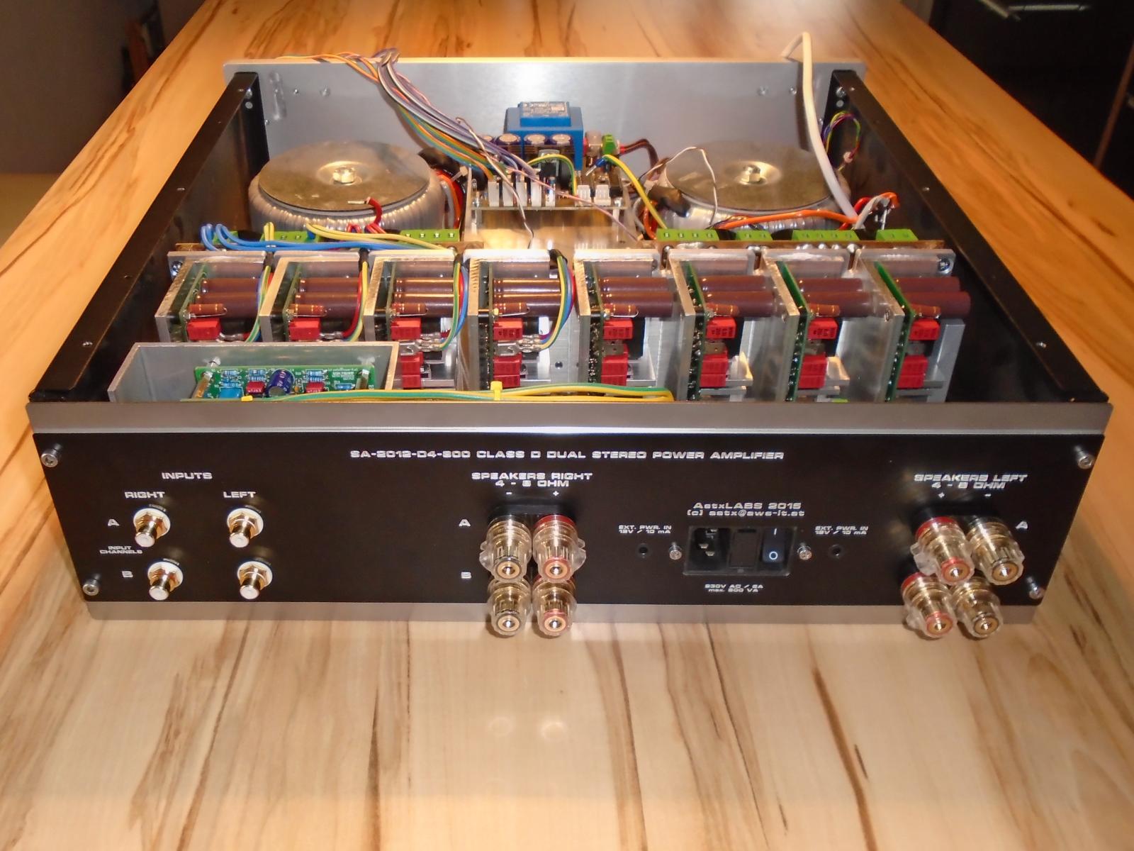

The TDA8950j has definitely a THD problem in the 5 - 7 kHz range which can be heard playing special audio material e.g. piano music.
I'm currently in the process removing the TDA8950j stages and replacing them with IRS2092 based bridging amplifier modules.

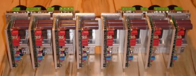

- 4 x BTL 300W/8R - a TDA8950j based 4 channel power amplifier
