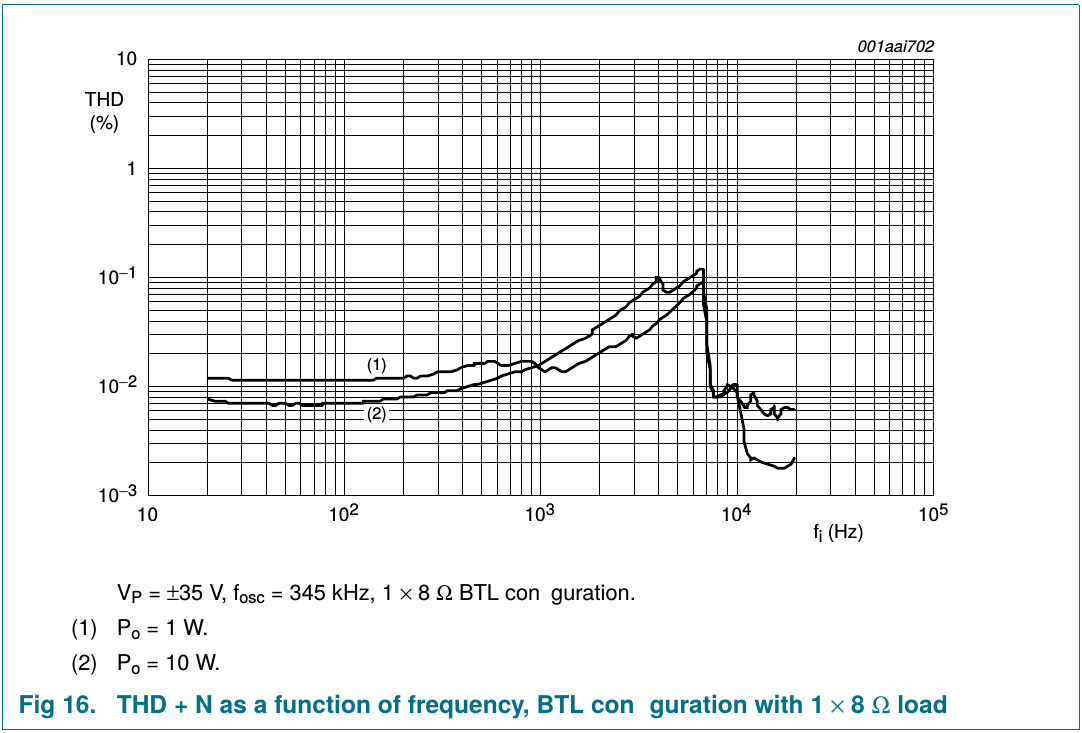

Indeed it may be hard to detect the distortion errors as it is around ~ 0.1% from 4 - 7 kHz but if your speakers are good and your ears are trained you will hear it.

Is this so much better
yes - nearly 20 dB better at small signal level.Is this so much better

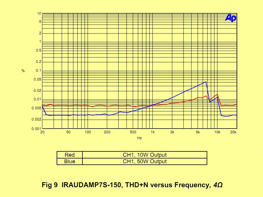

yes but it's 0,01% vs 0,1%. I do hear some artifacts in this region, but for me it's hard to believe that it should be 0,1% distortion in a quite narrow band.
Referenced to what?this is better . NewclassD
THD values above 7khz are meaningless as there are too less harmonics left in the audio band to measure...
IMD results using 19/20k or 13/14k test?
you mean you can hear 0.01% distortion? 😉yes but it's 0,01% vs 0,1%. I do hear some artifacts in this region, but for me it's hard to believe that it should be 0,1% distortion in a quite narrow band.
It is strange as the THD goes a little high at 6kHz or so, that is why I was mot initially worried about it. I know I will be shot down in flames but even with its "high" THD you should not hear anything at those levels.

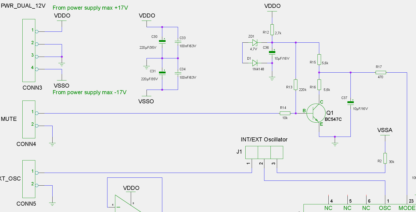

astx: Have you any delay on mute pin? My connex modules produce noise until they have settled (ca 5 seconds). Cristi from connex sugested 100 uF on mutepin to ground, but it does not help. I have tried 480 uF - no luck either.
The mute delay is controlled by a microcontroller and is configured for a delay of 2.5 seconds. There is absolutely no noise or click or pop hearable during mute-phase. Attached a partially schematic showing the mute circuit. The microcontroller is connected at port MUTE and provides TTL level signal.
As you can see I'm using 10µF and a 470R resistor to TDA8950j MODE pin.
The capacitor will be charged/discharged using 5.6k resistor providing a smooth voltage change on mode pin.
