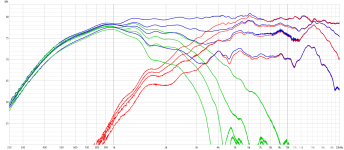

This a quick measure I did tonight. Not precise angles but they range from 0deg to around 70deg with roughly an even angle in between.
Crossover is 2700khz LR2, mid hp is 500hz. Mic at 52cm from a point between mid and tweeter.
Blue = both mid and tweeter
Red = only tweeter
Green = only mid
I think the stock T25B grill mounted in the waveguide is causing a bit of roughness in the tweeter response from 4-6k up but it's a price I'm willing to pay. I want to make some grills for the mid domes as well.
