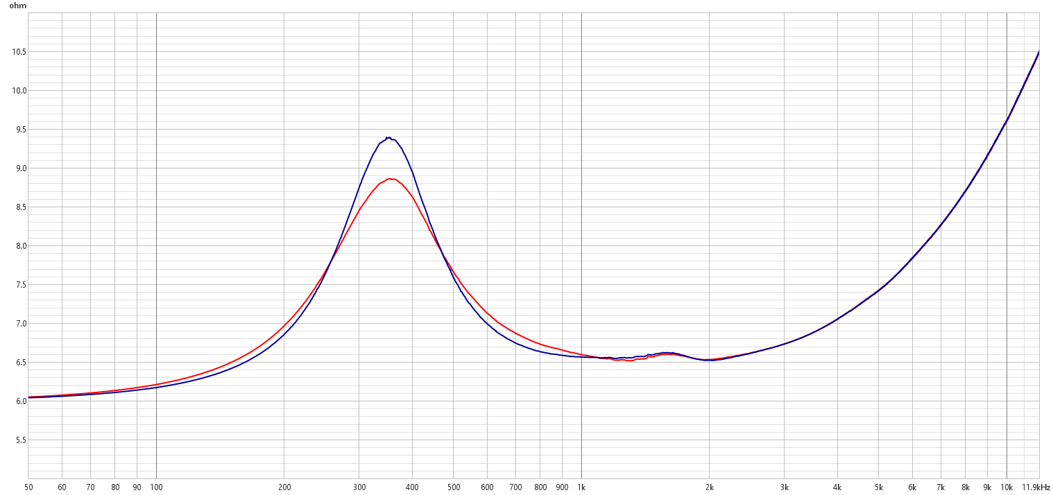

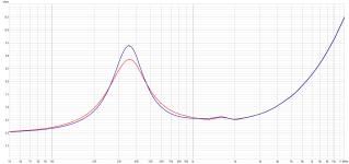

Here's an impedance measurement of both domes in an enclosure that Profiguy designed, I think it's around .35L? it's a perfect fit onto the magnet!

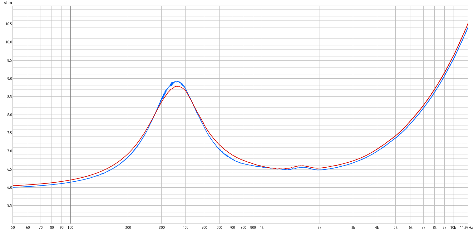

The above is fully stuffed(not tight) with rockwool and that's how I'm currently using them. The one below is one dome either full stuffed or half stuffed. Not sure what option would be better really. I could test more options.
Blue is half stuffed.
Here's something you could try. Add padding resistors to the tweeter. Off the top of my head, I'd suggest 10 ohms in parallel with the tweeter, and 2 ohms in series before the 10 ohm. This will smooth out the impedance. It helps with some tweeters and passive x-overs. I'm speculating that it might work in an active as well.
