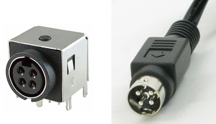

I've been looking at 4-pin power DIN as a potential solution for this. Hoping to get some opinions on it.
  • Designed and regularly used for DC power delivery
  • 7.5A per pin, 48V
  • Complete overmolded cables with the same electrical ratings are available (a plus for me)
  • Right angle PCB mount and panel mount versions are available (a requirement for me, most others here probably just want panel mount)
  • Optional shield
Anyone have experience with these or thoughts to share?
