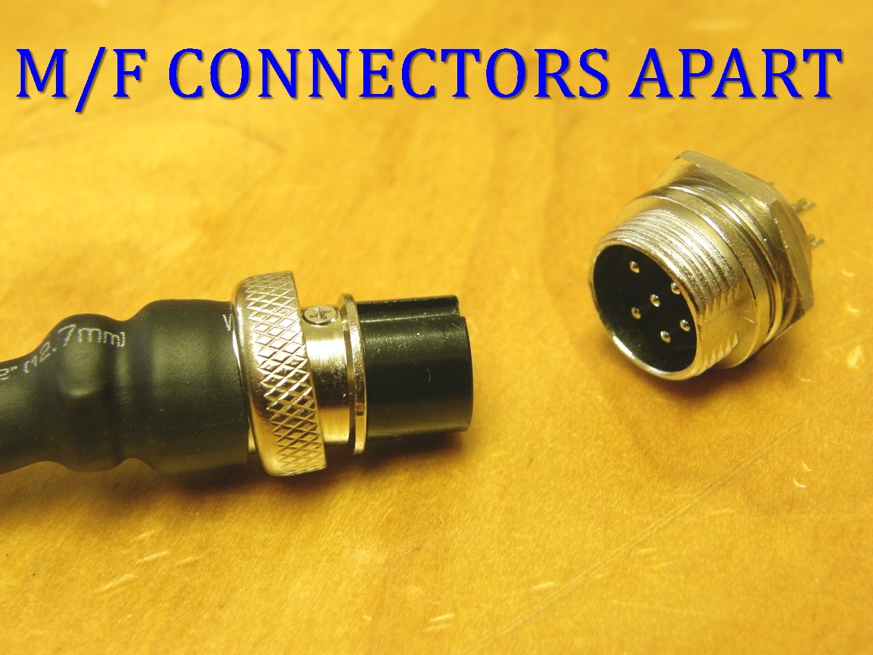

I get aircraft 3-6 pin connectors just because they have a good grip.

Thank you. I would much rather solder than crimp, so we can maybe exclude any crimp types.

Personally, for the highest reliability using connectors, I would use circular connectors,
with two or three pins/wires paralleled for each connection. But "proper" crimping is still
more reliable than soldering.

Try and get the male panel mount jacks and the female of whatever connector you decide on. That was there is no chance of getting shocked if the supply is on and the cable unplugged. It’s almost idiot proof! You can look for surplus Amphenol or similar mil spec connectors with screw threads to securely attach them. They are often brass bodies with gold contacts. Check Apex Jr on eBay for some.
