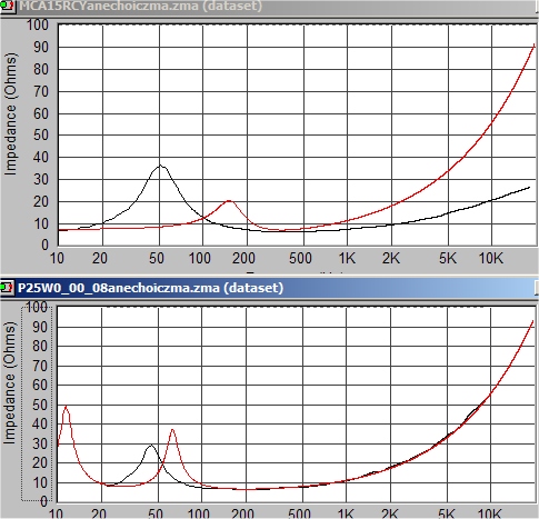

I'm sorry, I do have the zma files. Manuf's data in black, red = the MCA in 1.5litre closed above, or P25 in 40 litre vented below. It looks like the MCA resonance has moved up to about 160Hz? I'm wondering if changing the MCA box to 4.3litre vented would bring its resonance back down, and if so, by how much , I wonder? thanks, grant
Inductor,
I think our posts 'crossed', sorry. A vented mid-box is unnecessary and a 1.5litre closed will be ok - thanks! I haven't bought any crossover parts as yet. My last xo was just an idea that needs refinement. I could be wrong of course, but I thought a larger mid box would take the MCA lower and enhance the P25's bass a bit?

Mid box volume - you obviously dont need the lowend from the mid, BUT the different rolloff should be compensated fore in xo
Be aware that impedanse ressonanse peak with a higher frequency will interfere with xo behaviour
Some few designers insist to have a LCR "notch" on this ressonanse peak - I have tried it too, but didnt like it, so I dont do that, but you will have to play with xo to get a smooth rolloff
But I still have LCR on woofer and tweeter ressonanse - but my next speaker wont need that

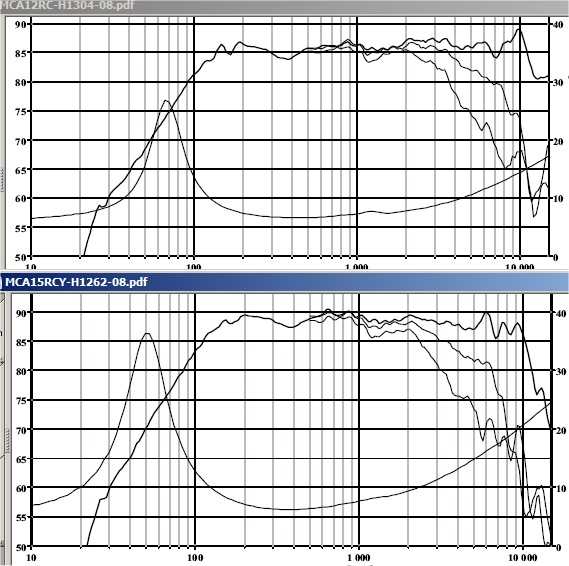

the difference, grant, is that with a 12 Mid you go up in the xover, the speaker is smaller in size and the frequency goes up. With the bigger 15 Mid like you have the resonance frequency (Fs=51Hz in Free Air) is lower and you come down in the xover frequency.
1,5L -> 160Hz
4,3L -> 105Hz
Free Air -> 51Hz
Now you can play with the xover frequency 200/300Hz if you get the Fsc of the pair (Mid speaker/enclosure box) out of the way. But as you go down, the sound improves and the price of components, volume of the Mid enclosure and size of components and speakers goes up.

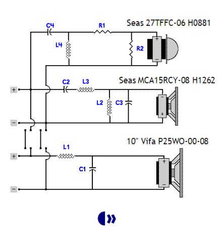

Grant, I checked your xover and I have difficulty finding a place for a 6.5 mH inductor in your woofer filter.
I designed a new xover for you. But before I would like to know how do you feel about that. I would like you to give a try, what do you think? The tweeter filter is a 2.order and has a small value Lpad. The Mid filter design is a bit different and also a 2.order, the mid is connected in inverted polarity (180º phase). The woofer is a more difficult outcome but I would try a second order filter with a 3.9mH instead.
3-Way Xover points at 350Hz and 1900Hz.

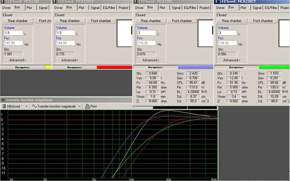

Hi Inductor, Thanks! re your MCA12/15 comments.
I've been 'playing in' WinISD with these drivers in closed boxes of 1.5 and 3 litres. Please see the attached. I hope I have input the parameters correctly? The results seem weird to me! The MCA12
'blue graph' in 3 litres has the best bass extension of the lot! I can't understand why the MCA15 is 'higher' based upon what you kindly advised? Did I make a mistake somewhere? Thanks, much
appreciated, grant
appreciated, grant
