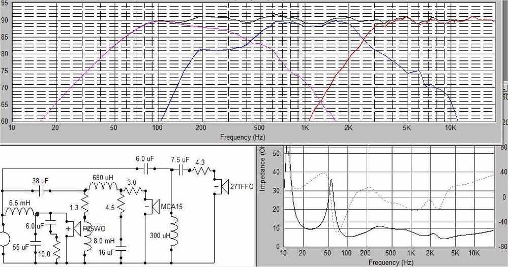

Simmed FRC data was for my existing boxes / baffles. My first xo attempt is attached. The xo is a mix of Troels PMS / 3WayClassic and my own tweaks. Parts count is high, unfortunately. Also, an LCR trap for the mid was required to get this response. I'll look at Sretens series/parallel mix later. It is of course open for critique and any comments would be most welcome as usual.
The Z-driver-offsets were from Roman B at 10 feet - I hope I did it right in SW? XO-points are about 440 and 2900Hz. I couldn't get 440 down to 290 with a smooth response. Any comments most welcome please. But I haven't looked at impedance/phase just yet. thanks and cheers! grant

Looks fine and should sound ok - but still dont understand why you reverse polarity on tweeter
May I suggest small adjustments to try, may work, may not
MID
try and make 43uf series cap a tad bigger (47uf)
and 600uH series inductor a bit smaller
Try a series resistor on 16uf paralel cap
I dont fully understand that you have both a series and parallel notch, and that you place them before filter - could you exsplain your trick
TWEETER
paralel 200uH, try a series resistor on it and maybe make it a bit smaller
BAS
Not sure its a good thing with the RC, 14uf/13R
Instead make 6.0mH series inductor a bit smaller
make paralel 58uf bigger (68uf ?), maybe with a series resistor on it
STANDARD resistor values - 1R2, 1R5, 1R8, 2R2, 2R7, 3R3, .... look up a catalogue from a supplier
Please Grant, try and sim with standard values, believe me it will sound better

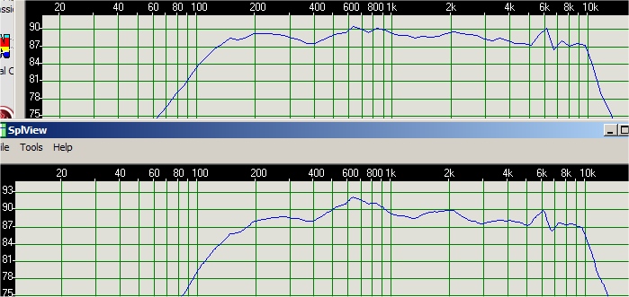

It looks to me that mids (and tweeter) were down 3db's on 3k.
Sorry I just came in and I didn't check the xover. I saw a lot of components there anyway.
Hi Inductor, Thanks for dropping in!
Yes, both the T and M 'in box' responses have a 3dB dip from 2 to 5K,
which is probably diffraction effect due to non optimal driver placements on the baffle. Too many parts I know! When I get time I'll try to sim Sreten's mixed series/parallel xo suggestion to see if it helps. thanks, grant

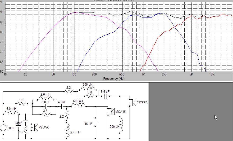

Hi guys,
I value your input very highly, but I do have a tendency to 'chop and change' at whim in the hope of discovering new things and better solutions. As a relative beginner still, I think there is value in
my approach....I hope. Unfortunately, I've not had as much time as I'd like to do much simming lately. (my mum just broke her leg). However, my latest, slightly more 'amp-friendly' and hopefully ok xo is attached. I really want to thank you guys..Sreten, Omni ,Tinitus and Curt (in no order) for your incredibly kind help so far!
Tinitus,
I'm sorry I haven't pursued your suggestions as yet. But I definitely will! I'm very thankful for your previous suggestion of resistors in series with parallel components! From the simming I've done so
so far (attached is my simplified latest) - it really does make a difference! Thanks very much indeed.
Re: "I dont fully understand that you have both a series and parallel notch, and that you place them before filter - could you exsplain your trick".......I'm confused too! lol. I just copied and modified 2 Troels xo's. So its definitely MY error, and I'm emphasizing *not Troels*! I'll look into it, asap.

Yes, and now I'm playing with a 3rd Order on the tweeter, hehe. Any suggestions please? Are you building a 3-way design?

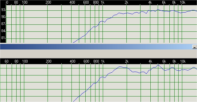

A very kind man called Curt (cc00541) in here did the did the box/baffle/diffraction simulations for me! His methodology is in this thread:
http://www.diyaudio.com/forums/showthread.php?threadid=96819&highlight=
Curt sent me the manuf's data for each driver and also the response in my box. The files are attached. The manuf's data is on top and the 'my box' response is below. cheers and thanks, grant
Many thanks! Yes the same drivers P25WO , MCA15 and 27TFFC (Fs=550Hz). I agree about the tweeter, a 3rd order on tweeter may be unnecessary as you say, but initially the response looks better than my previous 2nd order. However, I could very well end up with 2-Order on it.
The driver placement in the 32cm by 74cm box (non optimal for P25) is drivers adjacent , that is, minimum vertical separation (T on top, then M then W). Both the T&M are horizontally offset about half way from centre to the box edge. I think the placement has caused the diffraction problem.

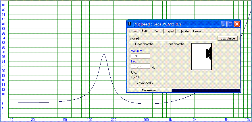

Also, do you know of the new resonance for the mid w/the box you mention of 1.5 litre?

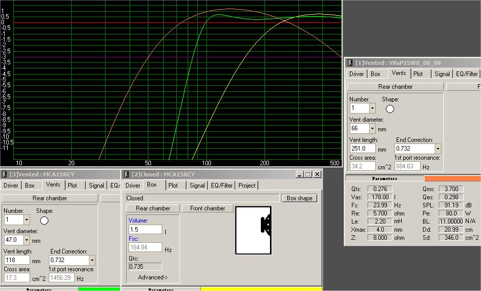

Inductor, Hi!
Just for fun, I tried WinISD again for my drivers. I hope I have entered the parameters correctly now. 'Orange' is the P25 in my existing 40 litre boxes (non optimal I know!), 'Green' is the MCA15 in a 4.3 Litre
vented box (similar to Troels PMS), it looks good to me. 'Yellow' is the MCA in the existing 1.5litre closed box that I was going to use. Yuck! - no bass extension. I think the 'Green' is the way to go....
(the P25 would need to be in a 75Litre box, including 4.3L for the mid-box, for best bass extension)....grant
Hi Inductor,
Re: * Interesting *, from my very limited knowledge I hope I have understood your question? I think what you are saying is that the Mid and Woofers Fs will change in the new boxes? This seems reasonable to me, but by how much I wonder? The tweeter has its own 'box' so I suppose its unaffected.
The P25 Fs is 24Hz and the MCA15 Fs is 51Hz - manuf's specs. So I just blindly accepted that a lower xo-point of 300 to 380? Hz would be ok? I didn't realise other factors were significant. I thought some
'octave separation' is what is needed? So maybe 4 octaves from the P25 Fs to give a ~380Hz xo-point? If this 'logic' is correct the MCA should be crossed at about 800Hz! But , to me this seems way too high?
Mr Troels G's PMS design, which I'm hoping to partially emulate ( albeit different woofers ), has a 3kHz xo for the 27TFFC/MCA, and ~ 360Hz xo for the MCA/woofer. I hope I haven't missed the point of what you're advising me to do? Your knowledge in this would be very helpful to me! thanks, grant

You said a vented mid... you don't need to do that because... well it is just a mid, not a woofer, and a closed box is all there is if you don't want to go "low" with your mid (like lower than 90Hz). That work you leave for the woofer and woofer box.
Second, the mid is about 160Hz Fsc, simulated with the help of WinISD, for 1,5L, in a closed box. I join here the picture.
