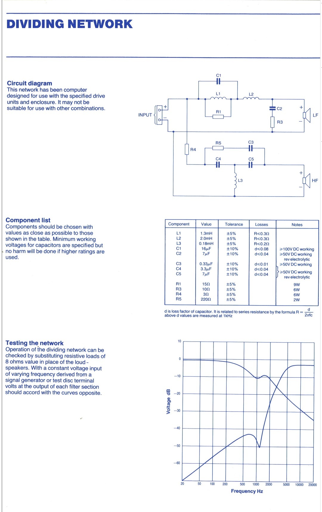

I was reminding myself about the KEF acoustic butterworth design:
This is the KEF R101 with 5" driver, similar to the LS3/5A:
377516d1382147610-kef-concerto-crossover-rebuild-kef_r101_crossover-jpg
This the KEF 104ab with 8" midbass:
377517d1382147610-kef-concerto-crossover-rebuild-kef-104ab-jpg
I am fairly sure KEF arranged the electrical slopes for a smooth 18dB/octave overall.
486597d1433396292-falcon-acoustics-5ab-crossover-5ab-t27-kef-cs1-electrical-png
I wonder if there are some errors in the values of the inductors. Please see attached documentation showing the KEF Constructor Series CS1 crossover. As far as I can see there are only some extra capacitors at the input reducing the lowest bass output. FWIW: The CS1 was using the B110 SP1057 and the T27 SP1032
