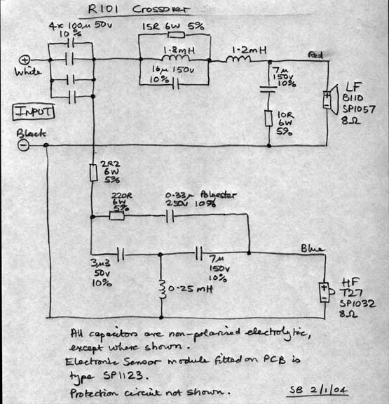

I was reminding myself about the KEF acoustic butterworth design:
This is the KEF R101 with 5" driver, similar to the LS3/5A:
377516d1382147610-kef-concerto-crossover-rebuild-kef_r101_crossover-jpg
This the KEF 104ab with 8" midbass:
377517d1382147610-kef-concerto-crossover-rebuild-kef-104ab-jpg
I am fairly sure KEF arranged the electrical slopes for a smooth 18dB/octave overall.

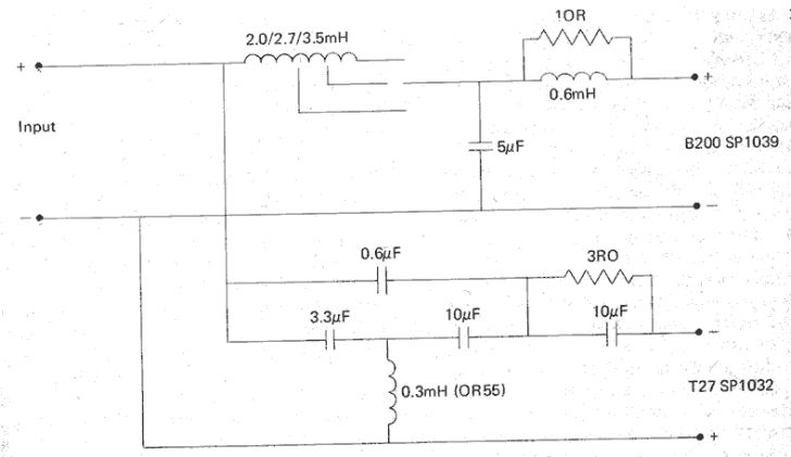

486597d1433396292-falcon-acoustics-5ab-crossover-5ab-t27-kef-cs1-electrical-png

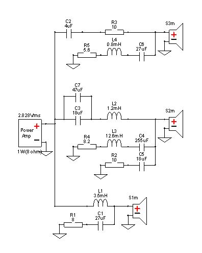

Mike, here's the crossover I referred to. The drivers are from an old KEF B139 / B110 / T27 kit in a TL box I have converted to reflex. I considered the T27 too fragile and having not a low enough fr to use with a first order filter, so I chose a PAE BC25SG16-04 as a reasonable and inexpensive tweeter for matching with the KEFs. The BC25 is ferro fluid damped and cooled.
The crossover is a basic first order with single element low pass (L1) for the woofer, two element bandpass for the mid (C3+7 / L2) and single element high pass (C2) for the tweeter.
The driver's all have far from linear impedance with both fundamental fr resonance blips and rising reactance with frequency. Without addressing these phenomena the crossover would not be terminated correctly and the slopes would be all over the road like a mad person's breakfast, as my mum would say.
The B139/system reflex alignment's resonances are far enough away from fc to be ingnored, but the self inductance of the driver is not. A Zobel network (C1/R1) corrects the impedance making essentially resistive in the octaves above the crossover fc.
The B110 unfortunately has considerable colouration and the impedance bump at resonance exacerbates the low end colouration by preventing the required roll off slope being achieved. A series network (R4/L3/C4) is tuned to exactly null the resonance impedance bump both in amplitude and Q, which corrects the amplitude response of the filter, and reduces the colouration. L3 is adjusted on test by adding or subtracting turns to centre the filter frequency. The mid driver also needs a Zobel (R2/C5) for the the upper fc low pass filter to work as required.
The high frequency driver also needs a series resonant circuit (R5/L4/C6) in parallel with the driver to null the driver resonance to get the desired high pass slope and remove the colouration at resonance. It also is attenuated with series resistor R3 to match the other driver's levels. It doesn't need a Zobel for crossover performance.
To derive the crossover, the on-baffle impedance and amplitude/phase responses were measured and converted to FRD and ZMA files for use in a crossover design program. The crossovers were then physically prototyped and tweaked in situ to optimise the slopes and crossover frequencies to get the desired performance.
The nominal crossover frequencies are 250Hz and 2kHz. The B139 is not very well behaved and the low crossover frequency is needed to mute its behaviour around and above 1kHz. Trying to get the B110 to work so low (at least in these legacy boxes) is also a bit fraught, and the best sounding compromise has a minor suck-out in the mid-bass.
The low pass L1 for the B139 is a 3.5mH P-core with a low 0.27Ω series resistance for good amplifier control of the driver. The high pass C3+C7 for the mid is a film capacitor in parallel with a bipolar for size and economic reasons. All of the other Cs are film, with the exception of C4, where the actual measured values of some nominal 220µF capacitors was used. Apart from L1 and L3 the other coils are all air core. The mid driver low pass L2 has 0.4Ω series resistance which acts as a slight attenuator that helps the balance.
The resistance of L3 and L4 coils in the two series band pass filters is taken into account reducing the values needed for R4 and R5 respectively, so low cost coils can be used.
One might ask: why go to so much trouble? The reality is higher order crossover are also affected by driver impedance anomalies and the crossovers will only work as expected into drivers compensated to appear to be resistive where important.
Many (most?) people don't realise that only a first order crossover (whether passive or active) cannot pass audio without altering how it sounds when the outputs of the filters are recombined - the output sounds different to the input for all orders of crossover higher than 1.
And finally a first order crossover has a flat power response which makes the speaker more room tolerant and the listening position less critical IMHO.
Of course the acoustic outputs of the system will not exhibit true first order phase and amplitude response, however I think this crossover implementation still does the least damage to sound quality, even with less than perfect drivers.
