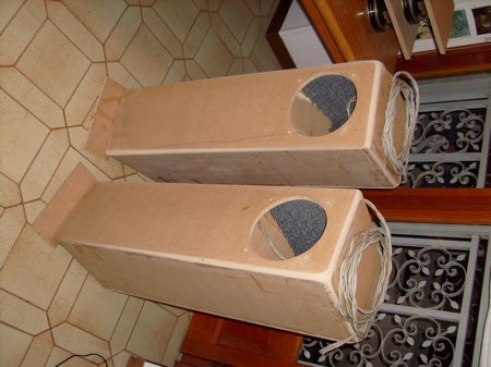

this is a photo to give you an idea, they are 90cm tall, the design was for any 8" fostex driver... i put a super8 audionirvana. it was working very bad, shy bass, and muddy everything...
then i removed the bottom, let it opened, and now the perform pretty well, i think down to 35hz with some corner loading.
any probabily a BSC is still needed, i don't think the AN are easy to accomodate in harshness... wrong choice for the t-amp i put them on.
btw. i don't think i'm gonna work on them anymore: spiralhorn surely works, and probably it's a clever design for small drivers (or even the 166). acoustic bass really is articulated and present...
but on some rock tracks they work so bad, that i think i'll take the two drivers on a simple OB and build a good sub below 80hz...

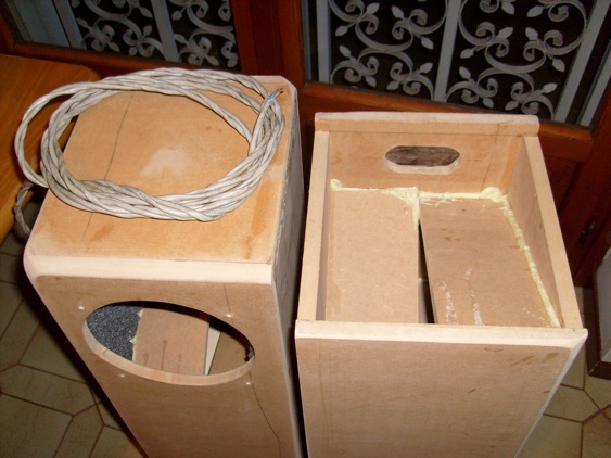

it's night here, and i just got home. but hey! i'm not that drunk to write such an english and post photos viceversa... i apologize
here is a photo of the bottom, have anyone any advice to give? what kind of loading should it be? considering it's firing directly on the floor? something like the BIB?
should i close them and tricl the firing ports size? to match what parameter of the AN driver? twin 3,5mm ports where in design for the fostex 206

so the fact was i used the wrong driver: i used a pair of AN super 8" instead of the fostex 206 this cabinet is designed around. at the time i'd got really no understanding of T/S parameters... with the bottom removed the AN sounded acceptable, but still with harsh treble and huge dips in the lower-mids (i think by ear).
one guy here on the forum tried them with succes with the fostex 206, but he had to use BSC for the bass to come out: compared to a 206 in a BLH it's not a great success...
i think they are rather complex. use at least some expanding glue to get the fins right... nowadays i really don't see the clue about the design. with all the great stuff from the frugel horn site, and designs like the solo 206 for the fostex or the possibility to go OB with the AN. keeping sensitivity/avoiding BSC.
furthermore many said the spiral horn to be not more than a quarterwave. a strangely (read bad) designed one. perhaps the sheets from MJK being only 25$ you can have some fun with designing one and spend less money/time with those difficult fins 🙂
certainly the spiral-horn deserves better investigation than mine. but then do it only if you already know very well what to expect from the drivers. i.e. only if you already have a good cabinet they are playing in.
let us know your discoveries if you choose the hard path..

regarding a front-firing version i mailed the author but had not replies, maybe someone can help, but one thing i can say is the bass could become really big with rear-firing corner loaded on some discs/passages.
reagarding the hole, mine (in the photos) was the size of the project, just rounded a bit. if you dive into the japanese site, you can see he came with the result that a costant twin hole of about 3cm is working better on every cabinet, regardless of the driver. also check out for the smallers 8" versions, the all seem to have same frequency response. now such a response from so a little cabinet could be an achivement.
but again don't do it if you don't know what quality to expect from the drivers, to know which a simple test baffle is a funny way to know.

again with the AN in the 250 i also tried some stuffing behind the driver to accomodate the high-mids and highs, i though standing waves in the small chamber could be the issue. but nothing. be careful for long listening of the peaks, the one at 15khz is really high, can damage your hearing. indeed i think that many fullrange users end up accomodating their ears to the drivers, a sort of cybernetic take at BSC 🙂
for the price of a pair of baffles and two holes you should really try out the mid/highs performance of the AN when mounted OB
