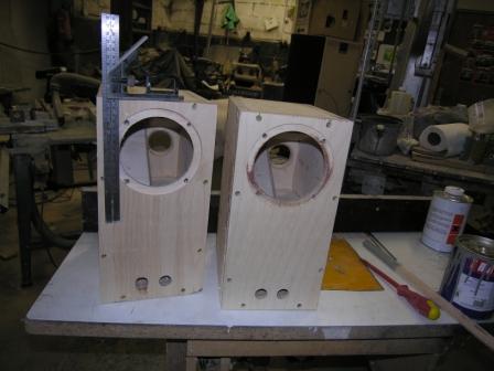

ANyway, more impressions will be posted in time - here are some pics for you visually orientated people
First off the cabinets glued & screwed without JX92S drivers installed - a1 foot rule in the pic gives an idea of size of these diminutive cabinets
I will post some more later today - have to run now

So if you saw the link above you will see the various pics of the build. Is it hard to do? Well I didn't really think so - in fact because they're quite small they were easy for a fella on his own to do. Just follow the plans carefully and dry assemble first to make sure all the internal bits line up OK. Its very economical to build - I only used about 1/3 of a sheet of ply along with some scraps that I had from other stuff. You'd cut, assemble and glue in an afternoon given a table saw, router table, drill press etc.
They are very rigid and heavy when assembled. I rebated the jordan drivers which should help to seal them well and give a neat look. We tried them last night from a variety of amps and material and they held up very well. No sign of that hard glassiness when the passages get complex eg rock. Very smooth all the way up and the bass is very very good. No crossover or BSC was used, nor did we add any stuffing to the cabinet. I did try these with the FE127 - only quickly one night - and I got the same bass response but there was that kind of "tunnelly" sound that jkeny mentioned above. Thats something though that a bit of stuffing might really help with.

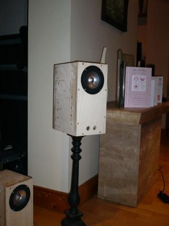

Thanks Fran, it's really a beautiful build - my only dilemma is what finish colour to go for - I initially liked the idea of gloss black but I also like the contrast of the black surrond of the drivers on the existing front baffle!
Here's a photo -any advice - a choice between black or cream or a combination?
Any suggestions on a colour scheme for these speakers?
I was thinking of almost a piano black all over butI feel the drivers would dissappear into the black background and I quiet like the modern look of the drivers and would like to emphasise them in a tasteful way
The speaker stands are black solid cast iron candle stands (very heavy although they don't look it)so they have a kind of rustic look!
Any thoughts?
