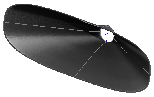

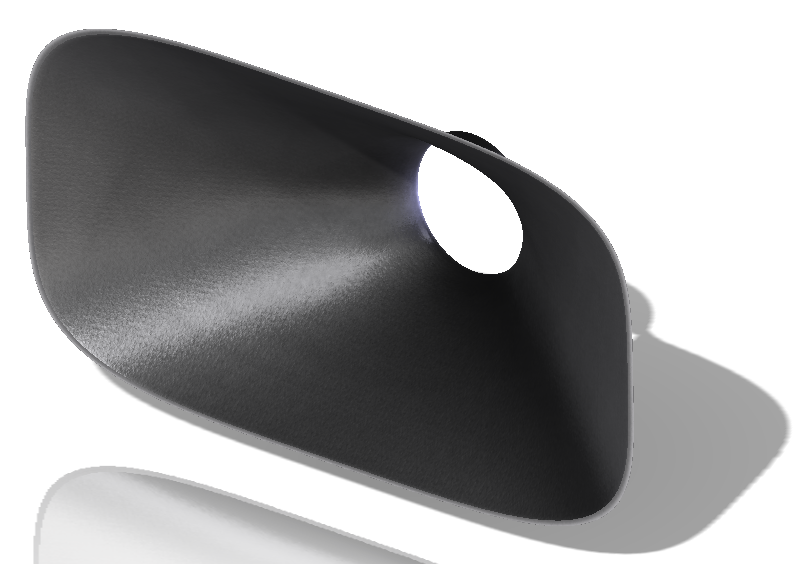

Ok, I got a generic and easily updated Solidworks model to work. I used equation driven curves to create the shape and linked the constants in the curves to global variables so it's easy to update to a new design, simply open the equations dialog and type in the new values. I tried to keep the nomenclature the same as what's been used before so it's obvious what is what. Inputs are the throat and exit angles, throat radius, total length, and exit super ellipse shape (N). I didn't model in anything other than just the waveguide shape as a thin feature loft to keep it a nice start point for a design.
Oh, and if anyone tries to do this on their own from scratch, in the loft dialog, the "guide curve influence type" needs to be set to "global" or the shape between the guide curves will have a larger radius than it should.

Alright, would you say that you used a similar approach as I did? So the profile is OS at the two horizontal and two vertical lines and approximately correct for the rest of the surface? Is there a way to inspect the actual angles? I have found that I need a way to control the throat angle as it doesn't perfectly follow the set angle between the four control curves.

Oh, sorry, I should have said. Yes, I used the same method you did, just in SolidWorks. SolidWorks is a very precise modeling software. Where the guide lines go, the solid follows them exactly. One thing I had to do in order to get it to work with the desired throat radius was to calculate an offset for the curves to get the beginning of the curve to be exactly on the radius of the throat. The beginning of the curve (x=0) is sqrt(B), which is off a little bit.
I can inspect the angles any way you want. Just let me know how, I'll post drawings for you. The way I was sure my shape in between the curves is good was to look at the case of N=1 and horizontal and vertical angles the same, so every cross section should be round. I also looked at the shape of the curve of the solid in a more typical angle case as I rotated the part. No really solid criteria for evaluating in that case, but it looked right to me.

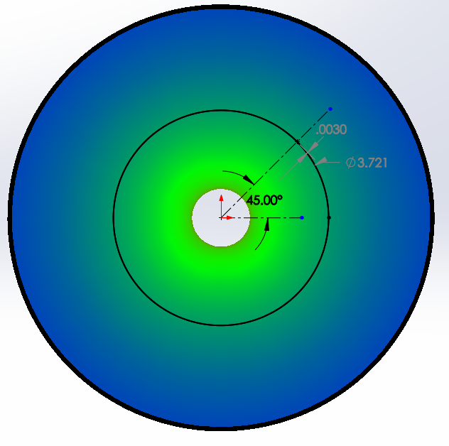

I don't mistrust SolidWorks, but it has to do some assumptions on how the surface looks like between the six guide lines. I'll post some pics of what I mean from Creo when I get back to that computer (monday). What seems to happen is that for a superellipse that is closer to a rectangle than an ordinary ellipse it stretches the entire curve slightly. This causes the throat angle to be exact at the guide lines, but slightly too large between them. I also did the test with the waveguide I printed which is round and has n=1:
I used Inspect -> Slope, but I'm not sure what the numbers are saying. (If someone has experience with Creo/ProE, please explain!)

Yeah, I had seen a discrepancy with the surface in between the curves. It's hard to define a surface like this well without more profiles. I went ahead and looked closer, using a similar curve view in SolidWorks and I see I didn't look close enough before. I also made a small modification to the order of the guide curves and got a slight improvement, but it's not perfect. So I took the center of the waveguide (should be the area of the worst error), made a profile of the surface (which should be round) and I drew a circle intersecting the profile at the horizontal (where a guide curve controls it). Then I made a pair of points at 45° along the profiles and measured the distance between the points, giving the max error of my surface. The result for the model I'm using (which is arbitrary, I don't have anything better to go on. Did I miss your parameters?) is a circle at a diameter of 3.721 and an error of 0.003. Image of the measurement is attached. I'm concerned this will be worse without N=1. I'm looking forward to how to measure that angle. Is it as simple as checking the location of the surface where the tangent line angle is equal to the throat angle? And that should be at the "X throat"?
