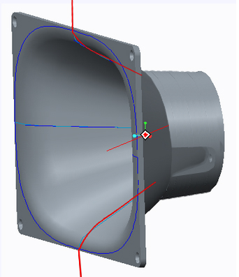

I didn't want the file to become too large to fit here so I settled for what you can see. But sure, for a fair test of surface finish from a printer it should be a higher resolution stl, I'll work on it 🙂I am a bit baffled by it looking fine. You cannot see the creases every 8 degrees or so in the waveguide, or that you consider them unimportant, or that you believed they come from printing in layers, or something else?
An STL file is simply a list of triangles. Triangles have a flat surface. In order to approximate the curved waveguide with triangles the triangles need to be small enough for their flat surface not to show. Using too many triangles on a flat surface only makes the file size bigger than necessary but not using enough triangles on a curved surface will degrade the surface finish.
There will be a tolerance somewhere in whatever software you used to transform your smooth solid model into a bunch of triangles for the STL file. Reducing that tolerance substantially and rerunning the print is likely to be a fairer test of the surface finish of the printer.
This is true even in the non-free version I'm using (Creo Parametric 2.0). The settings I used was about a factor 3 smaller than the default settings. It's good that we don't need a "smooth" surface as that takes a lot of work, thanks for the info 🙂Creo Direct free version does have a window/dialog for .stl resolution - doesn't seem to remember your changed settings though and you have to find, reset resolution for every export/save

In Simplify3d, the software that Onni is using to translate the stl file to g code which are the actual printer vectors, there may be some additional processing going on there that makes the print smoother. It depends on the resolution setting. But the stl file is not wysiwyg - it really depends on the quality and accuracy of the post processing software. I look at my typical stl files (generated by SW) and it looks grainy like big triangles but when previewing toolpath, it obviously makes it smoother.
I understand what you are saying but I don't agree. Simplify3D doesn't seem to do any smoothing (at least not how I have it set up):In Simplify3d, the software that Onni is using to translate the stl file to g code which are the actual printer vectors, there may be some additional processing going on there that makes the print smoother. It depends on the resolution setting. But the stl file is not wysiwyg - it really depends on the quality and accuracy of the post processing software. I look at my typical stl files (generated by SW) and it looks grainy like big triangles but when previewing toolpath, it obviously makes it smoother.
STL
Path
The same pattern can be seen in all images.
Now when I'm looking at the print (especially the throat) I agree that the resolution is too low. It's so easy to just set a lower value when exporting.
/Anton
The STL file needs to be a lot finer in order for it not to show up in the print. You now appreciate this and so can find the relevant tolerances and change them by ten or whatever. However there is another thing can be done to improve the situation using the same number of triangles which is not to generate the vertices of the triangles in a regular pattern. It is this that is bringing out the edges. There are different methods for tessellating smooth surface and some inject vertices in irregular patterns and some like the one you used inject a regular pattern. Have look to see if you can change the tessellation method. Delaunay would be a good option to see but there are others.

I'm not sure how the second part will reduce print time. Complexity is not a problem, volume is. Here is a model that should print decently upside down:1. The reason for thee need of support material is the huge quare surface of the front flange. Therefor: Print the part "upside down". You won't be able to print that front radius as perfectly, You'll have to add a little "kink".
2. Simplify the part's design.
I photoshopped both into Your drawing, to illustrate these items. The first item will reduce the need for support material to almost zero, and inevitably leads to beautiful front flange surfaces without the need for manual finishing. But no matter which way You print the part in the end, the second item will reduce print time and material, and make the part stronger.
r
The kink is set to 30 degrees (i.e. an overhang angle of 60 degrees). This will require slow printing (of outmost layer) for good result.
I added chamfers to minimize bridging but without adding a lot of volume.
Simplify3D calculates the print time to 5 h and material usage of 125 g (about 4 USD). This is with 0 support material and a 210x130x85 mm waveguide for the R2604.
/Anton
