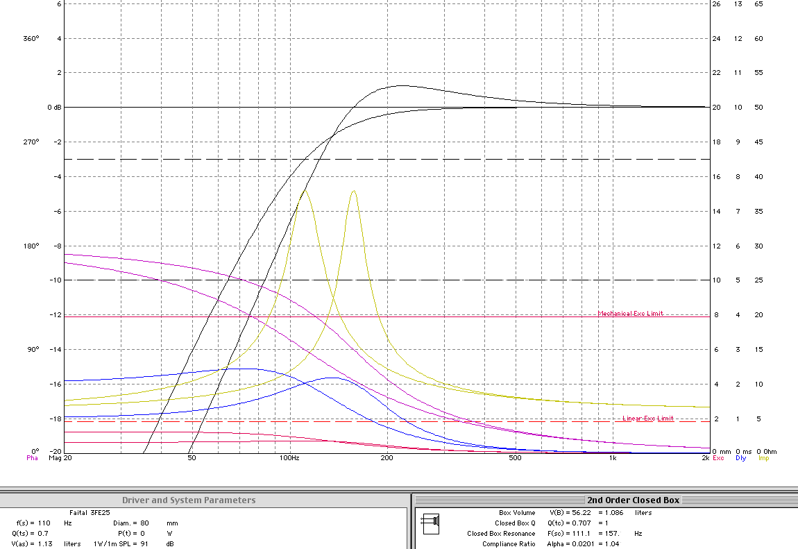

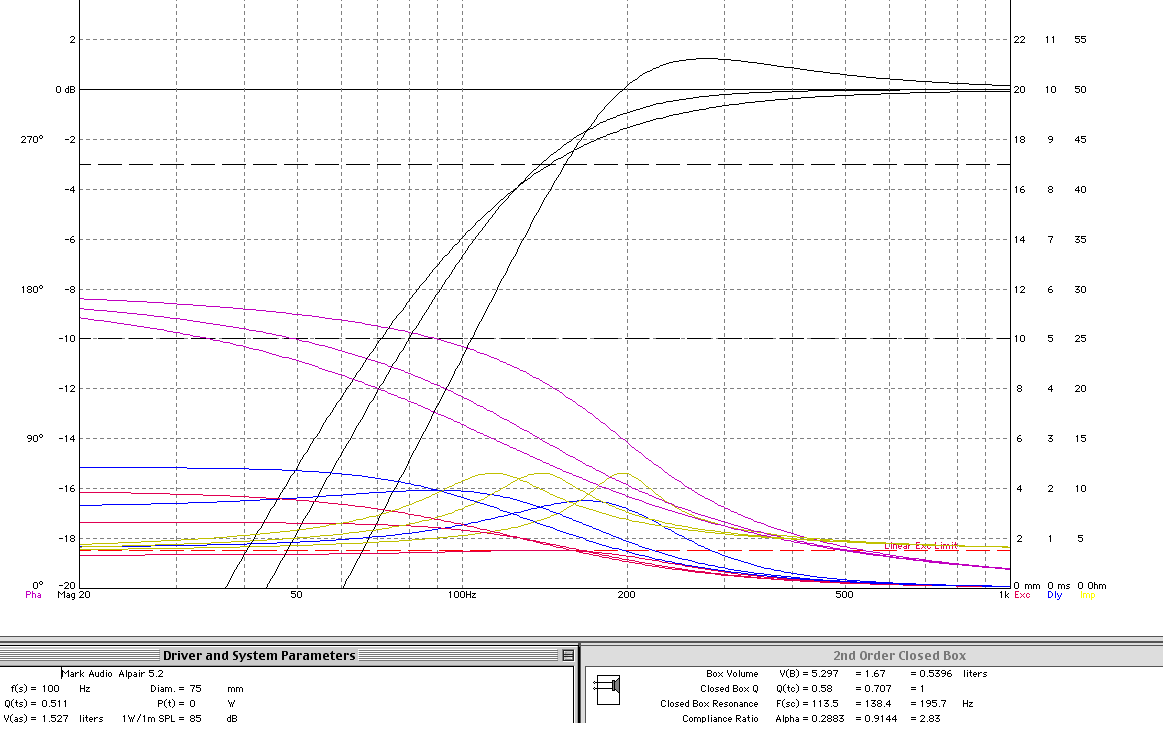

Sealed is very tolerant to differences unlike a reflex. But one does not get extention at the bottom so best used with a helper woofer. The difference in extention with these small drivers, is important as the vented boxes can reach the point where they have sufficient first harmonic reoroduction so as to give the apperance of low bass.

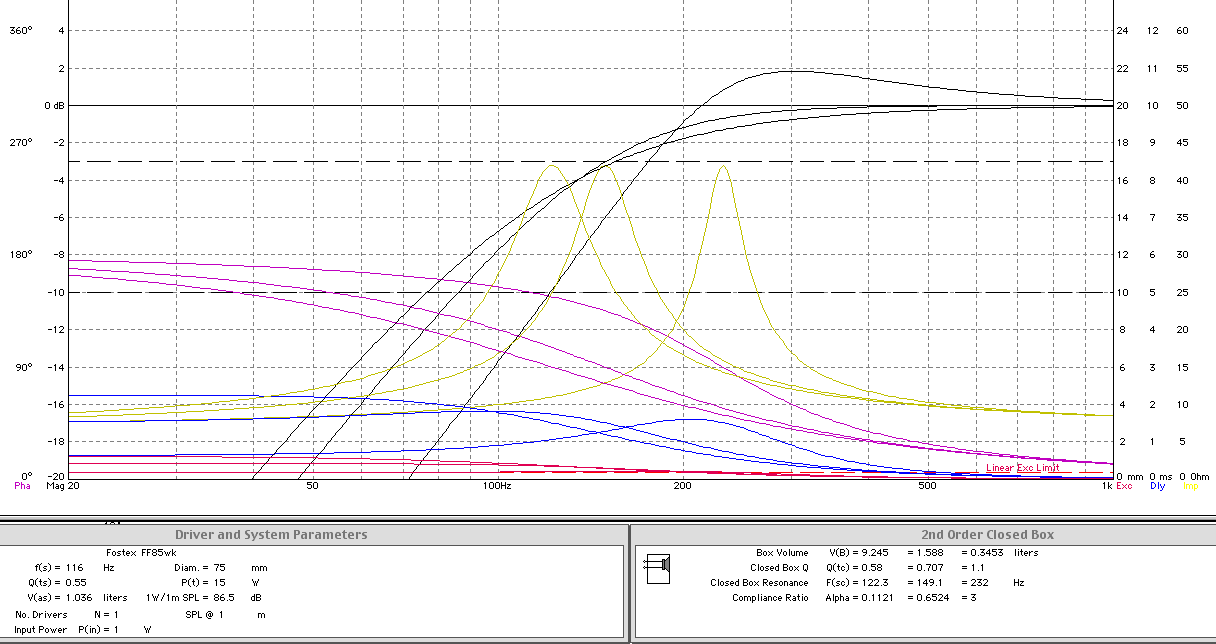

1.1 litre was sufggested as a sealed volume for the Fiatal, this should be considered the baer minimum, and as you can see fromt he sim, as you approach 50 litres the response improves.
Note: x axis in the Fitalgraph is out to 2k the others out to 1k so be careful comaring them). They all have F10 in the low-mid 80s.
The Faital is the best suited of the 3 for sealed. My use of the microSize box for it is a bit of a stretch.

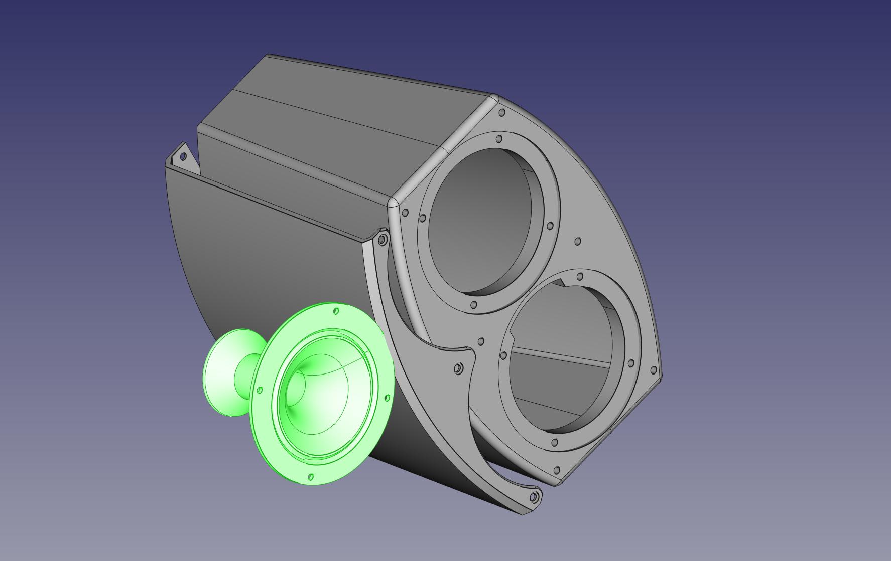

Okay - since I could not get pre-calculated ´recipes´, I did what I initially wanted to avoid and played around a bit in software to do the calculations myself and ordered some drivers to play around.

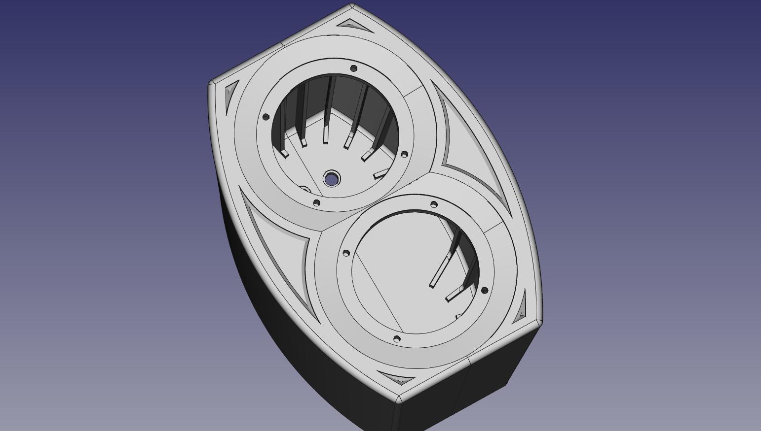

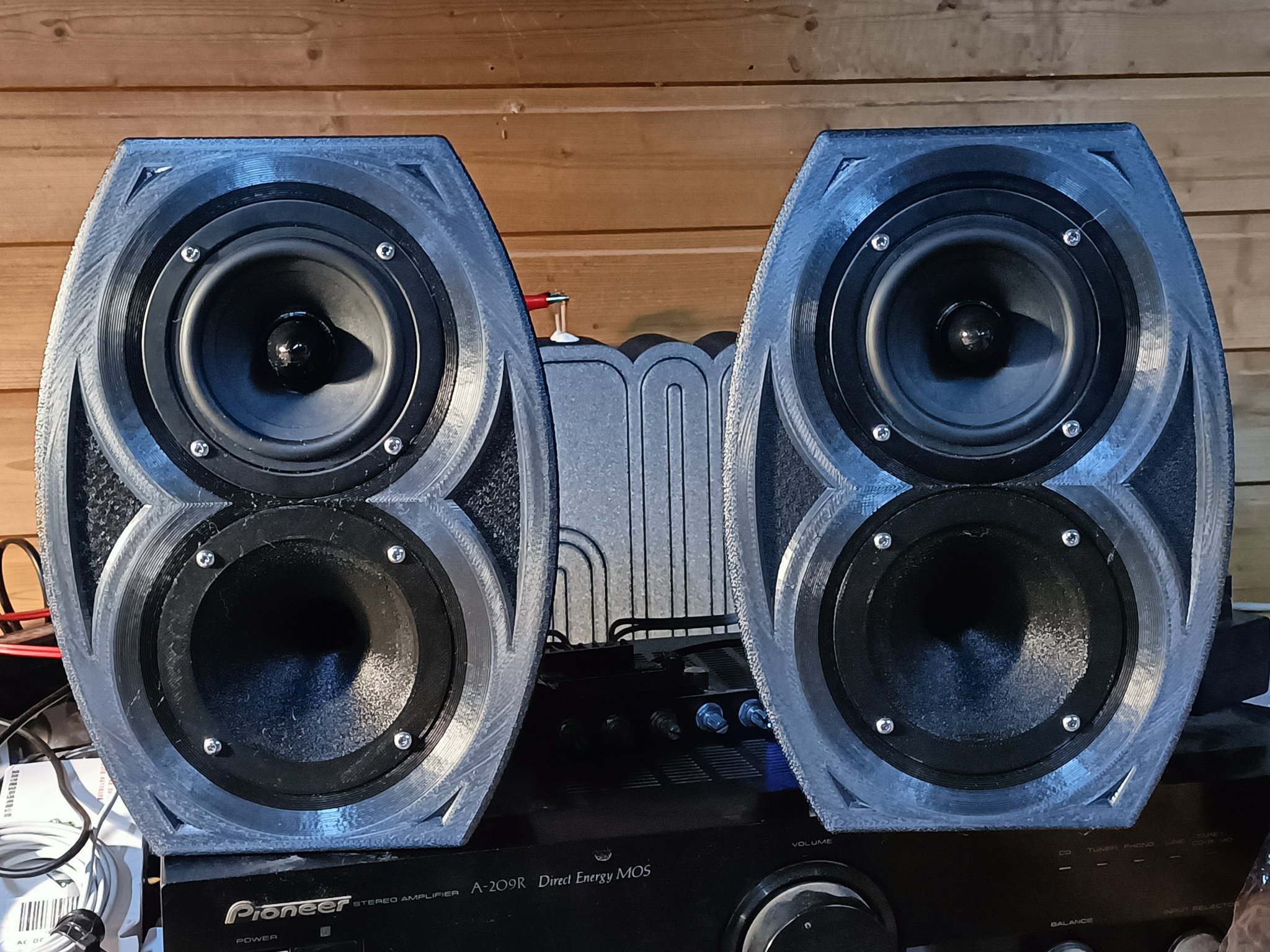

I am printing a few pre-designed subwoofers at the moment (hexibase and zx82net), the goal is to design 2 pairs of speakers to go with (or that optionally could go alone).
Since I do not know if speakers with ports introduc drawbacks into the design or if I get the bass extension for ´free´, I will start with ported designs and see if I can manage. So my first try will be

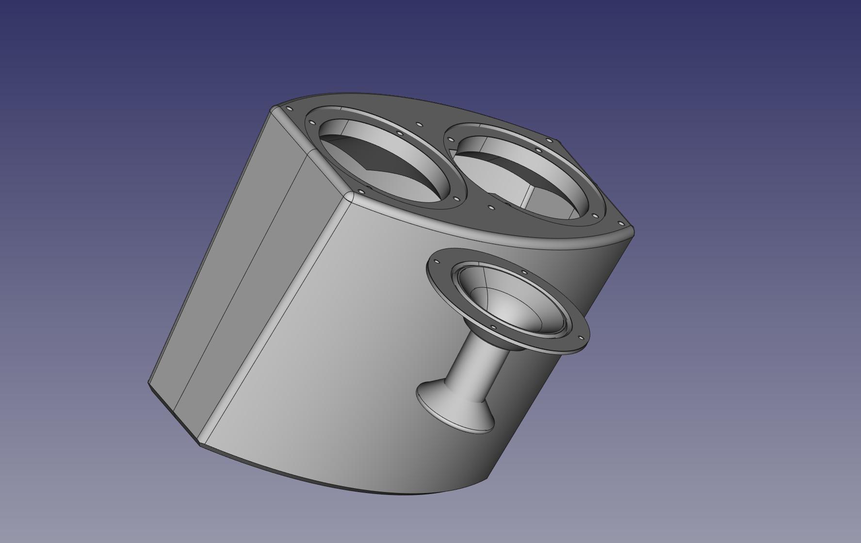

  • A Monacor SPX-31M
  • A 2,3l enclosure with rounded and trapezoid side walls (non-parallel top-bottom seems not so important due to the port being in the way, but could be added)
  • A port tuned to 78 Hz (or so I hope, no idea really how the heavy flares affect everything), which can be easily replaced in case it sounds bad.
  • As bonus, I will try to print no inner walls to gain a rougher surface
  • Second bonus - it will have interchangeable side panels to be printed out of nicer filament that is too expensive to print the body out of.

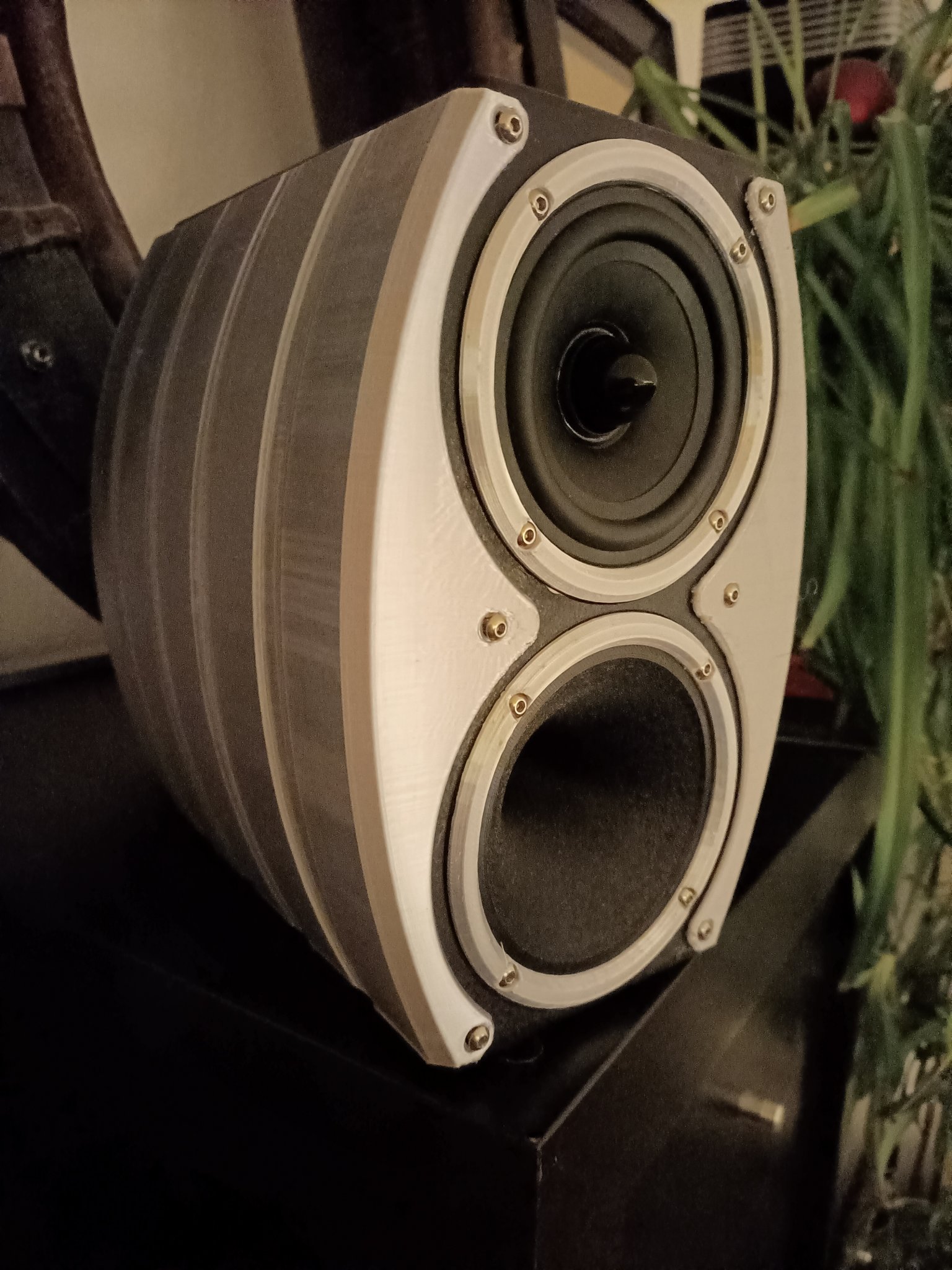

A feasibility sample with inner walls printed well, but sounded ****/hollow - no idea if this was due to design, new driver or simply because it was alone without stereo partner. Next iteration will be a pair of the design below, guess I´ll see.
Enclosure printed quite well - but I don´t like the decorative side panels. They do not print too well being quite thin and are too much hassle.
So I will go for version 2, this time with
  • 3l interior volume
  • 12mm walls
  • non-parallel top/bottom walls
  • some non-parallel interior structures to stiffen side walls a bit and help reduce wall reflections / center infill
  • Some structure at the front to hide usually not-too-well-printing top layer
Wondering if I should make the walls somewhat thicker, don´t know. But as it is, it´s at 1kg material (=10€) and prints in 3 days, quite nice.
If there are any caveats or suggestions, please let me know

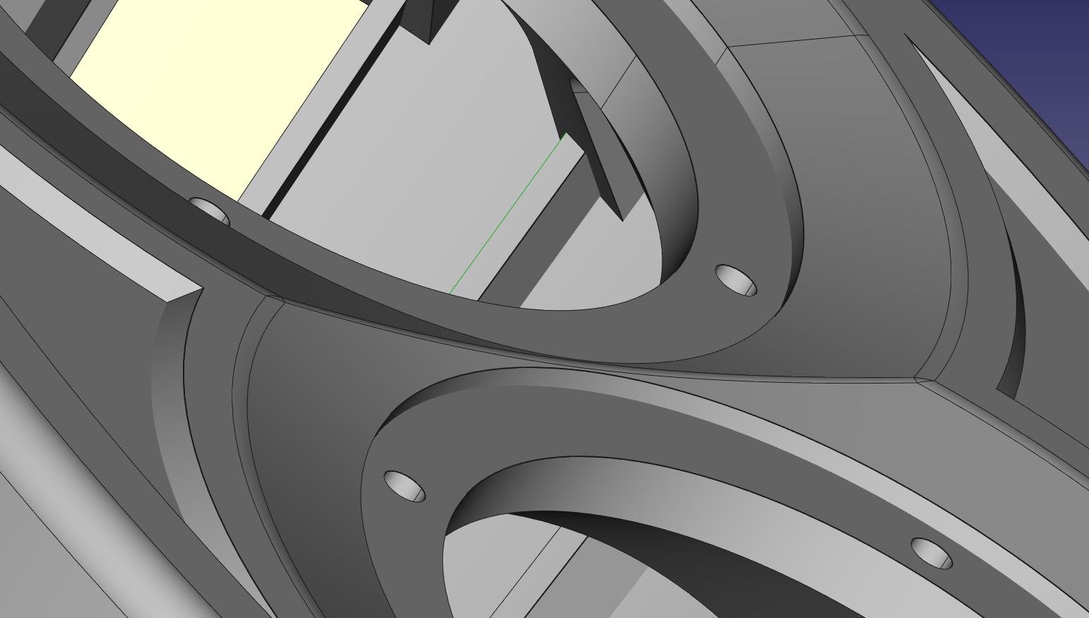

I hope it´s okay to adress your remarks with some further questions:

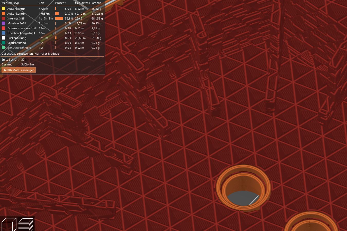

I tried to address the issue of sharp corners in general by
  • having all interior corners rounded by 4mm
  • printing without interior walls, which considerably roughens everything up on a scale of ~few mm (see image)
would you think this is sufficient or would more ´roundness´ be advisable ?

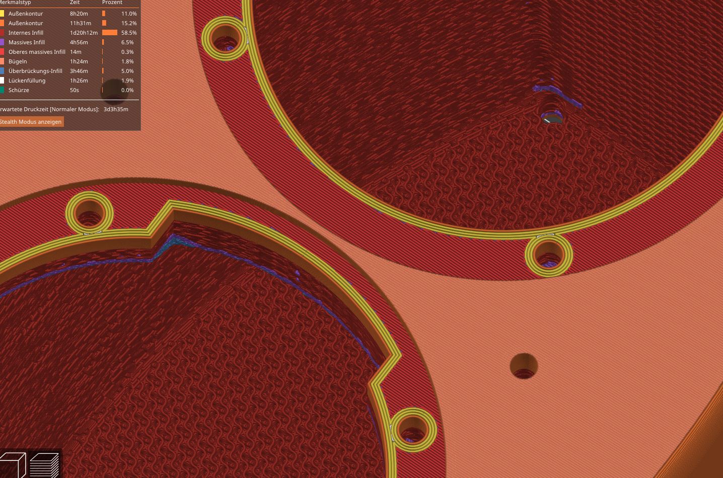

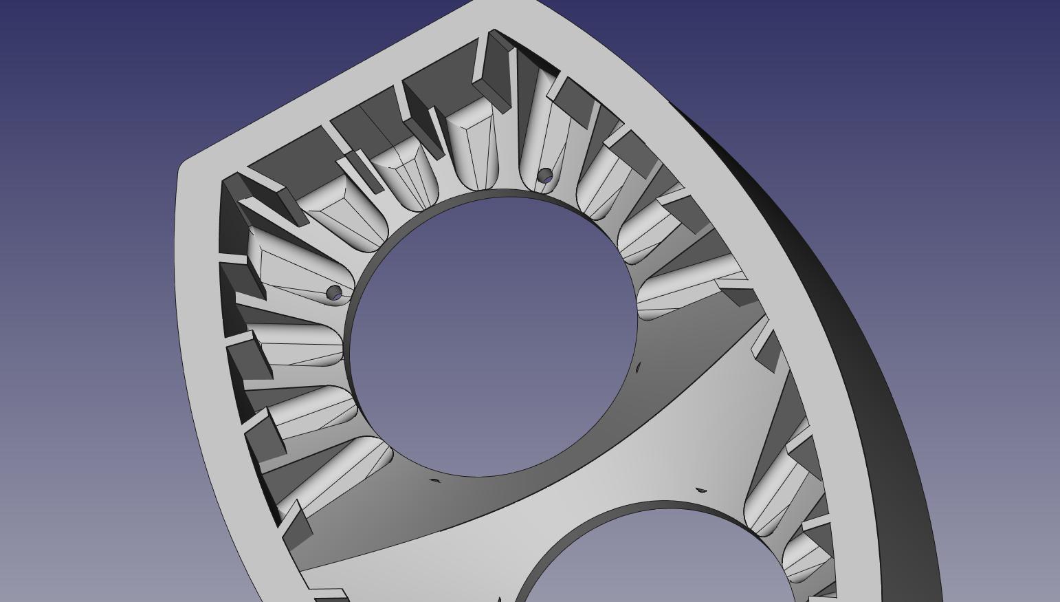

You seem to imply that the front baffle is of greater importance concerning sharp corners.
Since this models is planned to print with the front baffle up, I have to include support structures (which are quite steep and won´t print nice, but non-nice interior is acceptable to me). Could these already do what you had in mind, or would you build them more massive (without the cutouts) at the expense of interior volume ?
(image shows front baffle from the inside)
Yes, it is the exterior of the front baffle that would benefit from roundovers. Edges mean diffraction and that brings frequency response dips and peaks. The rings for the driver and port should have also positive influence. And as a last thing, since it is a full range speaker, its beaming may reduce the diffraction effect. This is hard to guess, it would need exact simulations or measurements. Try to look up some Genelec monitors - to get some inspiration on how to make roundovers.
Inside, the worse (more irregular) the inside, the better.
Oh, I was not aware that you meant the outside of the front baffle - interesting, I did not realize this had an effect.
I already constructed some features on the front (more for aesthetic reasons, inspired by some cheaper Behringer monitors of mine with a look quite ´inspired´ by Genelec) which seem to go in the direction you mentioned. Could this suffice / is this what you meant with roundover ? At the moment, I do not plan to use front rings like in v1 - they would not match well optically to these roundovers (?).
(they are quite shallow, 3,5mm deep. The driver sits flush in the 2mm recess)

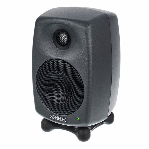

If I see correctly, there are sharp edges in the 3D model - see this small Genelec monitor - all is nice, smooth and round - and that is alo my cosmetic preference.
In this size class, the look is more important. Your design reminds me 90's plastic front speakers - and I have a weak spot for these too🙂

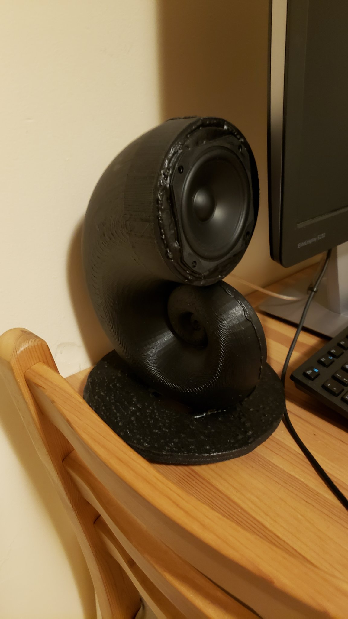

So, they came out rather nice.
I don't know much about Hi-fi or how a good speaker should sound, but I have the impression they are rather loud in the mids, guess I have to play around a bit in equalizing
