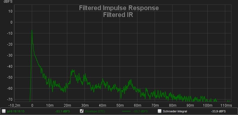

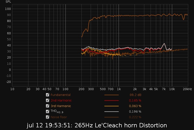

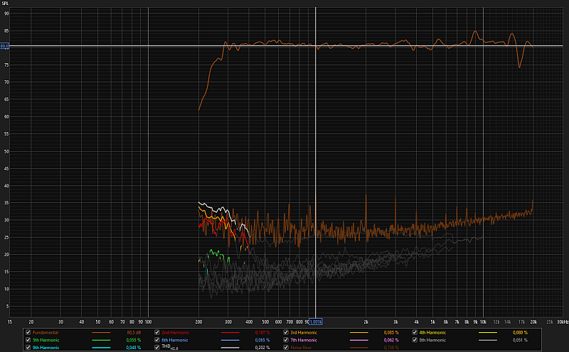

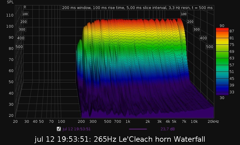

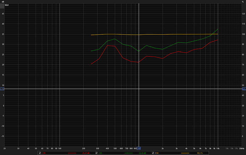

Please allow me to share some nearfield measurements of the Le'Cleach 3D printed horn with the BMS driver. The microphone is placed a few centimeters (approx. one inch) from the mouth, more or less on axis. Only one measurement is used, no averaging of multiple measurements. The SPL is "full throttle" on the <0,5watt tube amps 🙂

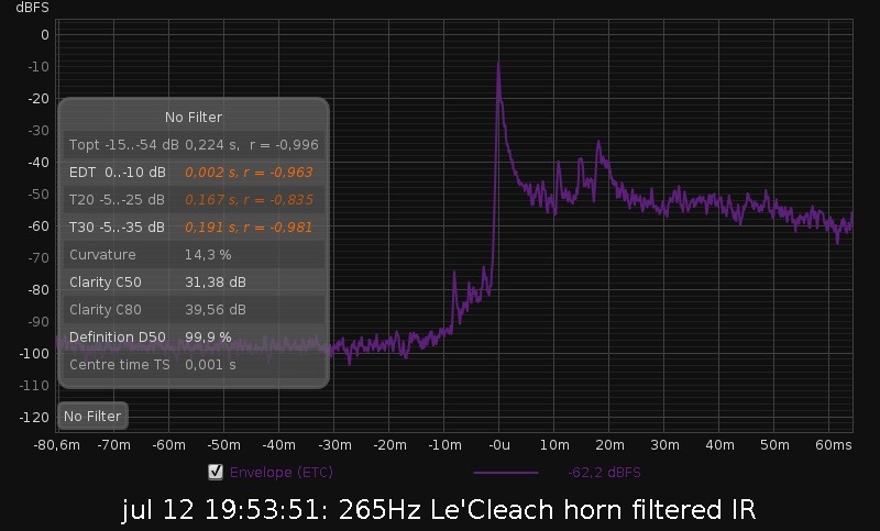

The horn is where it normally sits, so the (left) wall is in proximity. I placed some 2" acoustic foam on the floor and against the wall next to the horn. I did not use windowing or other fancy settings (still have to learn how to properly use it). A MiniDSP 8x10HD has been used to set the crossover and delay, and a few PEQ's to correct for some peaks and dips with max. +- 5dB. I struggle with the dip at 16kHz (although it does not bother me as I cannot hear that high pitch anymore due to aging), and in the impulse response there is something happening at 22ms, I do not understand what causes this. Maybe someone has more experience in tracing the possible cause? Comments to the graphs welcome, even bad ones ;-)

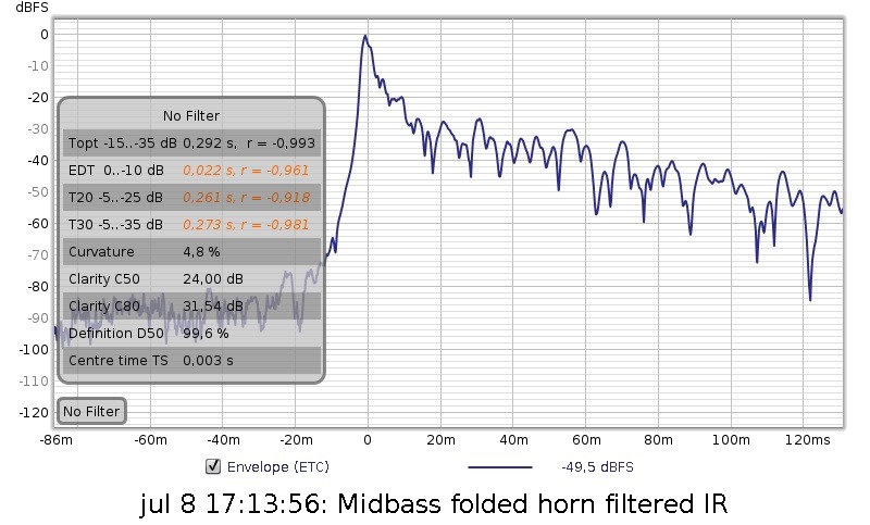

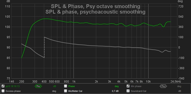

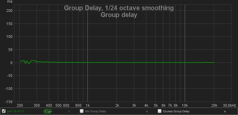

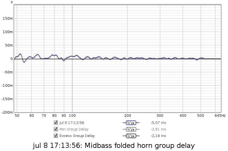

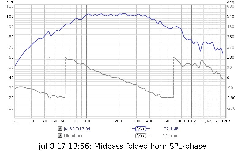

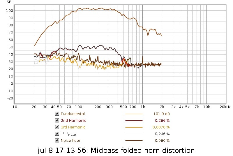

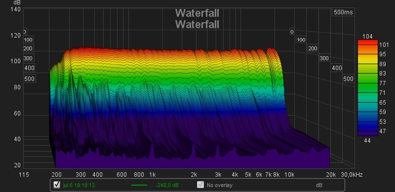

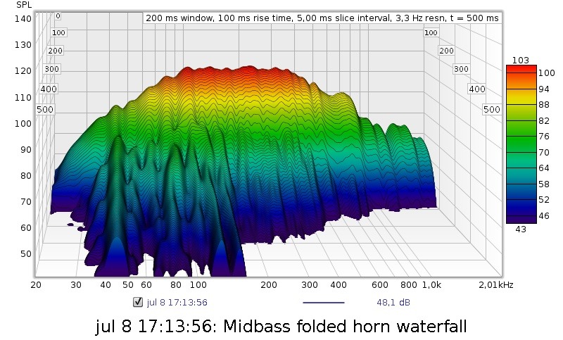

Yesterday I decided to take a fresh look at the optimalisation of the exponential midbass horns covering roughly 90-400hz. I made some nearfield measurements of the results, the mic is placed at a couple of cm's on axis in front of the horn and about 15cm's above the floor. The speaker is where it is normally placed, so room interactions do have some influences, but I was surprised that did not really play havoc with the measurements. Some acoustic damping is temporily applied against the left wall. I do not use a traditional crossover for this horn, but I have used some moderate PEQ equalizing the curve. A 24dB LR low pass at 920hz has been applied, as well as a subsonic filter.
Found out that that was the backwall reflection 😎and in the impulse response there is something happening at 22ms

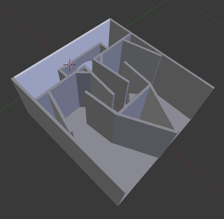

Midbass folded horn design called the MIGhorn: Exponential horn for 8" woofer, 1800cm2 mouth, path length plm. 106cm.

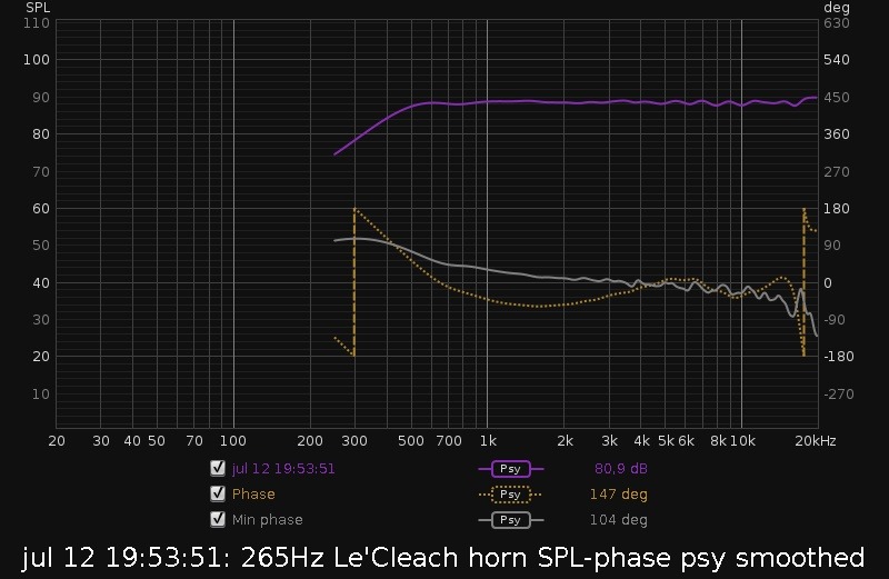

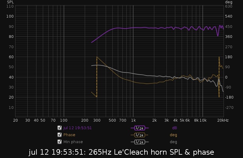

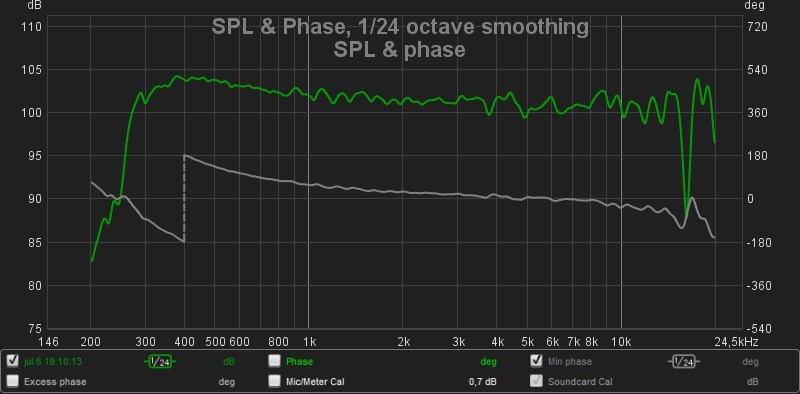

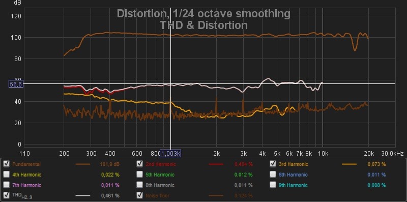

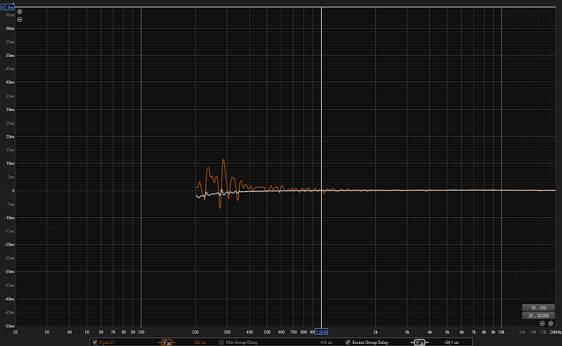

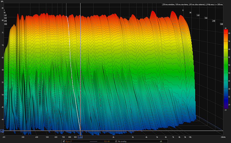

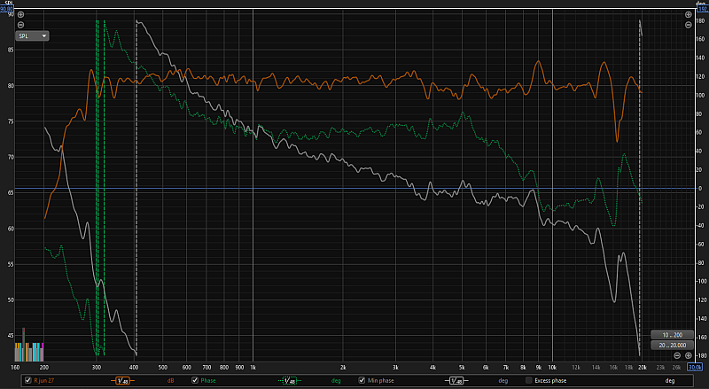

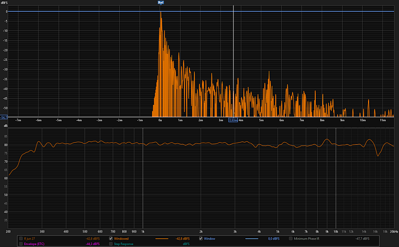

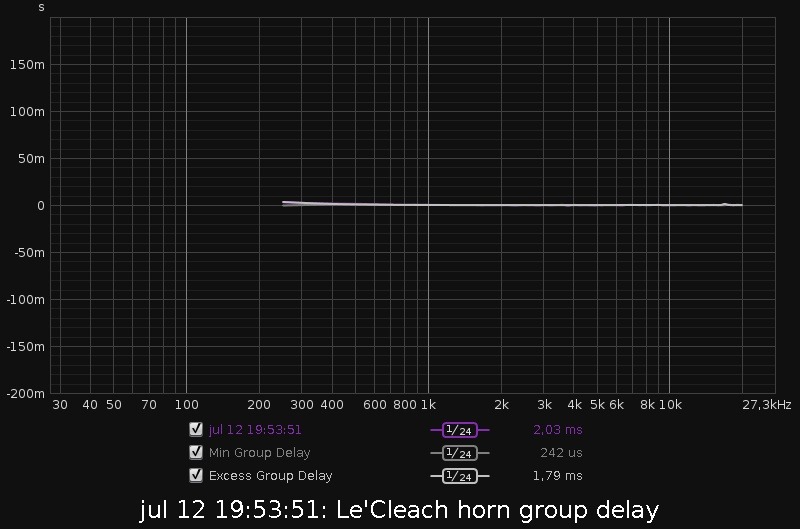

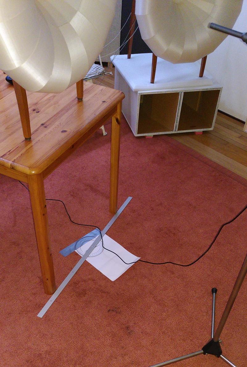

I was not satisfied with optimization of the mid-high Le'Cleach horn and decided to do it again, this time I placed a table in the middle of the room, with the horn on top, to be able to use windowing analysis. The ceiling and floor were closest to the mic and speaker, so a window of 2ms start and 4ms end is used for the analysis. The mic is placed one meter from the throat, so 57cm from the mouth. I used some manual peqs to correct the curve (no REW EQ used). Pity that my horn is not hifi... still good to scare something 😉

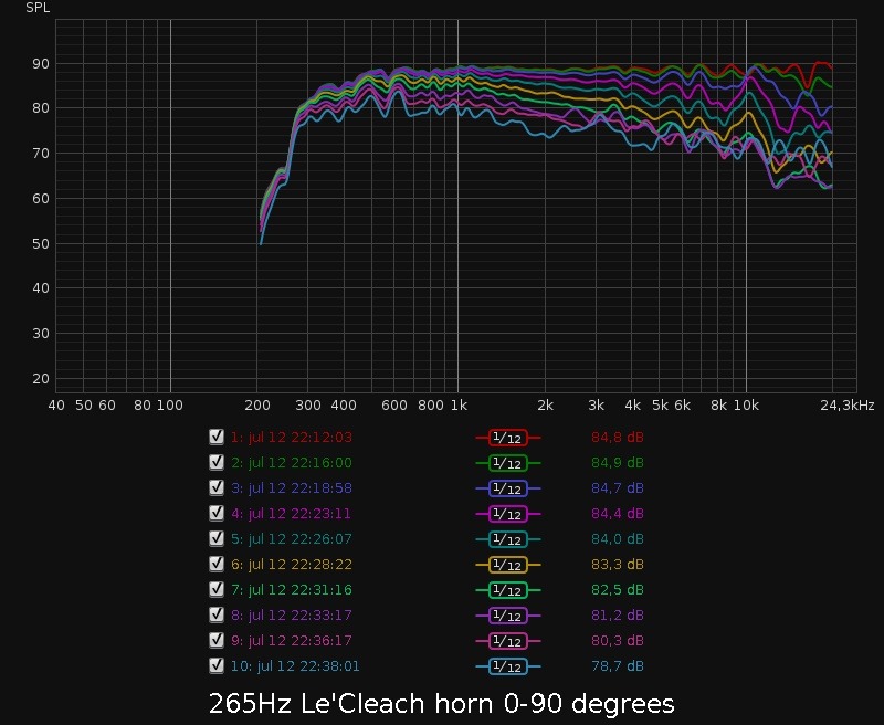

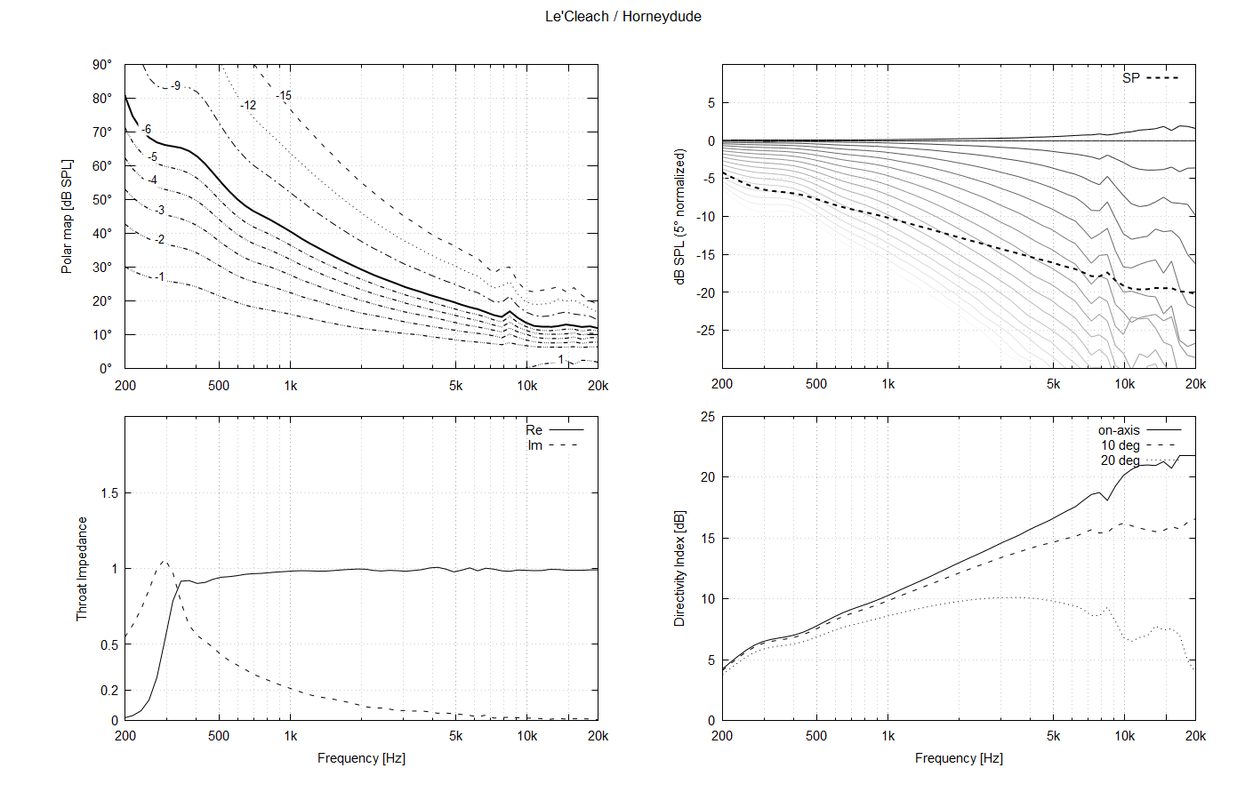

Additional, I made a polar measurement with 10 degrees increment from 0 degrees to 90 degrees. With thanks to @mabat for the simulation below (see picture), I finally went for the hassle to produce a 0-90 degrees measurement. This is where my horn is compromised, it is beamy. I like that though, and for me it is not a problem because I treated the room such that the sound is direct but not in your face, there is a proper soundstage. So you hear the recording ambiance and precise placement of notes/sounds due to the absence of first reflections. The room boundaries seem to have disappeared so to say.
Gee- that is smooth ! (plus lovely in aesthetics) -your midbass horn is certainly nice too.
