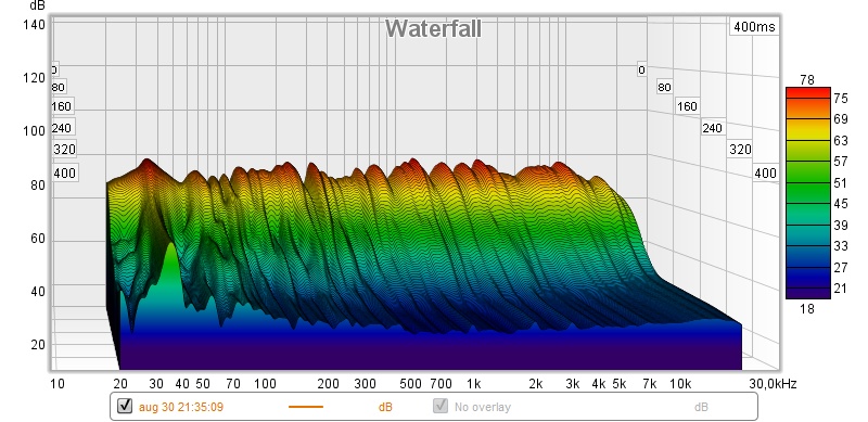

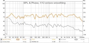

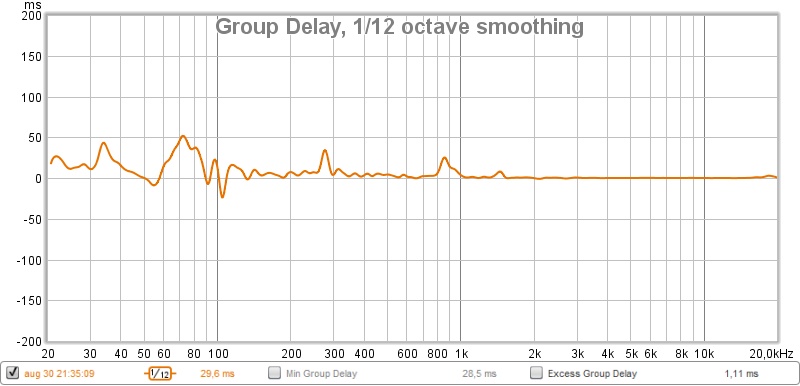

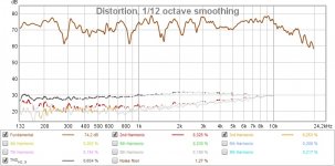

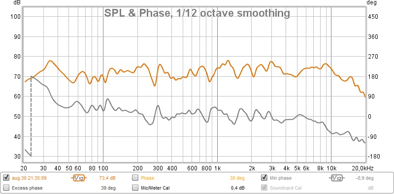

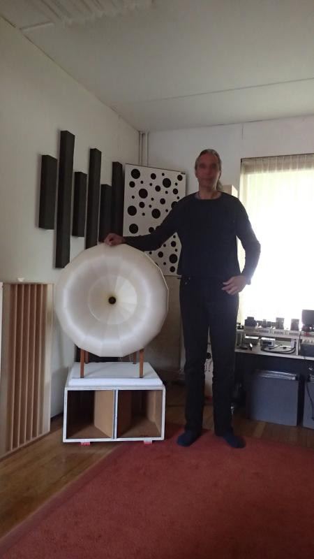

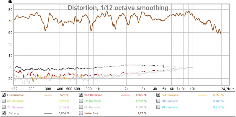

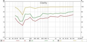

As a preview/teaser, I would like to present some measurements of my system. It comprises of bandpass subwoofers, basshorns and mid-high horns. It looks like a 3-way but it is a 4 way. A Minidsp 8x10HD is the heart of the system. The amplification for subwoofers and basshorns is solid-state, the mid and high portions of the BMS 4592ND drivers are fed with a signal from low power tube amps. The midrange and tweeters are as such biamped, by the way.
I have applied acoustic treatment in the form of a mix of basstraps, diffusion and absorption. The room measures 5.28m by 4.15m with half open rear wall to dining room and kitchen. Total length of room is 8.6m. Listening position is about 1.2m from rear wall (the rear wall that matters is 5.28m from the front. To the left of me the room extends, to my back and to the right I have the mentioned rear wall. So my room is not very symmetrical.

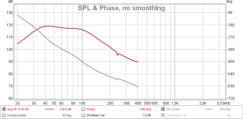

About the measurements: these are taken from the listening position, only one measurement. All screenshots are taken from this measurement, exept the subwoofer measurement., where the mic was placed very close to the port of the subwoofer. The subwoofers have also been included in the total system measurement, so the measurement range is plm 20hz-20khz.
I tried to place the mic as close to the "middle line" between the speakers as possible, at the listening position. The speakers are on their usual/quasi optimal position. I must note that I am not yet finished dialling in the system after the latest upgrade of my system. Also, I am just starting to understand how to measure loudspeakers well, so please take the measurements with a grain of salt. I may have made errors, but nevertheless I guess it is entertaining enough .
At a later stage in this thread, I will show some more details about the system, the build of the 3D printed horns and especially explain about the choices I made over time to create this system as it is now.
I hope the horn afficionados (and of course all others who build speakers) like my effort it is by all means not perfect, but it is a very musical sounding system I dare say.
Edit: the SPL/phase graph is total system output with subwoofers included
Good morning Horneydude,
congratulations with these measurements/results. It's the well-deserved output of your audio-dedication.
Although our systems are really different (i'm into K-tubes and open baffles) we have common ground on low powered tube gear (...pictures please...). And the audio hobby on its own of course.
When looking at your pictures i can't recollect i saw you at Breda or Hengelo at Welkom op zelfbouwaudio.nl events ? But i could be mistaken. During these Corona-times all interesting audio-gatherings are skipped/cancelled anyway.
Hope to see more of your interesting audio gear.

@Horneydude: Are you still here? I would like to know the details of your system, pictures of horns, subwoofers, amps, everything How much filament did you use, which printer and how long did it take to print?

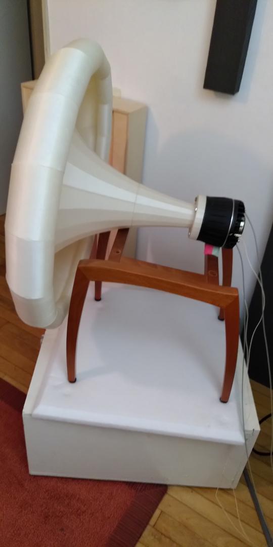

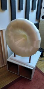

The horns have been printed on a "standard size" printer. 22 parts for one horn, glued together. Le'Cleach contour, full 360 degrees horn termination as described by Le'Cleach. Only do-able with 3D printing. They cover a range of 300hz upwards, but I filter at 500hz with 24dB LR. I have lived with the 4592ND for almost 20 years now (early adopter) and I have finally managed to make it sing in this horn, but it took a lot of time and measurements. It's a b*tch to get it right, but it can sound wonderful. If you do it wrong, it will irritate the heck out of your ears. I will not reveal the exact settings (yet), but maybe doing so is pointless because in a different horn, the settings will probably also be different.

Correct. But I won't do that again, very time consuming and a hassle. But you get a good horn this way. I have printed another set of horns in the same way. Maybe just maybe I might sell the second pair. But the parts have to be glued together still, so the parts are stored in a cardboard box until I feel horny again.how do you print a horn so big ? do you do it in parts and then glue them together ?
The horn consist of 22 pieces glued together, so when running out of filament, you start again although it is a waste of an unfinished part obviously. So not running out of filament is key here.What I would like to know is how you exchange filament while the object is not finished printing. What you do when you run out?

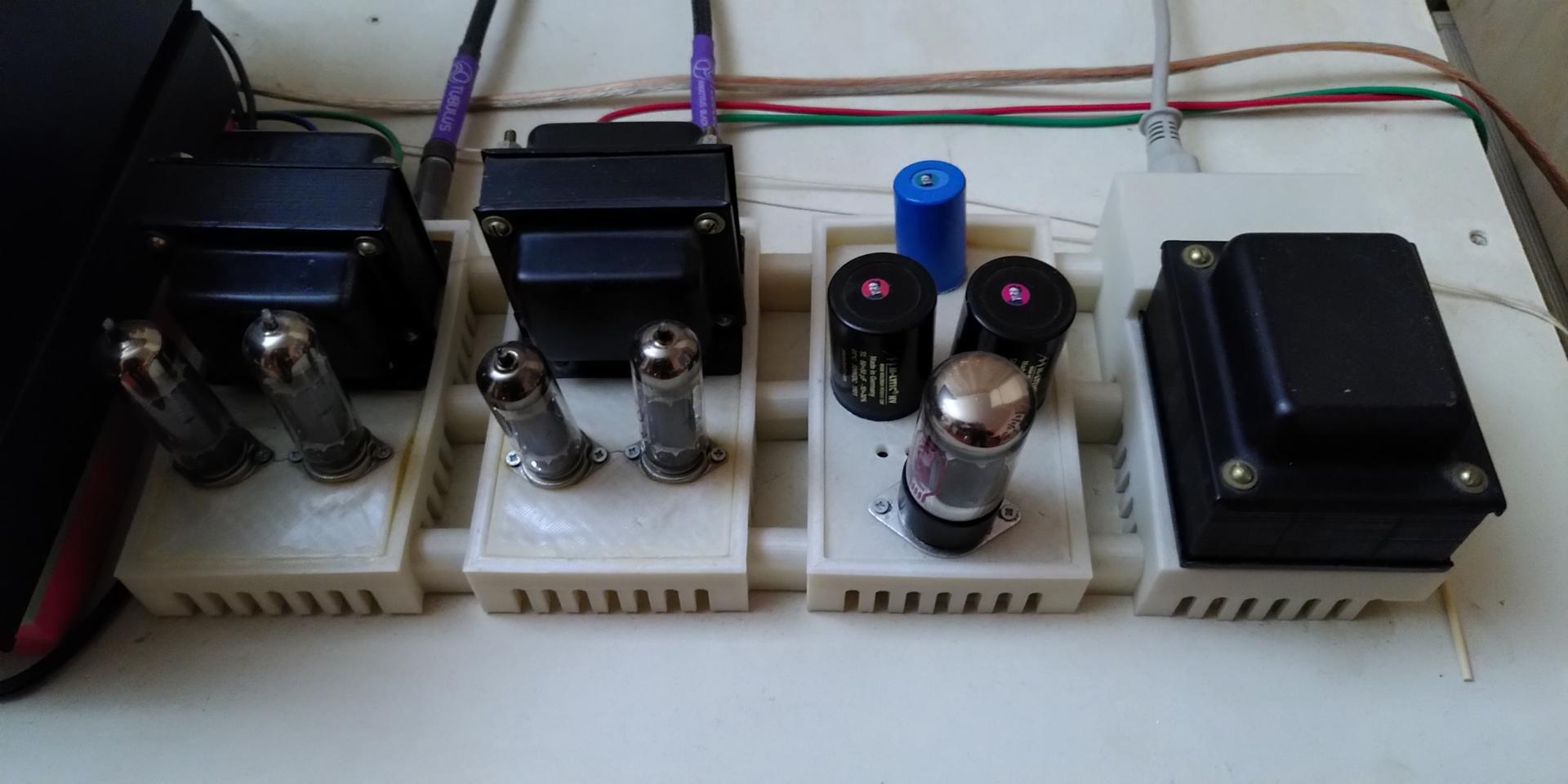

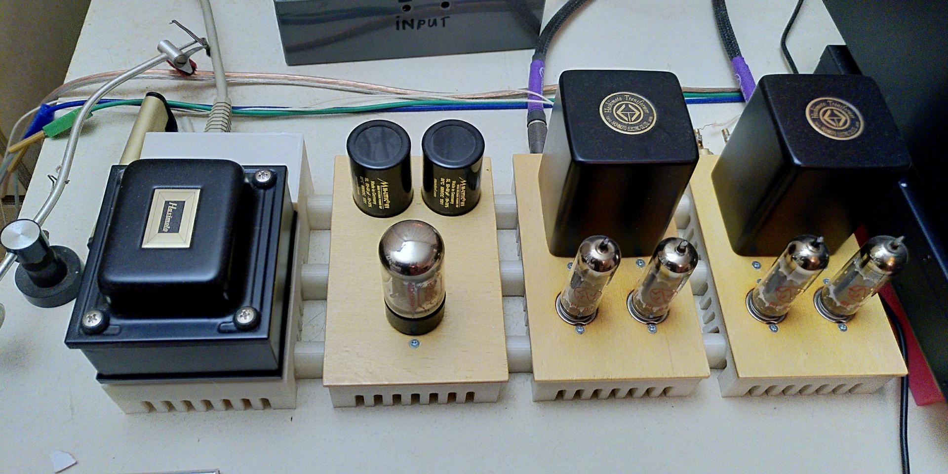

First photo: midrange amp with 3D printed housing
Second photo: prototype 3D printed, it has melted somehow and it survived a violent emergency stop in my car but still functions as my tweeter amp. Lafayette iron by the way, sounds nice on it's own.

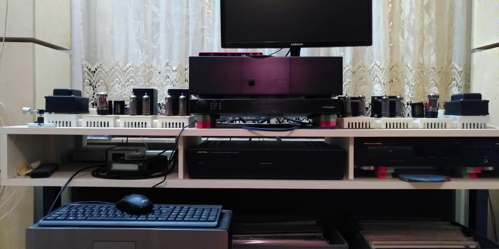

Third photo: combination Rotel solid state and tube amps. Solid state for midbass and subs, tube for mid/high. I want tube for midbass too, but regarding the power consumption of tube amps, that has to wait until energy prices are lower.
Forth photo: mid/high horn 3D printed, front view
Fifth photo: mid/high horn 3D printed, side view

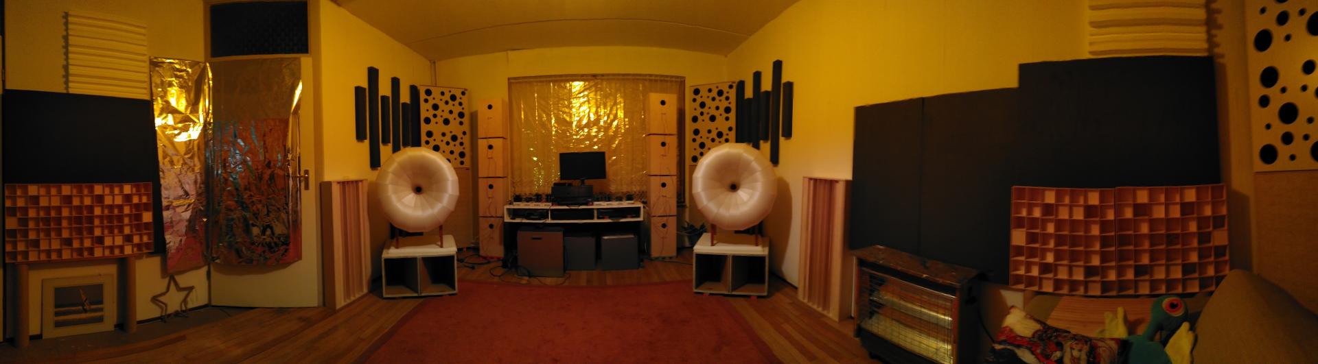

Sixth photoanorama photo of the listening space with bass traps, diffusers and absorption. The ceiling has also been treated.
