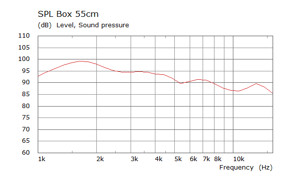

Acoustic Lens with 3/4 '' tweeter
Hi 454Casull,
As I did not manage to take new measurements due to very limited time, I add some measurements of the printed acoustic lens using a SB19ST (19mm) tweeter and some information on the construction of the acoustic lens model.

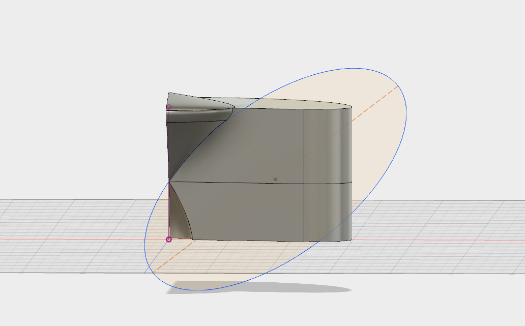

3D-constuction:

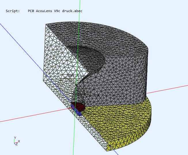

I did quite some ABEC simulation work during construction of several variants:
Simulation of SPL at 55cm distance by ABEC:

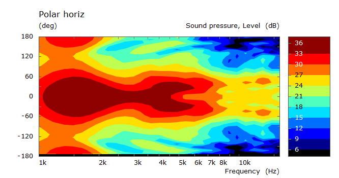

Simulation of horizontal directivity by ABEC:
Situation of horizontal directivity, normalized to 0°:

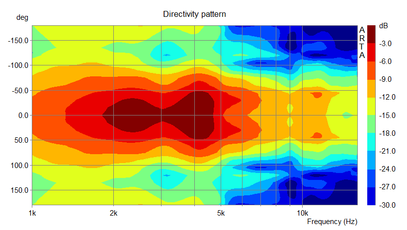

Measurement of horizontal directivity using SB19ST tweeter (19mm dia), mic distance 55cm:

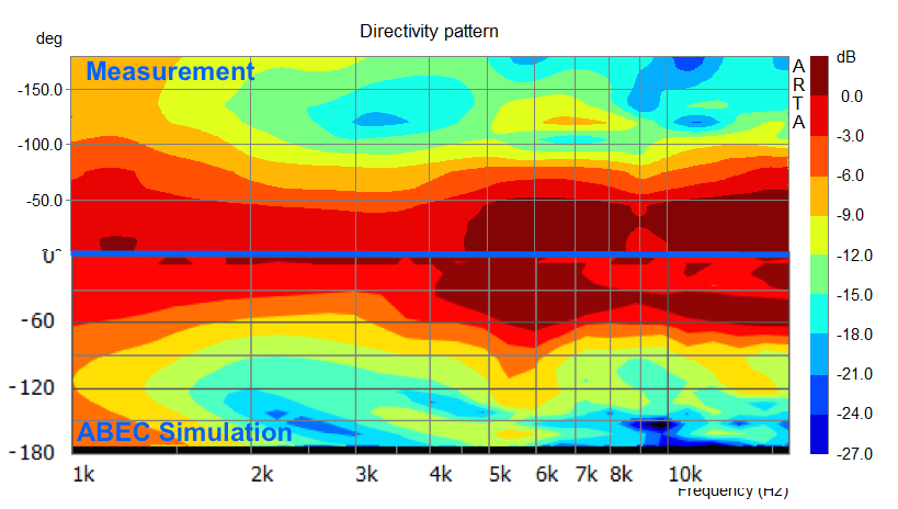

Comparison of horizontal directivity (SB19ST) normalized to 0°:
Measurement (upper half of image)
ABEC simulation (lower half of image)
Please note that the model simulation in ABEC was slightly different from the final printout - thus the observed differences between simulation and measurement. However, ABEC was still extremely helpful to understand some basic principles of how the acoustic lens worked.

How are you creating your ABEC mesh?
Are you doing it in a 3D program and then importing it into ABEC?
And if so, which one?

It looks like I could output a STL file from 123D, and import it into Gmsh:
[Gmsh] Imported stl mesh size control
That would allow me to do my designs in 123D, where I'm very fast, and simulate them in ABEC

The normalized simus are scaled from +3 to -27dB whereas the measurements are scaled from +0 to -30dB. Did you matched the scales in the comparison graph? For me it seems not, so maybe then it looks even better.

Hi Andreas,
You are right, I did not correctly align scales of measurements and simulations.
There are more shortcomings with the simulation:
- Have to check distance of simulation vs measurement;
- The printed lens slightly differs from the simulated lens (rounded edges);
- The SB19 was not simulated as a dome, but as a flat disc;
- Have to check the TSP I used to simulate the SB19;
I'll go back to the simulation, check things and re-do the simu...😉
