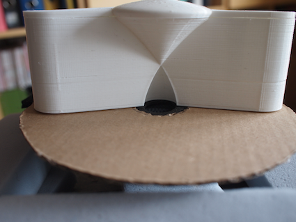

Yep, it basically takes the output of the diaphragm, concentrates it to a point, and reflects it 90 degrees.
Note that it only works over a very narrow bandwidth because the device is so small. (Same rules as any waveguide.) So with a 3" wide baffle, about the size of the one pictured in this thread, the beamwidth will be 180 degree from 4500Hz and up.
That's why the Beolab 5 looks the way it does. The tweeter at the top covers about 2-3 octaves, and the midrange below it covers another 2-3 octaves. It's a conventional three way loudspeaker with the drivers flipped 90 degrees. Note that the 'saucers' aren't just there for decoration; they're there to force the midrange and tweeter into radiating into half-space. (If they weren't there, the drivers would radiate in 360 degrees once the wavelengths exceed the diameter of the baffle behind the driver. IE, the tweeter would be radiating into 360 degree below 4500Hz if it wasn't for the 'platter' that's underneath it. The platter is there to reduce that angle to 180 degrees, which reduces 'floor bounce' and increases overall output.)
It's a waveguide, just a peculiar looking one.
You can also use the same technique for any angle you want; 90 degrees, 45 degrees, whatever. It doesn't have to be 180.

This is exactly what I did.🙂 Printed acoustic lens with DE7:

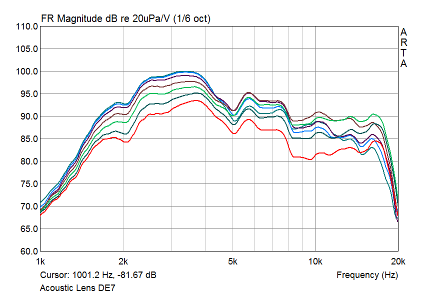

...and horizontal directivity 0-90°.

Note: The lens is just a first prototype, i.e. not necessarily ideal at this stage.

@gaga, are you using a gasket? I think you may have sound leaking from the interface between waveguide and compression driver.
Any leak will travel a shorter route, creating the dips shown in your graph.

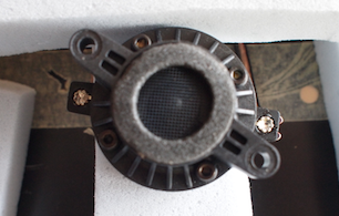

Hi Patrick,
I did not use a gasket. There is a foam-ring terminating around the 'mouth' of the DE-7 (see image).
However, measurement was done with a very simple test-setup showing certainly some leaks between DE-7 and Lens... Thanks for pointing out!
I'll do a proper measurement and post here if of interest (may take a while though).
