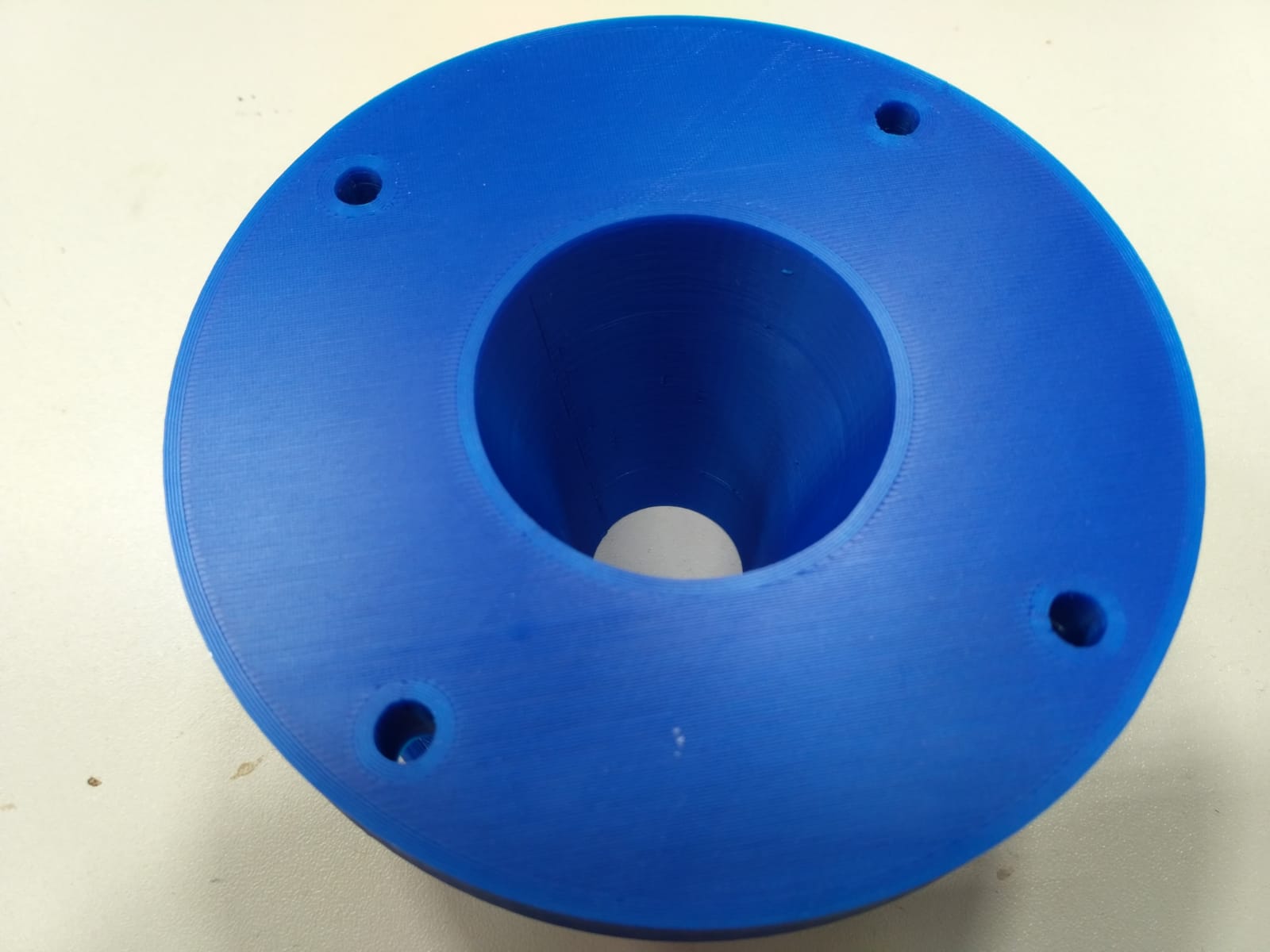

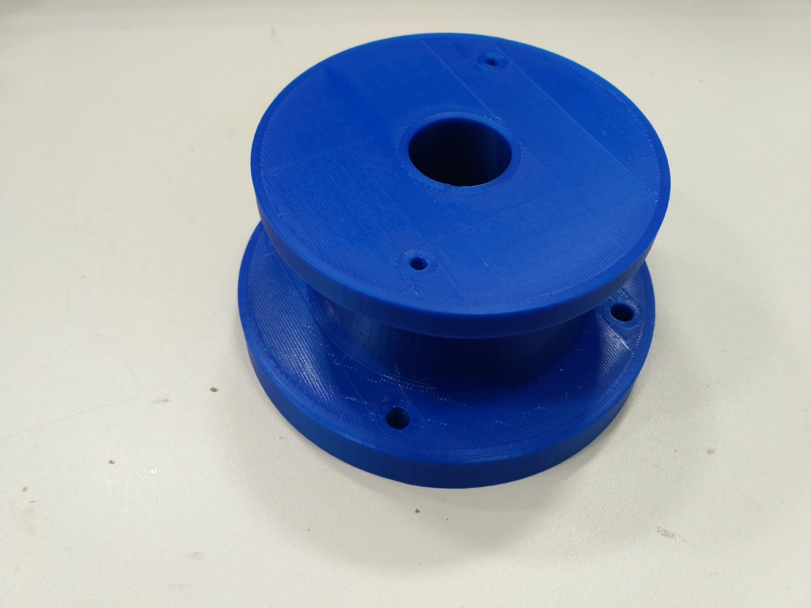

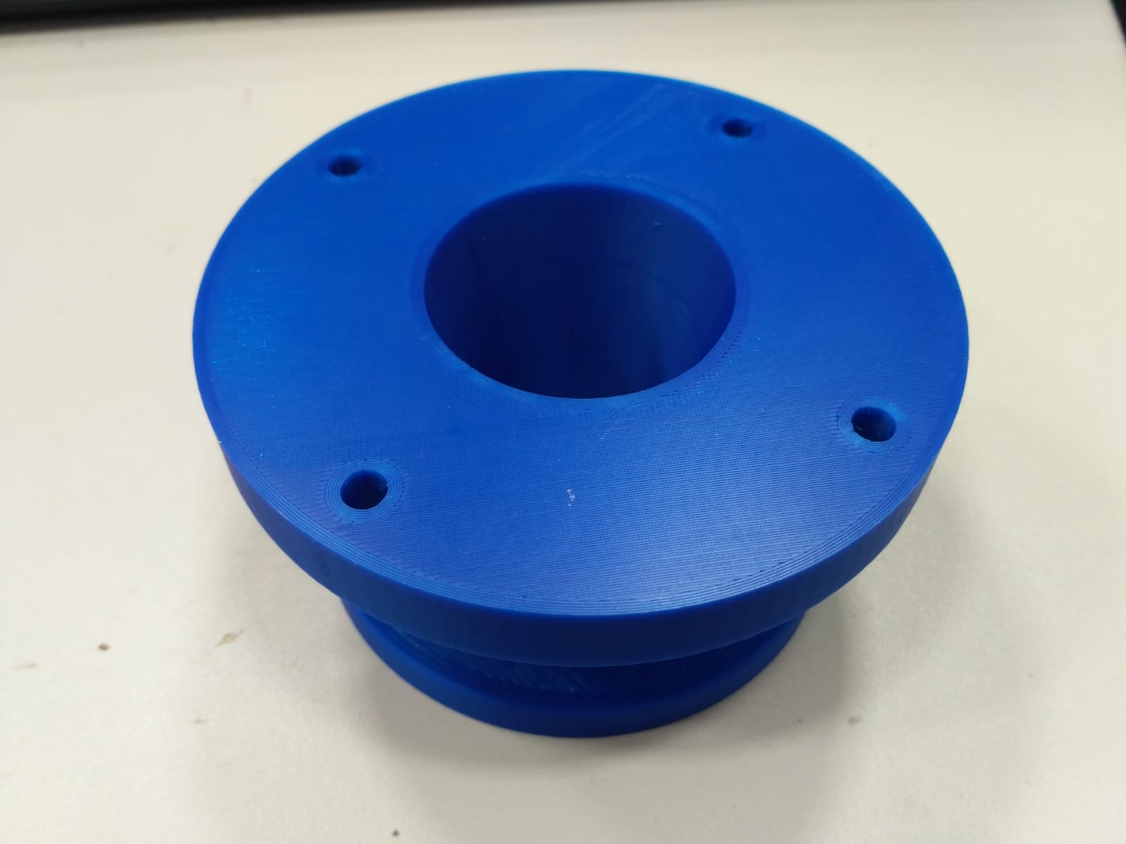

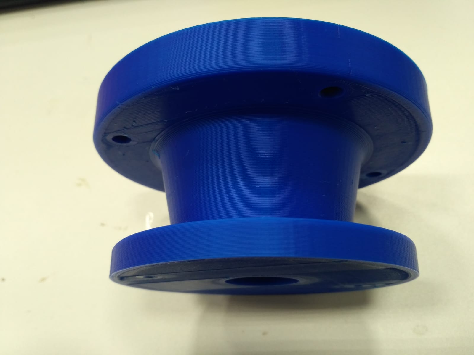

Here is the first print.
Joined 2008

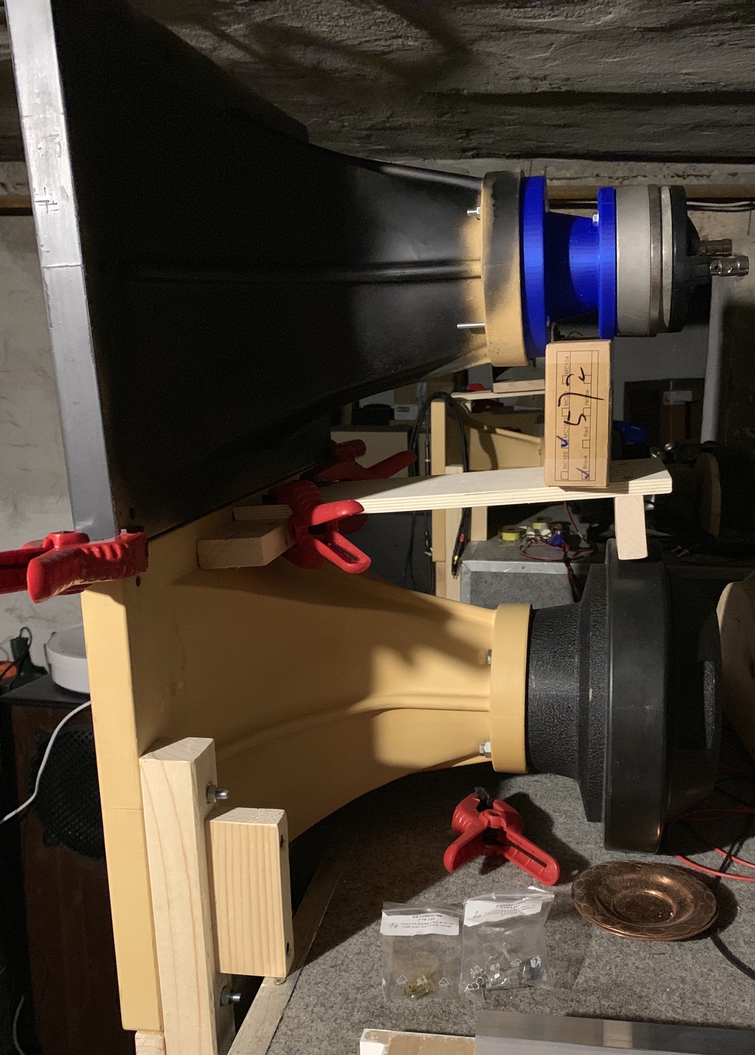

It works! However, as expected, it is about 18 mm shorter than needed. Also, I made the 2" interface to the horn 50 mm and it needs 1-2 mm more. All in all, I am very happy with the result. The two drivers will be perfectly time aligned. The step/impulse response looks almost perfect.
Edit: Added picture:)
