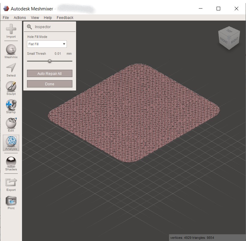

The way that I got Meshmixer to do this was to go into the Inspect section of Analysis and let it autorepair as in the image below, it then puts a top and bottom on the shape. I then converted this to a solid and chose Boolean Union, as that worked for what I wanted, to make a mold of the waveguide shape so I can CNC cut it.
attachment.php
I spent a serious amount of time trying to turn the mesh into solid geometry. If the waveguide is aximsymetic it is fairly easy to extract the curve and revolve it around circle or loft it around the mouth and throat id they are different but ultimately it wasn't quite right.

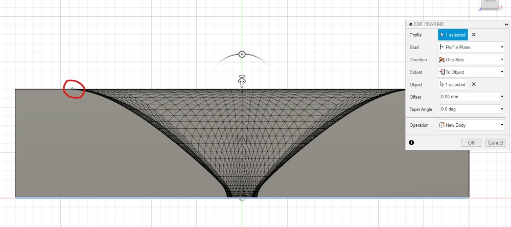

I then extruded that sketch upwards to coincide with the top of the waveguide by selecting "To Object" in Extent and clicking on the top of the waveguide in a side view shown in the red circle.
attachment.php
You then have a baffle the exact same thickness as your waveguide.

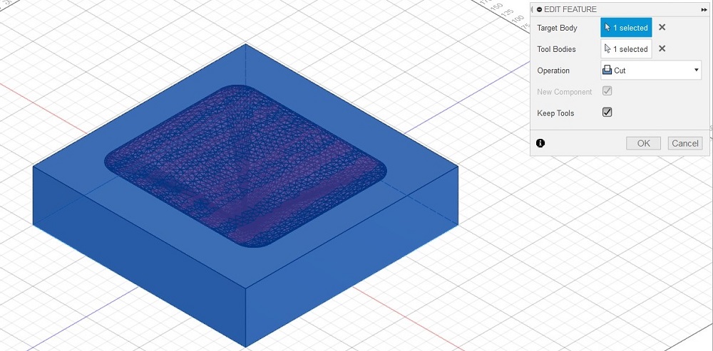

To cut the mold out of the waveguide choose combine, select the baffle as the target body, the Brep waveguide as the tool and choose cut, I made a new component and kept the tool.
attachment.php
Then you end up with this 🙂
You can then add whatever driver face plate you need and cut out whatever you want from the back of the baffle with basic extrude and cut commands.

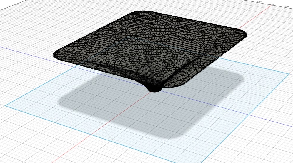

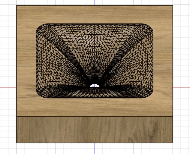

In another thread, someone was looking to make a waveguide with a square throat, for ribbons. Here's how to do it:
The instructions that I published here can be used to make a throat that's rectangular:
3D Modeling Tips and Tricks
You simply start with a rectangle instead of an ellipse.
Depending on how well behaved your software is, you could actually have a throat of any shape.
You can also have a throat that's circular with a mouth that's rectangular. That's accomplished by starting with rectangle and smoothing the curve. (The smoothing turns the square into a circle.)

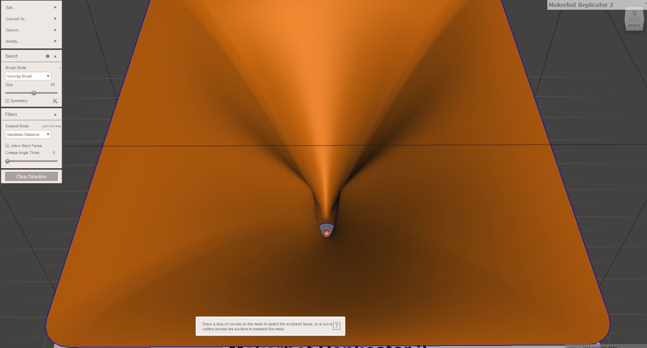

Last year, Advanded Transition Horns added support for including a diffraction slot.
Diffraction slots are kinda antithetical to the entire idea of oblate spheroidal waveguides. The entire idea with OS waveguides is to have a smooth transition from the throat to the mouth.
But, darn it, diffraction slots are really useful. For instance, if you want to build an oblate spheroidal waveguide that's 90x60 degrees, the width of the waveguide will be nearly twice as wide as the height. You end up with something like this:
attachment.php
ATH4 now offers the option for including a diffraction slot, but I'm not thrilled with the sharp edge on the slot:
attachment.php
I think that if you smooth the transition from the diffraction slot to the rest of the horn, it goes a long way towards improving a diffraction slot. I've been using the 18Sound XT1086 for more than ten years, and I've always been happy with it, and you can see there's a lot of smoothing on the diffraction slot. In fact, you might not notice that it's there unless you looked closely. Pics:
But though I tried a million things in ATH, I couldn't figure out how to get a diffraction slot without a sharp transition.

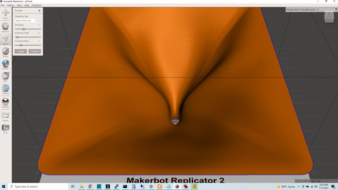

Then it hit me: I could smooth it after the fact.
Which is what I did:
attachment.php

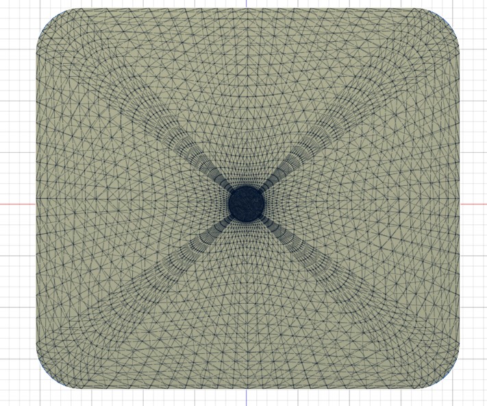

Here's the ATH horn, produced by the software
attachment.php

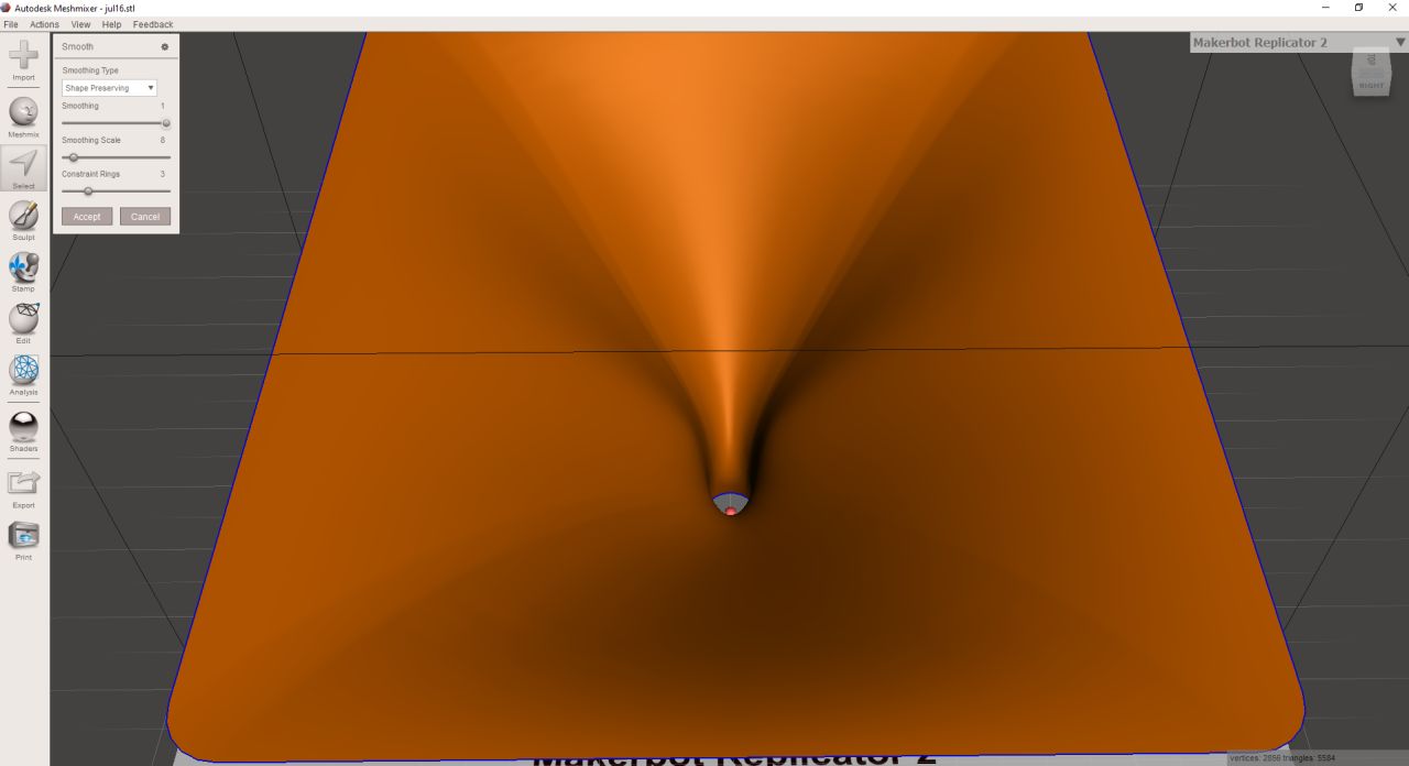

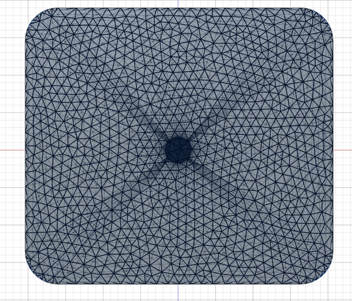

Here's the exact same horn, but this time I've smoothed it with Autodesk Meshmixer. Note that the diffraction slot is barely visible now. This should reduce higher order modes in the horn, and diffraction.
attachment.php

Another "neat" thing I noticed about the Meshmixer "smooth" tool, is that it allows you to use a MUCH larger diffraction slot in ATH.
For instance, with a 3" deep diffraction slot in ATH, you're going to have a dramatic step and a sharp edge in the horn that's produced.
But if you run it through Meshmixer to soften the sharp edges, the step is nearly unnoticeable. And you can increase or decrease the "smoothing" value to change this. The animated GIF above illustrates this.
