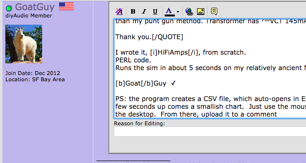

What program are you using for the PS simulations? I would like to perform precise simulations; a 5.56 NATO approach rather than my punt gun method. Transformer has ⁷⁰⁰VCT 145mA plate winding.
Thank you.
I wrote it, HiFiAmps, from scratch.
PERL code.
Runs the sim in about 5 seconds on my relatively ancient Mac.
GoatGuy ✓
PS: the program creates a CSV file, which auto-opens in Excel. From there I just select EDIT-INSERT-CHART and then XY-Chart. In a few seconds up comes a smallish chart. Just use the mouse to resize it. Then ... SHIFT-ALT-4 to sub-screen capture to a JPEG file on the desktop. From there, upload it to a comment, like the fragment of this very screen!
