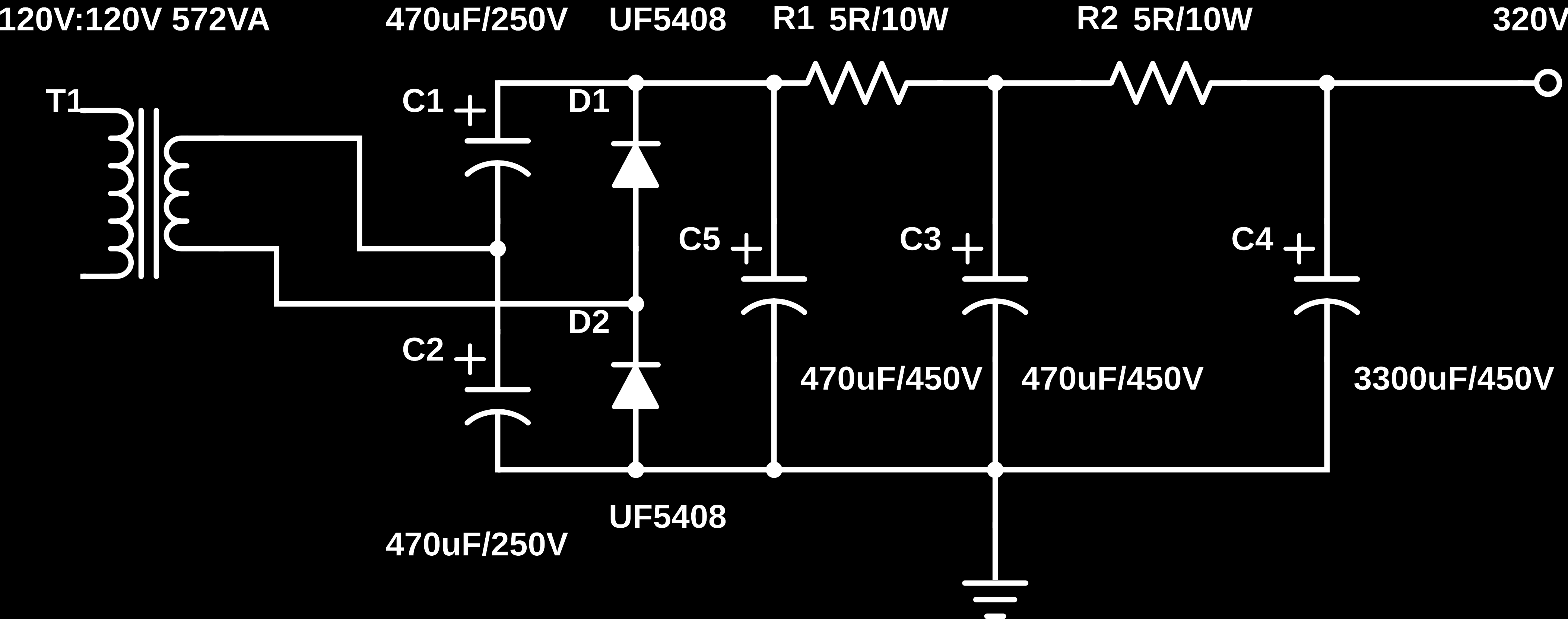

I use 3300uF in my monobloc supply. The amp idles at 500mA, 300V. It peaks about 1.5A. What would you change in my power supply to eliminate the "8 GA shotgun" and still deliver the current?
Hello,
Dont you have two nice surplus? chokes lying around to turn one of the RC into an LC network?
Greetings, Eduard
P.s i do but sending them to Canada would cost a leg
Greetings, Eduard

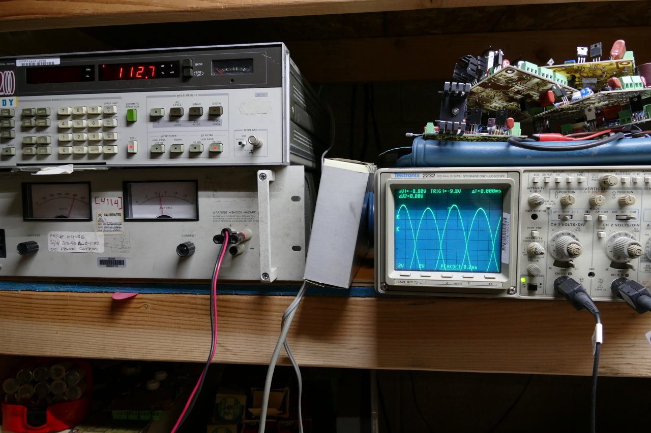

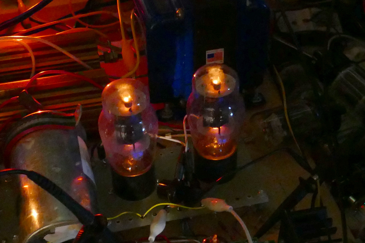

I know from my testing that a pair of 6L6GA's (same guts as an 807) can stuff about 100 watts of continuous sine wave power into a 3300 ohm OPT running well into AB2 before a tube arc spoils the fun. Two different arcs occurred, both in the 110 to 120 watt range, neither were fatal to the tube, but both caused the 1 ohm 2 watt cathode current sense resistor to scatter its guts. Yes, the monster HP power supply was used to feed this. This is a peak current in the 450 to 500 mA range.
The pictures show the scattered resistors, the tubes not glowing at 112 watts output, and the test equipment at the 112.7 watt moment. The scope shows the plate voltages on each tube, the audio analyzer shows 112.7 watts out, and the power supply shows 500 volts and about 700 mA (two channels running,and about 50 mA goes to the driver boards). "Stuff happened" when I turned up the drive a bit more. I changed out the blown resistor and re-ran the test with the same tubes. This time the resistor blew in the other channel.

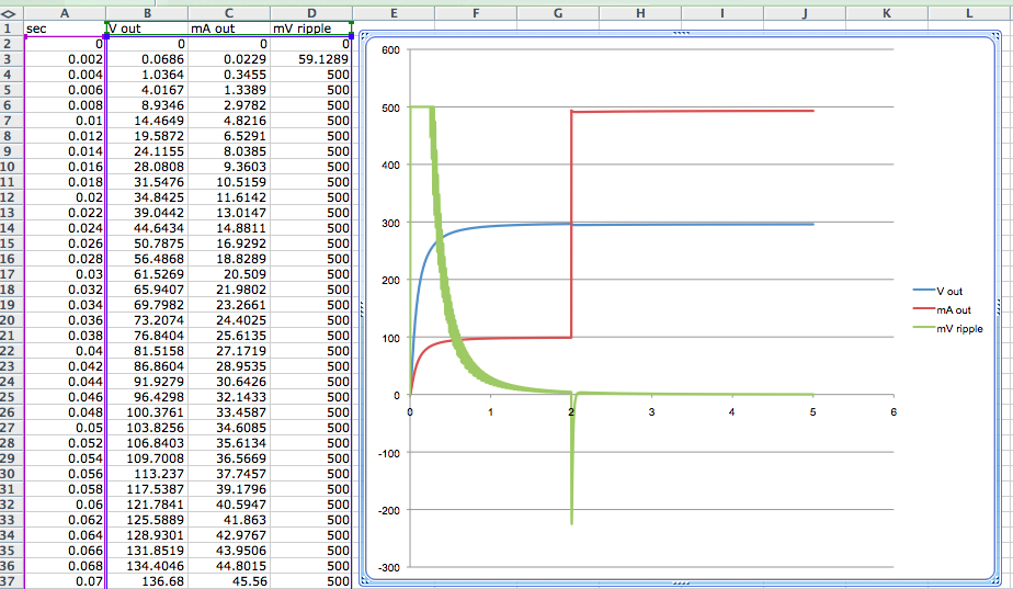

I use 3300 µF in my monobloc supply. The amp idles at 500 mA, 300 V. It peaks about 1.5 A. What would you change in my power supply to eliminate the "8 GA shotgun" and still deliver the current?

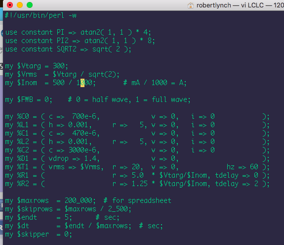

Well … OK.

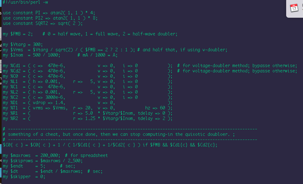

As I understand it, that voltage-doubling rectification is somewhere between non-doubling half-wave and non-doubling full-wave in terms of raw first-capacitor-stack ripple.
I modded my CLCLC algorithm to handle it. Used L values of 0.001 H to sim “no real inductance” effect. Used your 5 Ω resistors. Used C₁ as 235 + 470 = 705 µF. C₂ as 470 µF. C₃ as 3000 µF.
The results are attached. I didn't sim 1500 mA peaks. I suppose I could. Not that hard to do. The sim starts with 100 mA load or so , then jumps to 500 mA. To see LCRC response.
I'll try other values, less 8 gauge shotgun level, yet still satisfying the low droop, low ripple requirement.
GoatGuy

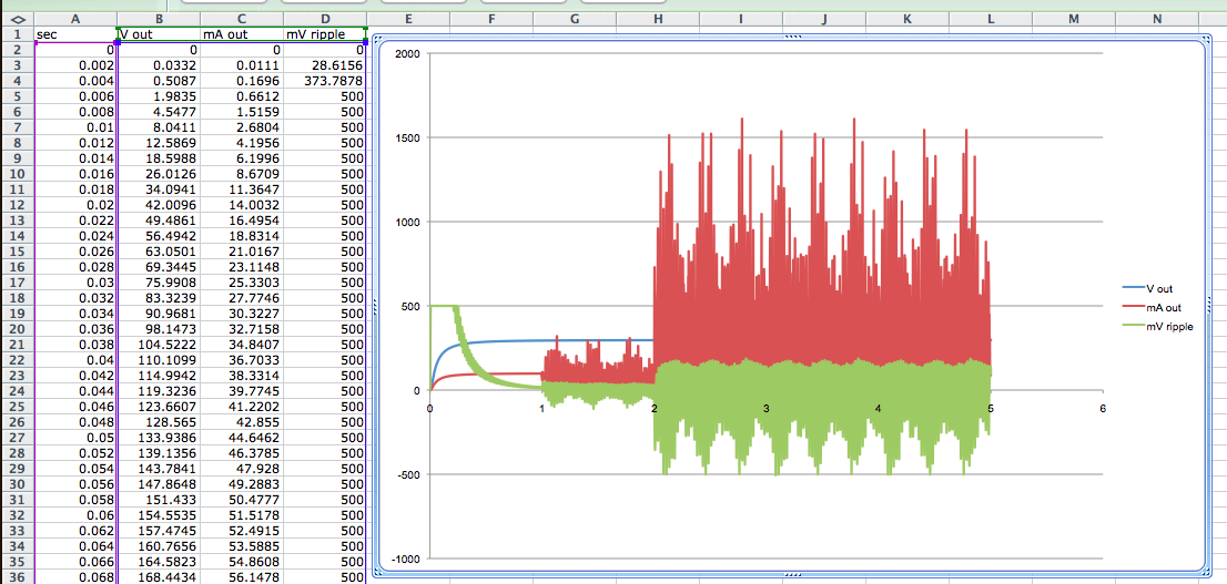

Now … new and improved … with '1500 mA spike loading'.
Created a spikey_load( i_mean, sec_delay ); function to turn on after 1 second, then have a non-harmonic quadruple sine wave load of
2 units of 44 Hz
1 unit of 77 Hz
1 unit of 190 Hz
½ unit of 250 Hz
The sines are raised to the 7th power.
This preserves their sign (even powers result in all-positive, right?) They're added together in the ratios shown. To that is added a ±½ (range) random element too. Just to further “mess up” the load.
Like real music source material.
Again, applied it and herein are the pair of diagrams.
Remarkable how a powerful spikey load influences the “net ripple”.
Just saying,
GoatGuy ✓
PS: do remember that the ripple is in millivolts on the graph, not volts. So, it is still small.

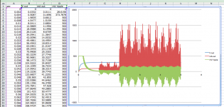

2 units of 44 Hz
1 unit of 77 Hz
1 unit of 190 Hz
½ unit of 250 Hz
Just saying,
GoatGuy ✓

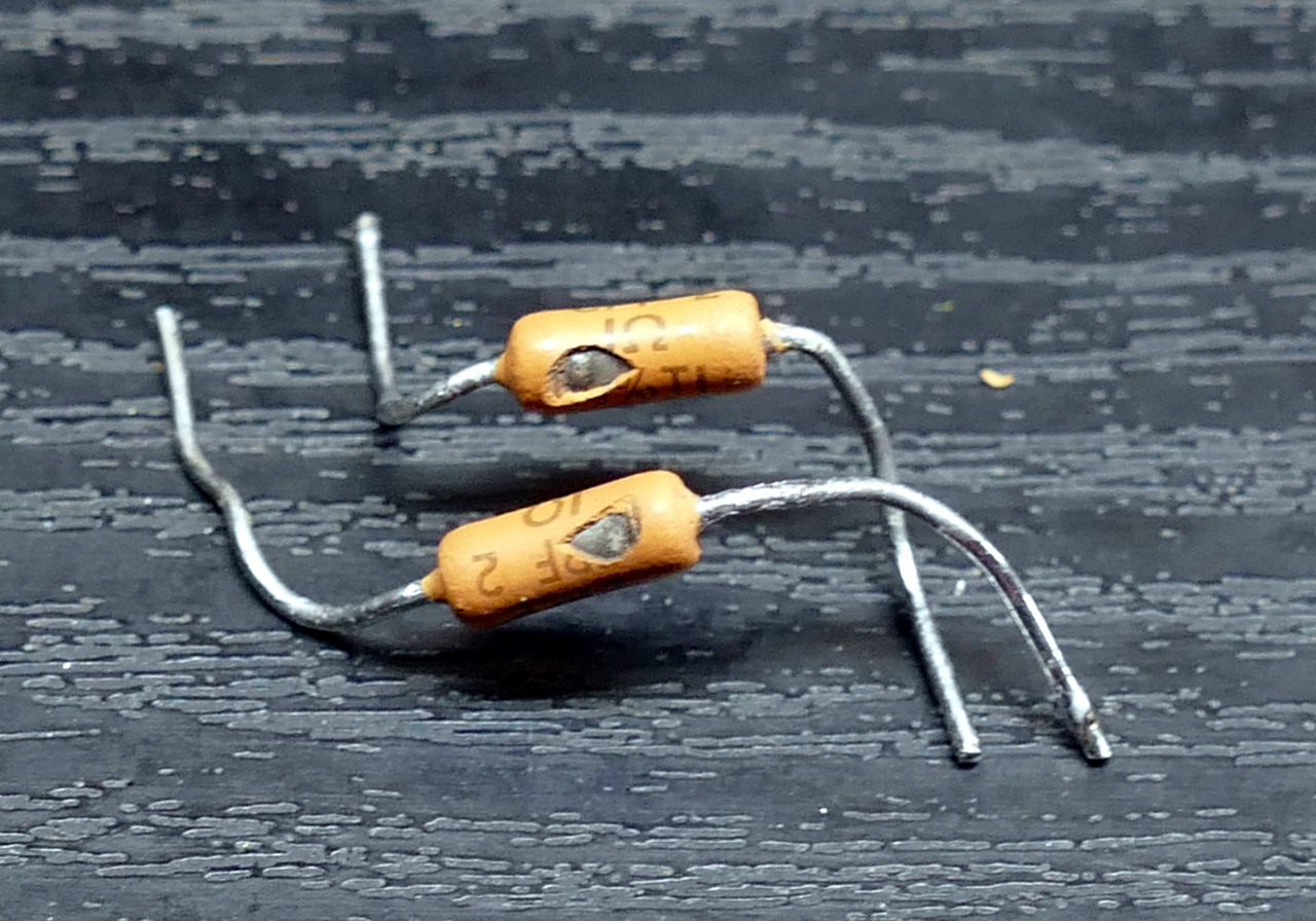

All this talk about exploding things…
Quite some time ago I had a 4 µF cap charged to some 3000 V and I wanted to discharge it, for safety. I had a 22 MΩ resistor and thougt the rating was sufficient, but it went bang and took off a part of my nail. I didn't know resistors had voltage ratings too.
Yes, they do. The real problem with really high value resistors and high voltages is that even when the resistance 'winding' fails, the high voltage tends to happily jump right across the newly-made gap. At first lowering the resistance (loss of material), then further doing so as the arc eats up more and more. Soon, the arc just does and end-run and jumps the shark. Then the resistor isn't much of a resistor any more.
Personally, I have found that strings of the very old fashioned, used-to-be-common carbon composition resistors with 2.2 MΩ values are good. Oh, there are some really cool glass encapsulated hermetic hi-volt resistors with long ceramic forms and sputtered-on spirals of high resistance ceramic stuff … inside a sulfur hexachloride gas atmosphere to suppress arcs … but those are darn expensive. Thirty bucks and up.
Making a chain of 2.2 MΩ resistors at maybe 5¢/ea is the way to go. Just remember to 'shrink seal' the chain in multiple layers of heat-shrink tubing. Like 5 layers. Then you're good to 20 kV or so. (you'll smile… I also include a couple of appropriately trimmed bamboo skewers before the heat-shrink, to make the whole affair quite stiff.
Indeed … Using a couple of 'standard multimeter probes' and piece of RG–59 cable, one can solder 10 of the resistors in a very short chain, tapping the last one as a 10:1 voltage divider, and wrap the whole kit in the stripped-back braid and insulation. Shrink wrap the whole sucker, and you've got quite a safe hi-volt bleeder, as well as decent way to measure its voltage using non-exotic multimeters.
Obviously, choosing other ratios for the final resistor allows for 100:1 or even higher attenuation. Especially for metrology. Using a chain of 10 ea 22 MΩ resistors and one 220 kΩ as the 1000-to-1 voltage divider is how I made my 'high volt metrology probe'. Very safe, too.
Presents 220 MΩ load to the measured-device. Likewise, delivers 220 kΩ impedance signal to the multimeter or oscilloscope. 30 kV becomes 30 volts. Perfect for the (ahem, ah..., err...) now-obsolete high-volt giant-screen CRTs that once graced nearly all homes in America and Europe.
